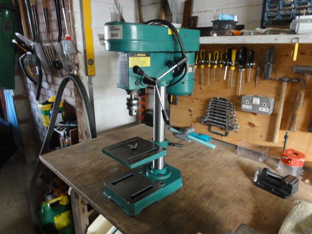

So yes my drill is pretty dire, but it has managed to get by, helped by supporting the table from underneath, as it bends slightly even under the weight of a light vice, the noise has been there from day one, not sure exactly where it is coming from but sounds like the bush that the idle wheel is mounted in. Too be honest I was thinking of stripping and renovating it but there is so much play in the quill I doubt it would be worth doing.
Here's my drill which I've had for 10 years without problems. The screw and locknut outlined in red, adjust the play on the quill. For heavy duty drilling I support the table with a suitable block of wood. For any thing really accurate, I use my small milling machine. So long as one is aware of the shortcomings of any piece of equipment, one can make allowances when using it. Unfortunately I am not rich enough to be able to afford super accurate toolroom machinery.

Well as I got it for free and it has done lots of work I can't complain, but I also can't produce anything with accuracy, easily, or quickly.
I guess that having the mill available has just made drilling so much easier, without doubt, if I didn't have the mill I would still be using 'my old china' for everything and just working around it's limitations, in fact even now if it's just a hole in something and the size of hole aint too big, I use the drill, using a car jack under the table for support also works but it all takes a bit longer. The quill adjustment on mine seems to be best where it is currently set, if I try to adjust any more play out of it it starts to bind and all sorts.
Who knows, if I get the time I might strip it and renovate with new bearings/bushes.

OK I gave in, really surprised on two counts, firstly it all came apart very easily, secondly the bearings are actually very smooth and have lots of life left in them.drill bearing.jpg
And the reason there was so much lateral play was because the keyway pin has been machined wrong, the pin is oblong and won't engage inside the keyway, In the photo below you can see what I mean and just make out the whitness marks about 1 inch below, where it was binding in the key way, the pin will now be hand ground or filed and re-fitted.
Seems like you have all done me a favour as I wouldn't have bothered had it not been for posts, so thank you.

Today I collected my new pillar drill, the subject of this thread. It turned out not to be as bad as the seller made out (although the vice he included is an abomination and is headed for my scrap bin).
After a bit of cleaning adjusting and lubrication it looks better and runs smoothly
It is not a precision machine by any means but I bought it to put an engine turned finish on the baseplate of my Popcorn engine and avoid the risk of spraying abrasive muck all over my mill/drill.
I need to rework the quill locating pin as Ian Skeldon 2 has shown above and it will then do me nicely.
