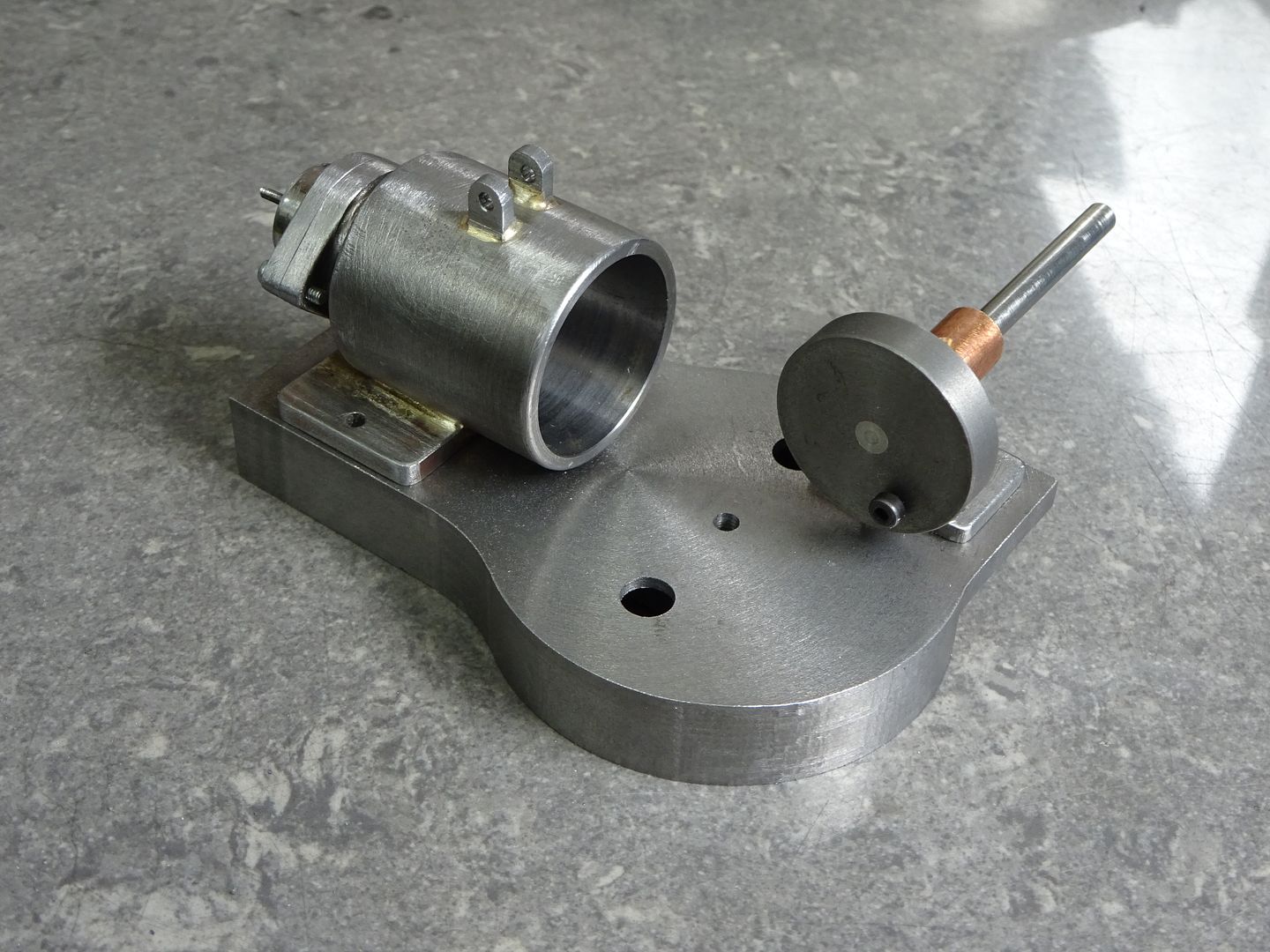

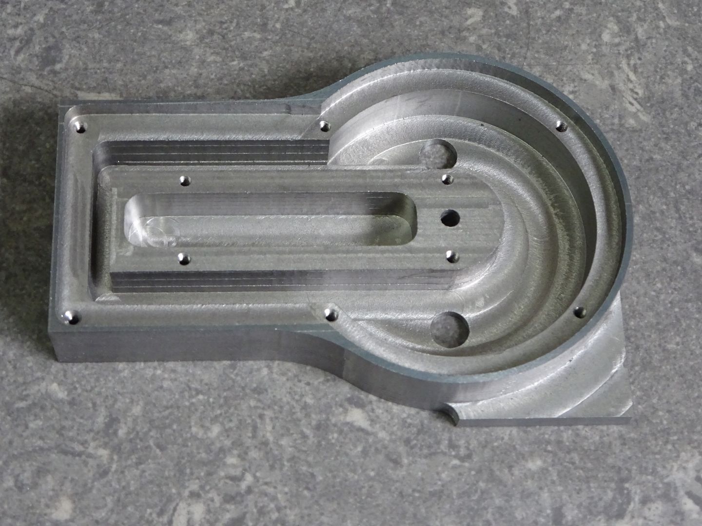

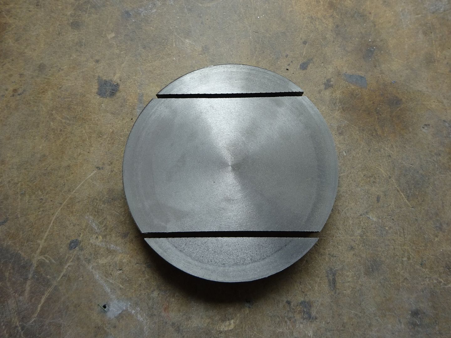

Over the last week I have been doing the odd bit of machining on the Robinson hot air engine's base, started life as a slice off some 100mm dia bar
Then after a twirl or two on the rotary table and much swarf later it looks more the part. I'm quite liking the 150mm Rotary Table that ARC do, the 72:1 ratio makes for less handle turning and the ability to set the ring with 0-360 degree divisions anywhere around the table makes for easier setup, numbers are also easier to read than my Soba one.
And with cylinder and crank/bearing in place
Jim Nic22/06/2018 15:46:41

Arc 150mm rotary table, £389, ouch ! 😳

Mmm, WARCO do a 150mm rotary table for £149 but I'm not experienced enough to make anything other than a 'cost' comparison though the Arc one certainly looks a more expensive job.
