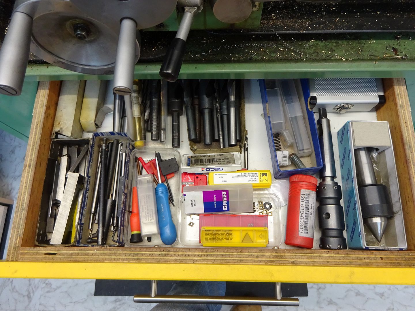

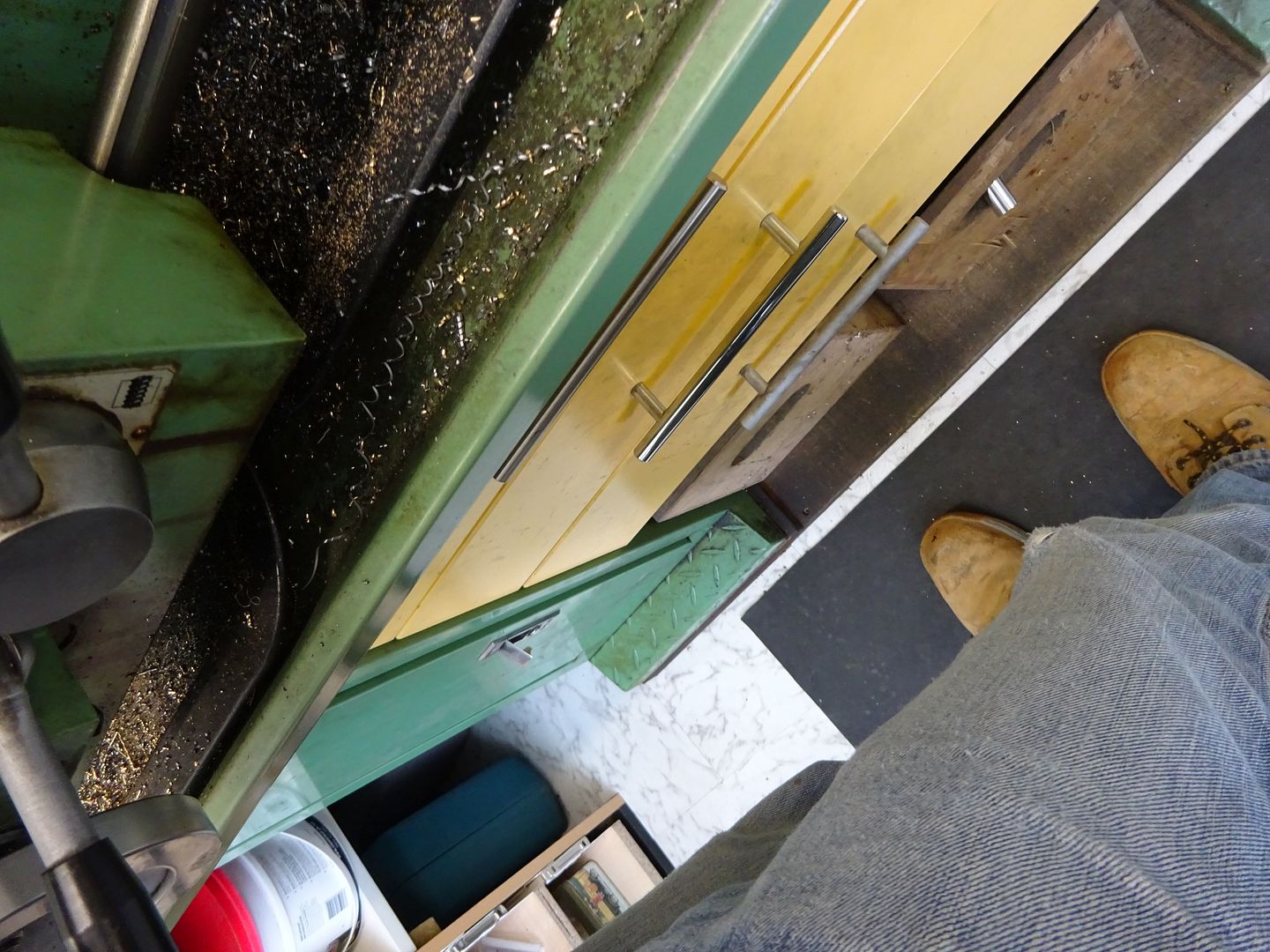

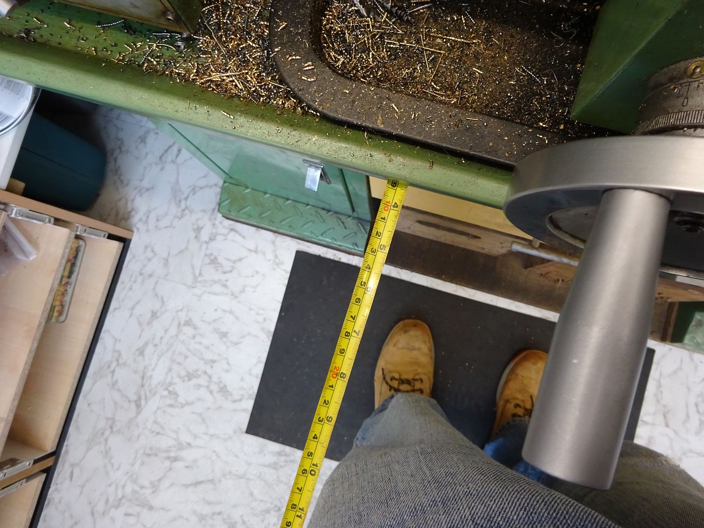

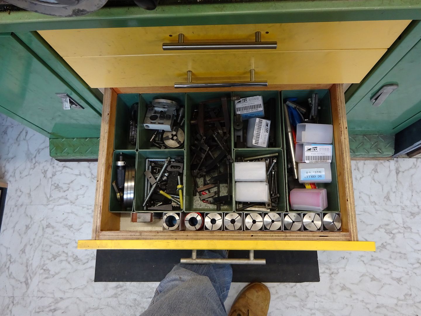

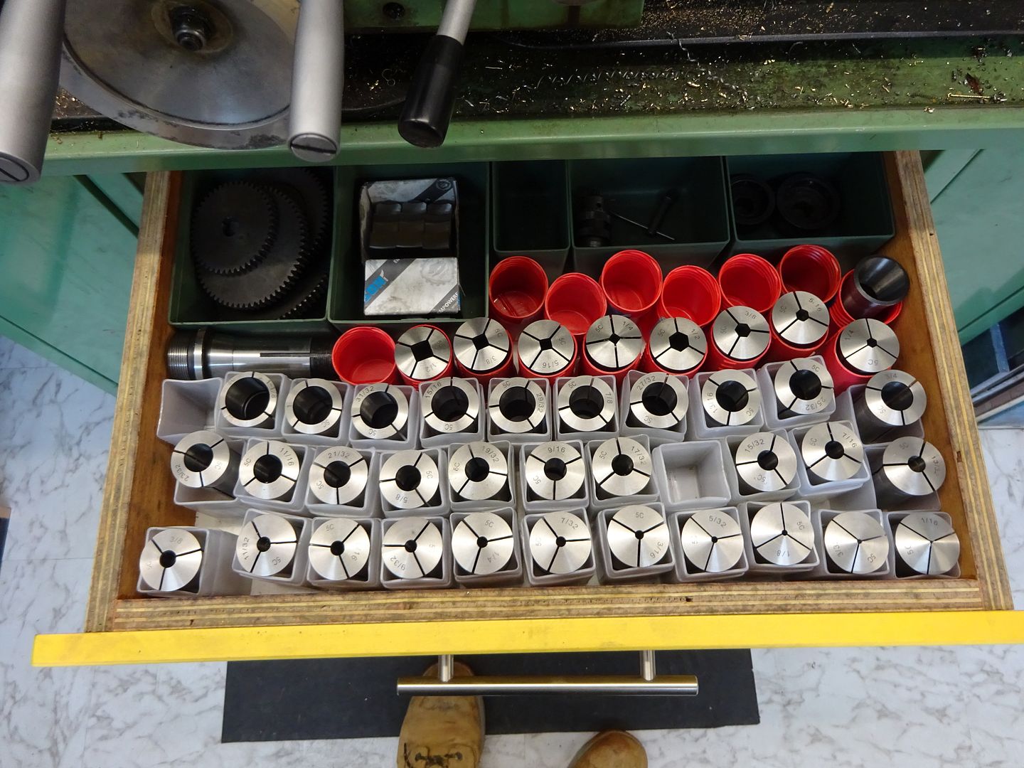

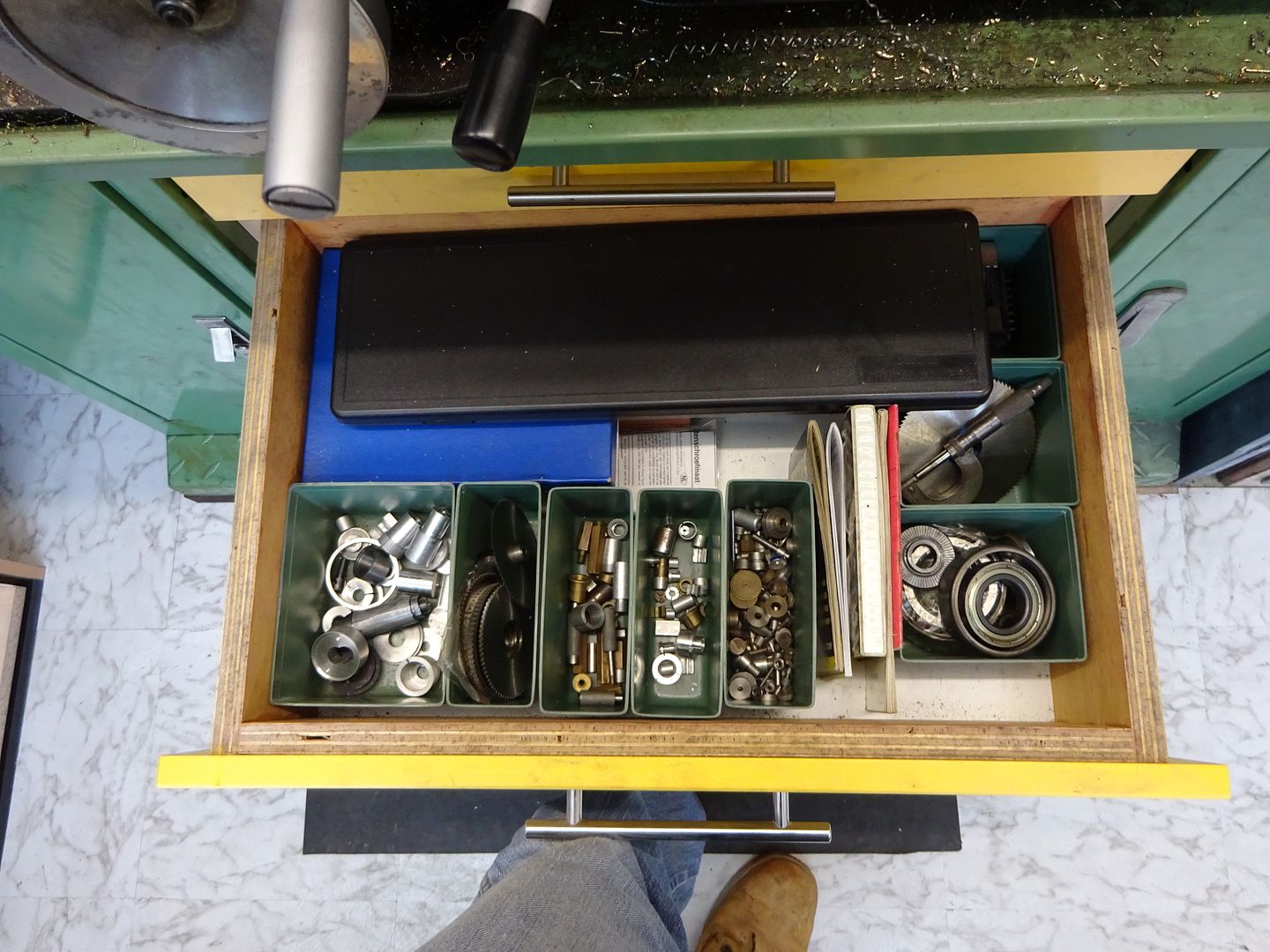

JasonB08/09/2015 16:28:01
avatar
25215 forum posts
3105 photos
1 articles
The basic 5 sides of the carcase is 18mm MFC ( Melamine faced chipboard) not the cheap 15mm contiboard stuff. Draw boxes from 18mm ply biscuit jointed with 6mm MDF bottoms, 18mm MRMDF drawfronts. Runners are easily available full extension ball bearing runners, not sure if I used 30kg or 50Kg ones.
There is plenty of knee room as the tray overhangs the cabinet and then the carrage handwheels overhang that so 8-10" knee room no problem.
I prefer to keep things in draws or cupboards, as the large hit & miss engines have quite a bit of cast iron I don't like picking things up and getting black hands so keep them away from the fine dust.
There is a space below the draws for a couple of ply "scrap" boxes where all the odd come in handy bits go.
Top draw is about 50mm deep and houses small cutting tools, inserts, blacksmith drills, centres etc
Then one that just takes 5C collets plush chuck jaws, change wheels and so on
Then an assortment in the two deeper ones below
J
PS I thought the varnished over yellow road marking spray was a good match to the carrageindecision
