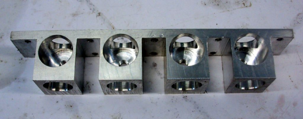

Hi Richard, yes I am still planning on flying a V12 but probably not this exact one as I have already started devolpment on a mk2 version with some fairly major modifications and design alterations, expected power output is about the 10 hp mark with the rev top end somewhere between 12k and 15k, I guess time will be the ultimate judge of these expectations. as for the current project work commitments have limited time but I have been able to progress the project a little bit. Below is an update on the new starter and also the new carb and manifold which I have made as 1 unit eliminating and separate manifold unit.
all thats left for this bit is a bit of cosmetic profiling and they should be ready for some barrels and bits, lol.

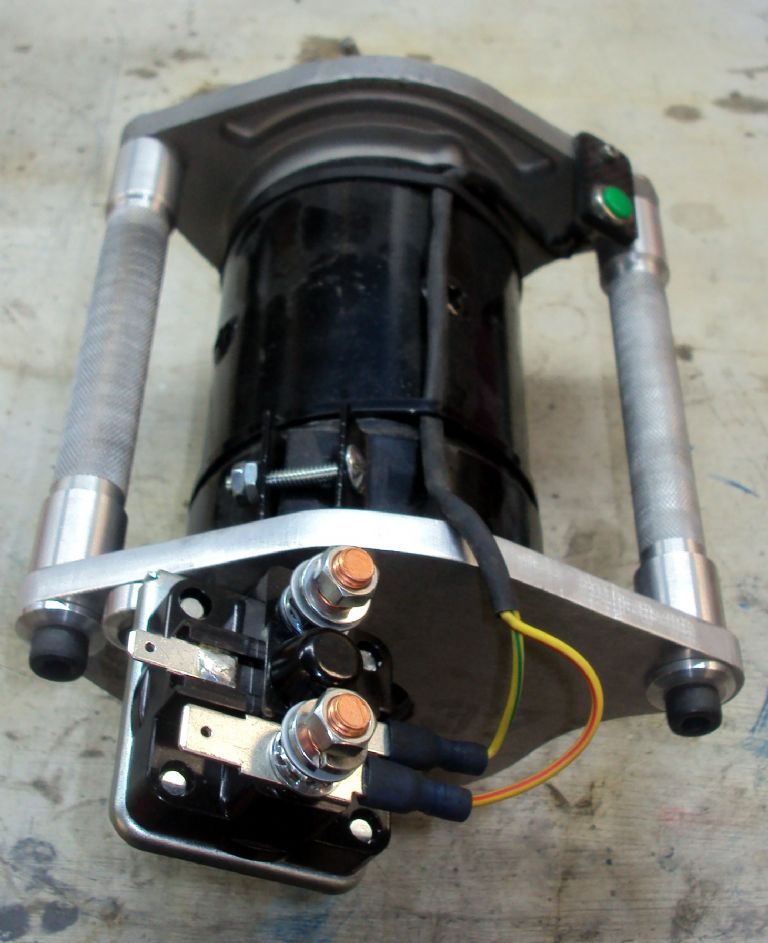

Well at last a bit more to share on this V 12 build project. Sorry for the extended delay in updates but been overly busy with other life demands recently. Here are a few photos showing what I've been up to in recent weeks with this engine build and the related side projects. The anodizing plant is moving ahead slowly and I have finally finished the new starter. photos below show progress to date
Currently working on the remaining parts for the anodizing plant and will post the photos as soon as I can..
here's the finished starter.
So now all I need to do is get the damn anodizing plant all done and put the engine back together and start it up again. YAY getting there slowly.......... but surely thankfully.

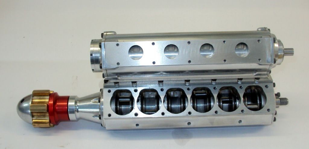

Well after much ado about nothing here I am again with another update, finally! having plucked up the courage to give this anodizing lark a go I found it wasn't actually so hard after all.Not sure why I was so chicken about doing it, just nervous of the unknown probably, oh and the risk of ruining irreplacable parts maybee. Right so now that i have faced my fears the photos below show the progress to date. here's the results of the first test run.
not too bad an effort me thinks......... so onwards we go..... here's the anodizing bath in action doing the first run of the v12 fin blocks and heads.
I had originally set up to do all the parts at the same time but found that the load was way too high for the power supply to cope with requiring more than 15 amps to run and as the power supply is only rated to 15 amps max it just wasn't going to work. The solution was to just downsize the parts stack to both fin blocks and heads as the parts are mated together and had to be the same colour. even then I had to drop the voltage to 10 volts and keep watch on it as the overload would trip out every 10/ 15 mins or so and needed to be reset. this was less than ideal in theory but seems to have worked out ok in practice as the parts came out perfectly barring a small blemish where the colour didn't take up, I suspect because the cleaning stage wasn't good enough. Oh well. photo below shows the first parts run fresh out of the bath.
A very nice even colour and finish so on with the next bits, drive belt housing and cover.
These parts didn't quite go as planned and were a very dissapointing result. It looks like they anodized ok but they didn't appear to take up any colour. These were the only failure of the day and were also the only parts that were sandblasted in finish so I'm not sure if that was the cause or weather it is something else, anyone got any bright intelligent ideas? below is a photo showing all the parts that were done including the test parts, not a bad days effort I reckon but there's still a few questions that need answers.
Cheers for now
Dean
Edited By dean clarke 2 on 25/09/2016 19:19:58

Look good Dean, I was talking to another engine builder at the MEX show last week and he said that he was going to have to sand down some parts that he had blasted as the finish would not take due to lack of an oxide layer.

I've been meaning to comment on the starter. Have you used it yet? I did something similar for my bobcat but couldn't get it to work the load imposed by pushing the starter into the starter dog and the kick when the engine fired and pushed the starter out of the dog caused the engine to stall. maybe not a problem when you've got 12 cylinders. My solution was a sprag clutch bearing in a unit purchased from Hobby King. It’s for starting large scale helicopters.
It made starting so much easier

Hey Pete, how's it going mate? the starter works great in the test setup but haven't got the v12 ready to run yet so can't answer your question, still working on the new carbs. It should be fine though as the lead-out on the dog drive is quite gentle and when the engine fires up I just pull the starter out with it still running so there's no significant loading on the engine at disengagement. will let you know how I get onn when the time comes to bring it back to life.
