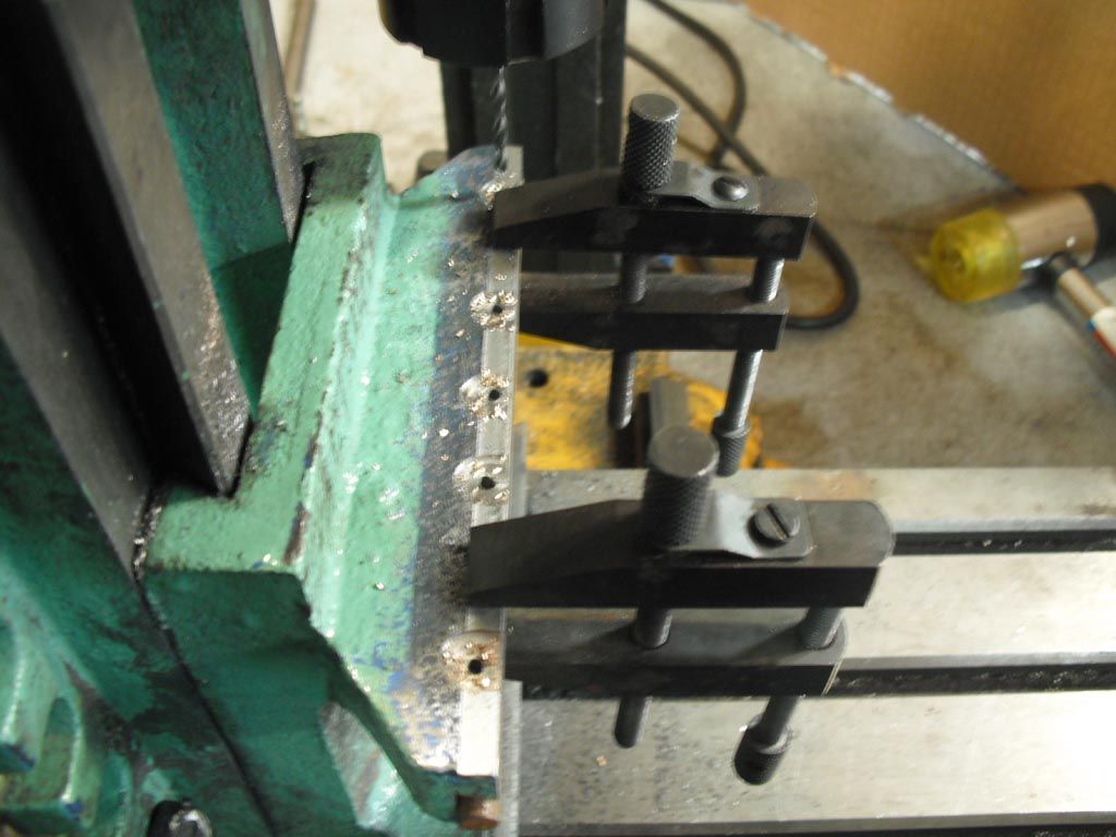

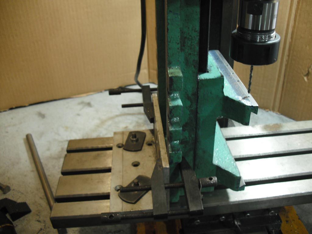

Anthony Knights18/11/2019 08:43:47
681 forum posts
260 photos
Used the set up below to drill the holes for the gib strip adjusters. It was a bit tight and looks a bit precarious, but it's solid enough for drilling.drill gib adjusters.jpg
I then clamped the gib strip in place and drilled through to put the dimples in the gib.spot jib.jpg
I then removed the work piece from the milling machine and tapped the holes by hand. I haven't got any 3mm hex socket head screws so I've had to use pozi head screws as a temporary measure.

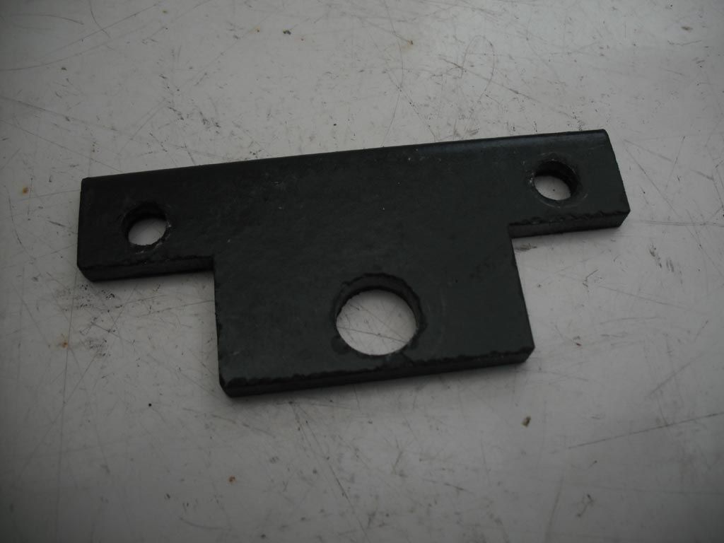

Anthony Knights20/11/2019 03:50:39
681 forum posts
260 photos
It's me again. I must be the only one braving the cold workshop. Made a plate to carry the lead screw.endplate.jpg
