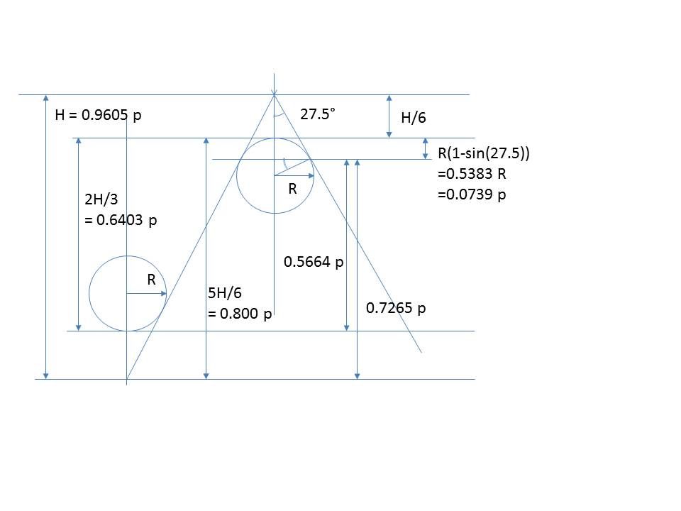

Ok, so checking through my Trig again, the idea of making the major diameter smaller by 0.1478p before single point threading then the crests will be spot-on without needing rounding. This is the same as taking off the U value in Table 21 of BS 84:1956.
For the Myford 1 1/8" x 12TPI this means the diameter will be 1.113" instead of 1.125".
This means the thread depth with a perfect 55 degree point would need to be 0.9605p (full height) - 0.16p (height / 6) - 0.0739p = 0.7266p. Anything less than a perfect point will need less depth so I guess cutting until thread fits should mean the flanks are meshing ok.
Does this make sense?

Jon Gibbs23/05/2014 15:46:52
750 forum posts
Here are my thoughts if it makes it any clearer...
Jon
Jon Gibbs23/05/2014 15:57:26
750 forum posts
Sorry for thinking on-line but taking Ady's original suggestion though, the depth could be cut to a smidge over 0.5664p and then broadened until the thread fits which would be better from a stress point of view wouldn't it?
...but is there a way to do this easily with the top-slide set over at 27 degrees?
Jon
