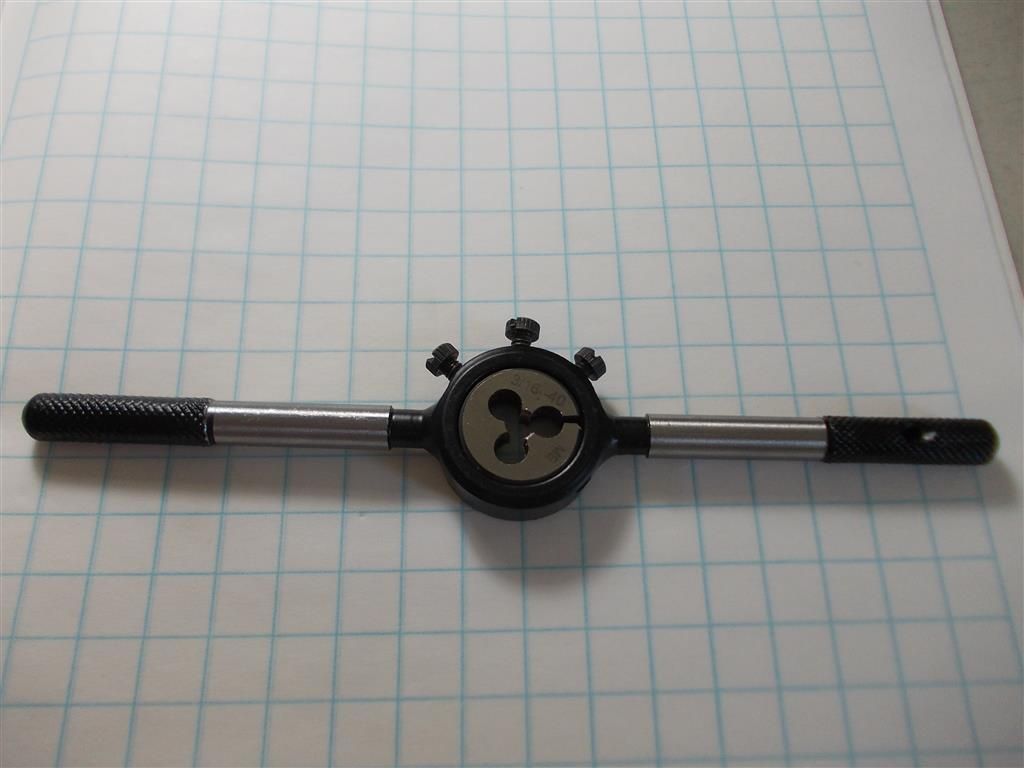

I have posted many questions on taps (quality and how to use them) but I have never asked about dies. I thought they would be simple to use ! I have some 3/16'' copper and brass tubing and I need to put a 3/16-40 thread on them ; they are to be used for live steam plumbing on a stationary steam engine.
I put the tubing in a small vice ; the tubing was wrapped in leather so as not to mark it. But I cannot get the die to cut. I am cutting from the side with the stamp ''3/16-40''. The other problem I am having is keeping the tubing from moving; I do not think the leather provides enough grip. I have ordered a larger vice with horizontal and vertical V notches to better hold the pipe but it has not arrived yet.
The dies are CS and purchased from Tracy Tools. The die holder just arrived today. It was purchased from ebay (''Faithful'' brand). There are some photos here. Have I got it set up correctly ?

Brian,
Try rotating that die so that the middle screw engages the split.
Loosen the two outer screws and tighten the middle one, to spread the die open a little ... Don't over-do this, or you could break the die [it depends how accurately the die and the holder are made] ... then tighten the two outer screws and proceed. ___ If the resulting thread is slightly over-size, loosen the middle screw and re-tighten the outer ones, then go over it again.
It's also worth lubricating the work with Rocol RTD "tapping compound" ... Copper is can sometimes be nasty stuff to thread.

JasonB06/05/2014 07:24:23
avatar
25215 forum posts
3105 photos
1 articles
You also need to have reasonably thick wall tube, something like the KS range brass tube is too thin but the stuff sold by the ME suppliers should be OK if the right gauge.
I don't find copper tube too hard to thread, its more of an issue to tap.
Also worth pointing out that dies have a lead taper much like a taper tap so make sure you use the right side, its usually the one with teh writing on it.

Brian,
This seems a very strong indication that the Die is adjusted much too small [which is quite likely, the way you have it installed] ... either that, or the tube is over-size !
With everything set correctly, I would expect to be able to thread 3/16" 40 tpi comfortably, without the job slipping ...

I have recently had precisely the same problem with a die of the the same make from the same firm.. On examining the die with an eyeglass I could see that no relief behind the teeth had been ground in, and none of the usual fixes would solve the situation. Rather than waste time returning the die, I ground in the relief with a Dremel tool and a conical burr, when the die cut perfectly. I have had dies stamped CS fro Tracy in the past which were not hardened and tempered, and lost their edges immediately. In fairness to Tracy Tools, they never quible and exchange the goods.

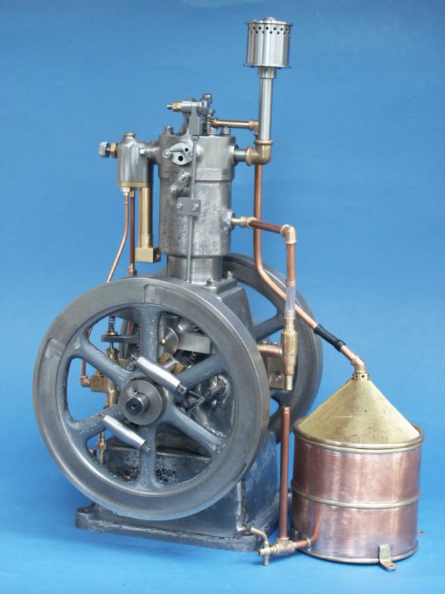

Julian, this is an American engine and they use straight pipe and threaded fittings a great deal both on steam and gas engines where nuts and nipples would be out of place. This is the sort of thing that I made a while ago.

JasonB07/05/2014 18:00:39
avatar
25215 forum posts
3105 photos
1 articles
All the straight bits of brass & copper tube were done with it held in the 3-jaw chuck in the lathe and a tailstock dieholder cut under power at about 50rpm.
The bent ones were threaded after bending and held in a vice with flat aluminium softjaws using a diestock just like yours
In both cases I did not add internal support, just cut the thread.
The run on the left is the fuel return from the constany level carb and is 1/8" dia, threaded 5BA. The middle one is the fuel feed and brass fuel pump which is 3/32" dia and threaded 7BA. The ones in the background comming from the cylinder jacket to the brass water pump are the cooling pipes and they are 3/16" dai, threaded 3/16x40ME. Exhaust thats in teh photo below is 5/16" steel threaded 5/16x40ME
As for what it is, its a 1/5th scale model of a IHC (International Harvester Co) vetrical screen cooled hit & miss engine. This is it all together with teh cooling screen & tank and a video of it running minus tank.
J
