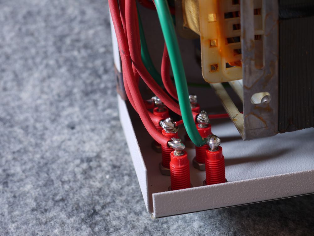

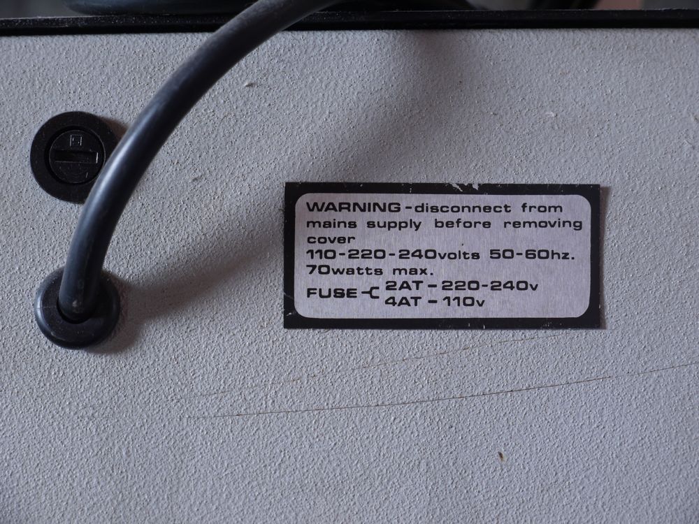

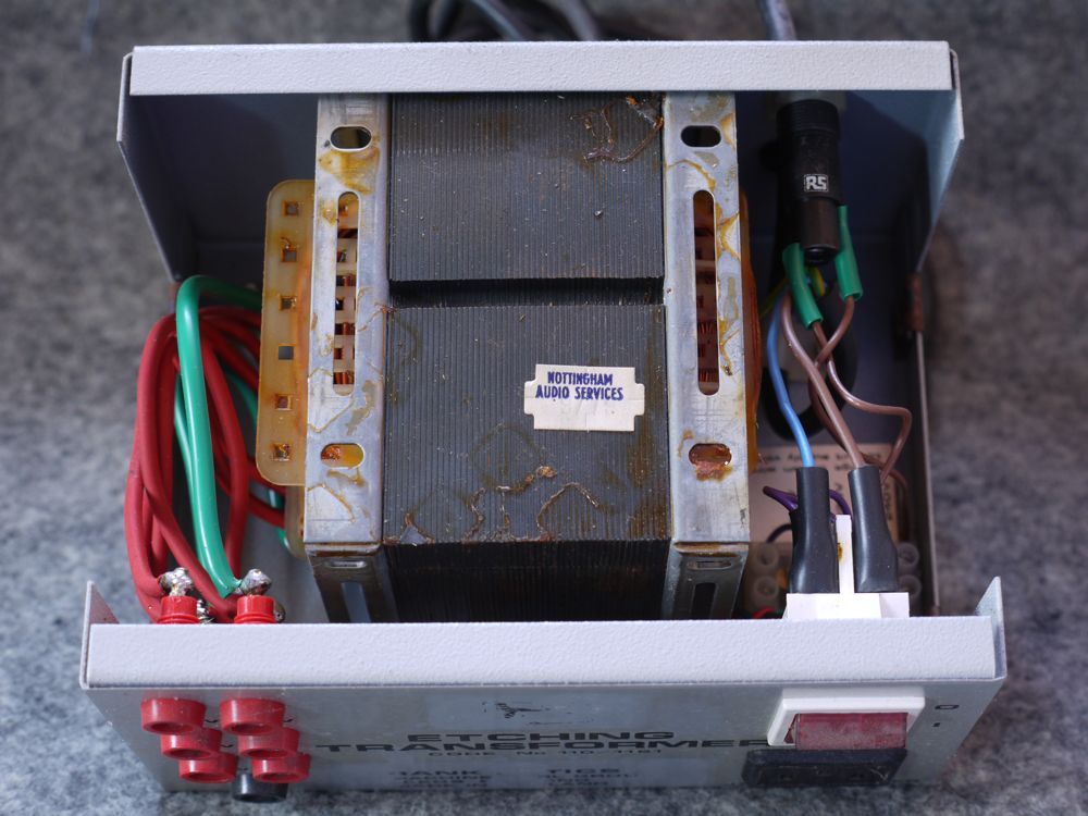

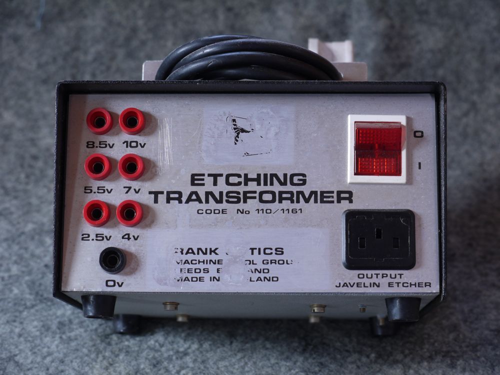

Michael Gilligan08/04/2014 20:36:04
avatar
23121 forum posts
1360 photos
As promised ...
Here are photos of mine, which is branded "Rank Optics"
[ One of the later owners of "Taylor Hobson" ]
It has Serial No. RWS0002 on an adhesive label
but I don't know if that's the Manufacturer's or the Owner's.
Note that the thin red wire takes 5.5 Volts to the 3-pin outlet.

One of those would be a good boot-sale find. That transformer would make the basis of a decent high-amp bench supply, especially driving something like a 12V milling attachment..
