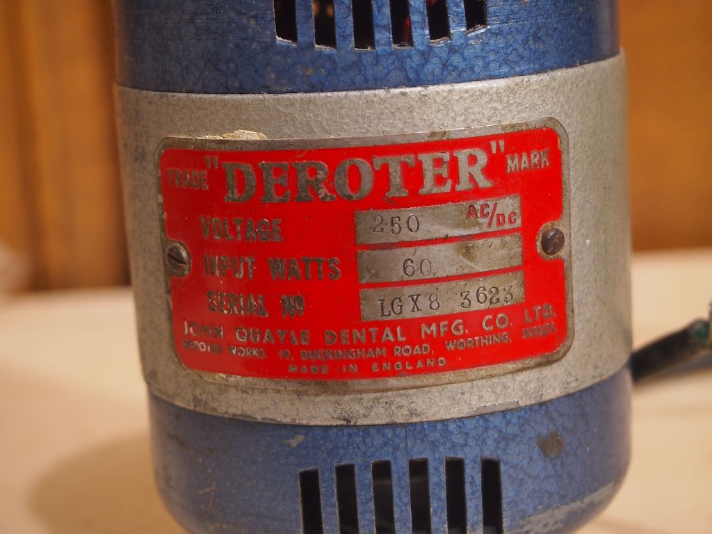

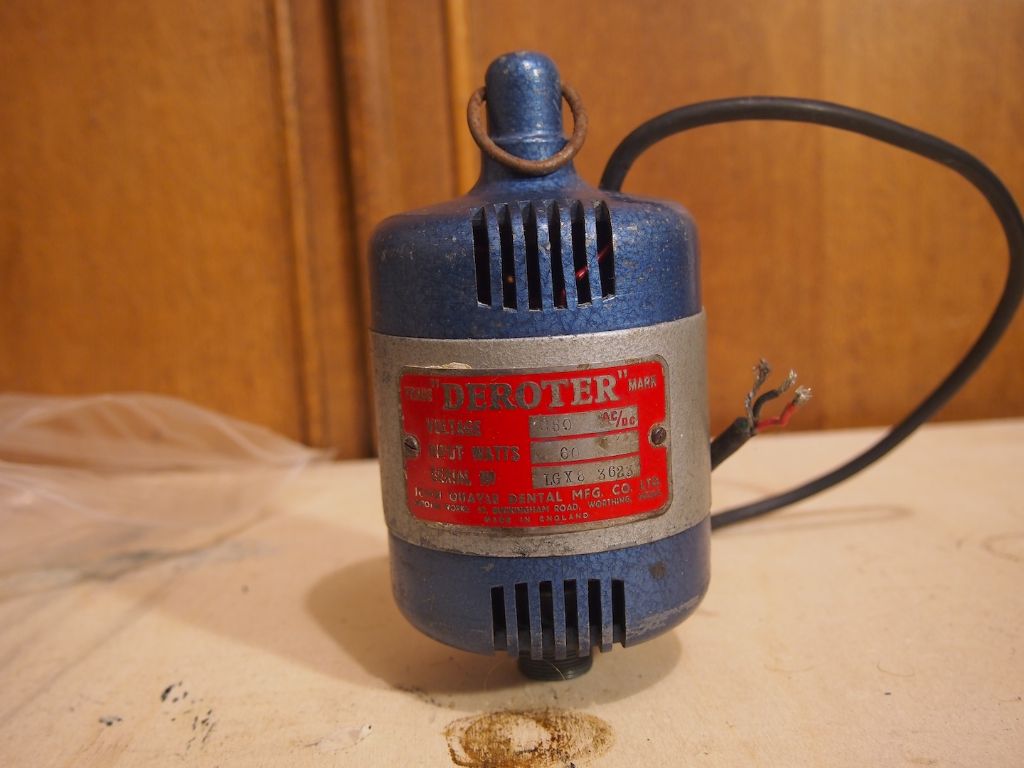

Does anyone have any knowledge of "Run" Capacitors for single phase motors?

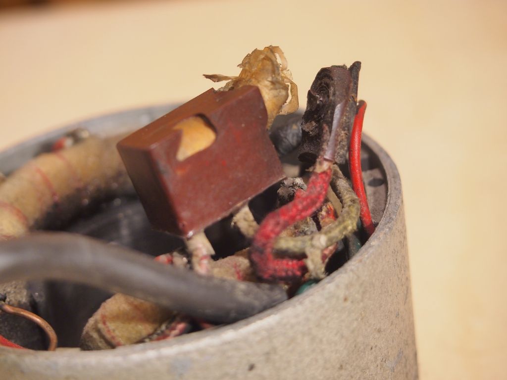

I have a little pendant drill motor that upon dismantling i discovered the capacitor inside had exploded; there was no clue to the 'value' of capacitor, at least none that was left on the remaining casing. I emailed the original manufacturer to see if they may have information in their archives (long shot as i imagine it's 30+ years old), that turned up nothing.
It is some kind of film capacitor, but unusually has 3 terminals, and I assume the motor is a PSC type motor, it has a footswitch for speed control.
Could anyone hazard a guess to what capacitor to replace it with? I don't want to damage the windings by fitting the wrong capacitor. The motor is labeled 'Deroter' and is 60 watts.

If this motor has a commutator then I think the capacitor is there for spark suppression. It is probably two caps, one connection to each brush and a common earth wire.
Dave Daniels30/03/2014 08:44:19
87 forum posts
Just a Delta Capacitor probably. 3 caps.
This is the sort of thing you need but it's too large to fit in. Bottom of page.

I f the motor has a commutator and is fitted with carbon brushes then the capacitors, as others have said, are for interference suppression and the motor should run with out them, for test perposes only !. The capacitors should be X type as the adverts says.Ted

It's a RFI suppression capacitor. Yes they do explode, When I was about 7 or 8 years old, I was tucked up in bed in my room next to the living room where mum was sewing, when there was an almighty BANG, I got up and went to see what had happened, and there was mum, still sitting in front of her Singer sewing machine, in the midst of a cloud of smoke. An hour or so later dad (a radio technician), and he declared it ok for normal use, and it was used for another 30 years, until traded in on a new machine. No RFI noted in all those years, plenty from other bits of machinery around the house. Ian S C

Ah, thanks everyone! It does have a commutator so that does seem like the correct type of capacitor. I'll buy that one that Dave Daniels linked to... It's typical, I placed an order with Farnell just yesterday, I'll have to see if they can add it to that order before they despatch it (it's £20 minimum order on card payments).
