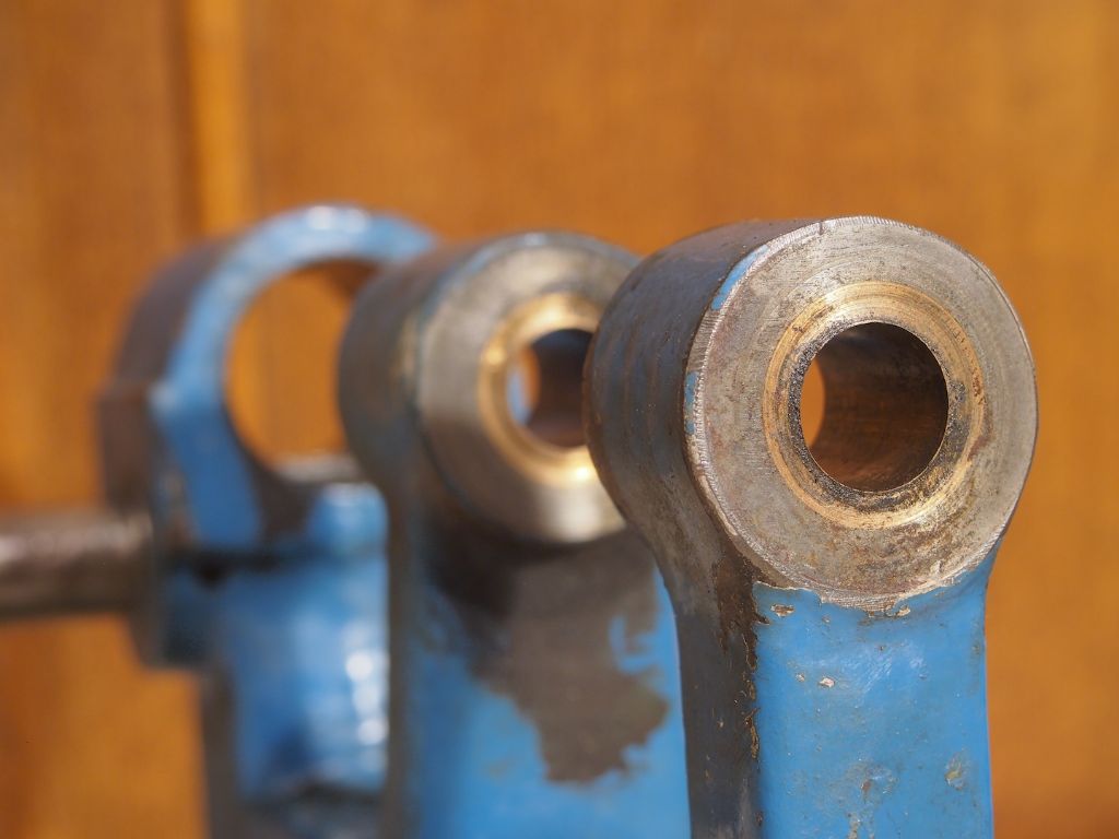

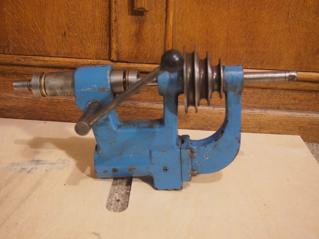

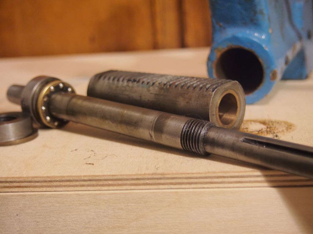

Thread: Engineer for Headstock Overhaul - Pillar Drill/Tapper
29/03/2014 20:15:54
Hi,
I've just recently bought an old pillar drill which has excessive spindle play, i would like to use it for drilling and tapping small diameter holes, so obviously play needs to be at a minimum.
The bearings (bronze) in the headstock are worn, and the spindle looks to have slightly eccentric wear in one spot (contact point of upper quill bearing), the wear on the rest of the spindle seems minimal. I don't currently have access to the tools required to machine and replace the bushes in the headstock and make the spindle true.
Also, I would like to fit a V-belt pulley instead of the round belt one fitted at the moment.
I was wondering if anyone knew someone that (or they themselves) would take this kind of job on at a good price?
I've attached some images:
for size reference, total length of spindle is around 30cm
