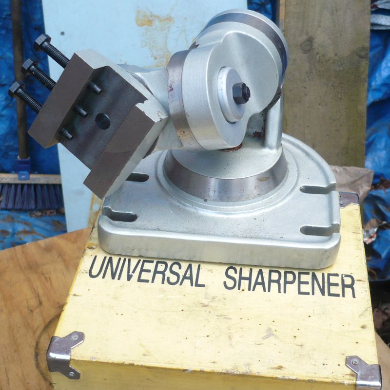

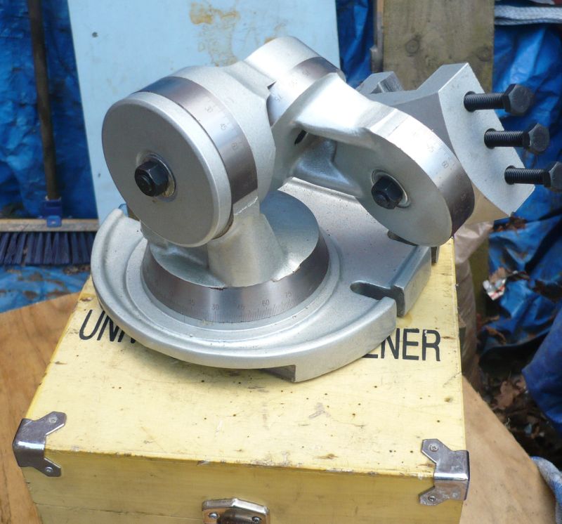

John Stevenson16/03/2014 13:15:03
avatar
5068 forum posts
3 photos
Posted by Neil Wyatt on 15/03/2014 21:47:32:
Hi Adam,
I've never come across a commercial lathe tool sharpening equivalent of a twist drill sharpening jig.
Not really your weekend is it Neil ? wink
Search for "Universal Sharpener "
Adam Harris17/03/2014 10:46:07
533 forum posts
26 photos
Thanks John, that is exactly what I want, looks absolutely perfect - now searching for it on Google but to no effect! Will keep looking. Maybe the DIY Kennett jig would be good if I could find one of those too.

Hi John how would you actually use this tool holder - have it moveable or have the grinder moveable?
Bazyle17/03/2014 13:03:32
avatar
6956 forum posts
229 photos
Pootled around and found this. which includes a welded version of the nice castings in JS picture.
It looks like a rather versatile casting as you can make versions with 1 to 3 axes. It would be great if one of the regular ME castings suppliers would make the casting available then Neil could run a whole series of things to do with it. Heck it might even get me to subscribe to the other mag.
Found this USA ebay ad for one at $99 so double the price and add £20 shipping for the UK and suddenly it becomes not so good.

Adam Harris17/03/2014 16:45:10
533 forum posts
26 photos
Hi Bazyle, you are much better at searching the web than I am! That "Shars Universal Vice Mill" looks exactly the job I would have preferred however I have already this morning paid £51 + £9 shipping for the less beautiful one on ebay UK called AMA-WEA 50mm. The Shars would cost £84 to import excluding VAT which would be charged at customs entry I assume, and although it looks better would need the degree calibrations put on manually to all 3 swivels, whereas the AMA-WEA at least already has the markings on the base swivel and possibly also on the tilt swivels. I plan to dismantle, true up if necessary, and use my dividing head to scribe in the degree markings to the tilt swivels if necessary. I will post better pics when it arrives if you are interested. Adam
