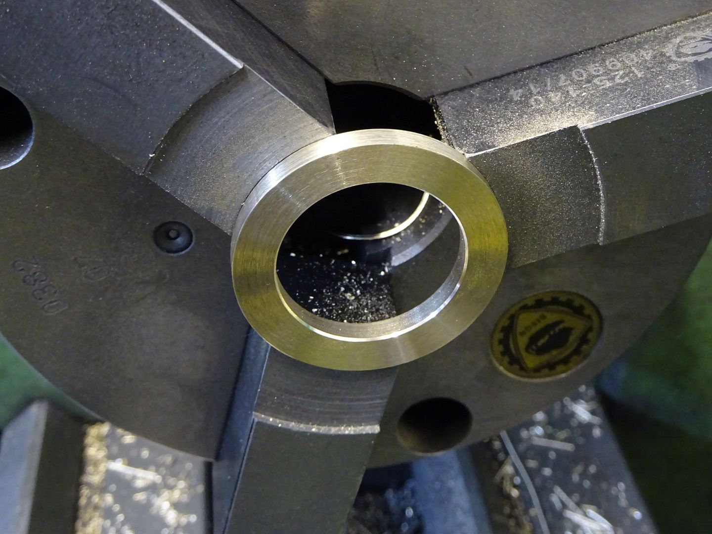

I have a Myford Super 7 lathe and want to make a bush with a flange at one end from some 40mm round bar, and so hold this in a chuck and cut a 28mm hole through the centre with a boring bar.
The problem is, I want to pass the boring bar completely through the piece of bar but the centre hole of my 4" chuck is just 25mm
So does anyone know of a 4" or 5" chuck for the Super 7 which has a larger centre hole, as I have searched for another chuck but for some reason the manufacturers seem shy of providing the diameter of the centre hole?
I realise I could also hold the bar with a clamp on a faceplate (can't think of its name)  but I want to do a number of procedures on this bush.

JasonB22/01/2020 13:03:59
avatar
25215 forum posts
3105 photos
1 articles
Just pack the work off the chuck face as you tighten and then remove the packing. Or if you have soft jaws use those, both methods will leave the work clear of the chuck face.

I did not suggest external jaws as the difference in the steps diameters is likely to be more then the 6mm wall thickness of the part so you would need to pack it away from the jaw anyway.

I have got a 4j but want to avoid the problem of rechecking this part which I’m sure it will need
I suppose I could do the boring with the 4j and the turning with the 3j but it won’t be as quick as using a 3j with more capacity only

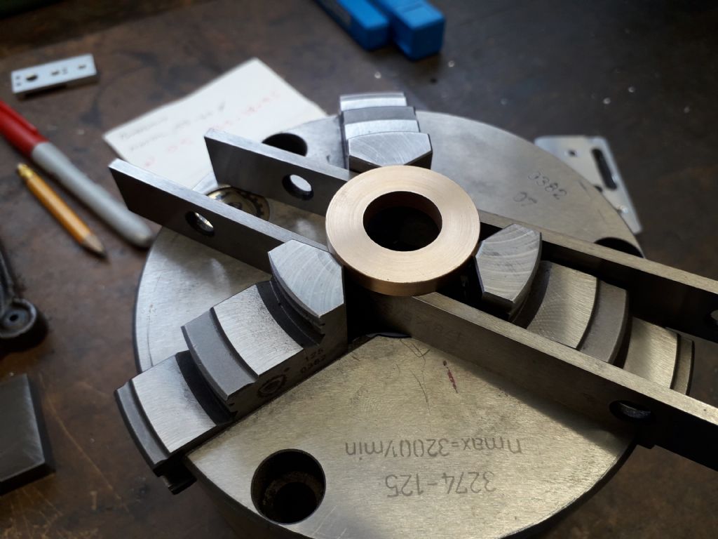

Harry Wilkes22/01/2020 14:28:34
avatar
1613 forum posts
72 photos
I like others have often used the method suggested by Jason but I have also made a spider for my chuck which I find very useful
