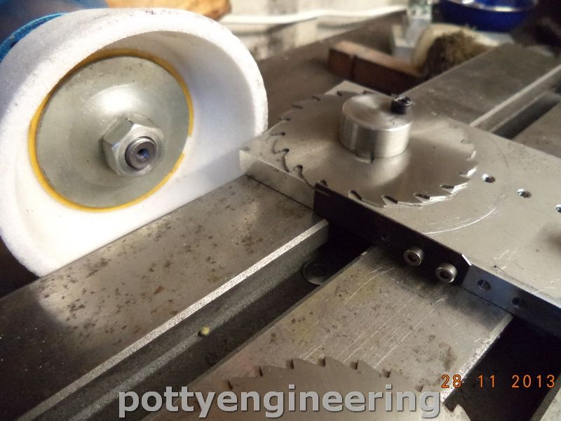

The fertiliser for this came from a number of sources:- John Stevenson's cross vice use, and Harold Hall's book: tool and cutter sharpening from the workshop practice series.
Its basically a compilation of commercially available parts, that consist of:-
Myford vertical slide.
Bench Grinder
Mill Table
Stevenson's ER32 index blocks
The parts are all bolted down on a thick chunk of ally plate, The grinders motor wiring was rerouted to allow is to be mounted direct to the vertical slide. The mill table is one supplied by axminster that I bought second hand, but there are other types available from other suppliers that could be used just as well. The grinding fixtures from Harold Halls book can easily used with this set up, the mill table makes their use a lot easier and more positive.

Looks good and solid Stew, the long travel should allow it to be used for basic surface grinding, if not with micron accuracy enough to get that nice finish and things good and square.
I used a clarke grinder just like that as the spindle for my 'Trent' grinder. It is very smooth and runs very truly - I was able to turn a collar for the diamond wheel in situ using the centres in the grinder spindle and got an excellent result. My worry is that it heats up quite quickly.

This is very much a work in progress I've stripped it down to do some modifications:- secure the wiring: fit a guard for the cup wheel : fit a y stop: and fit some dust covers and felt oilers to the ways.
The Axminster x-y table is a little on the big side a smaller table would be more in keeping but it came my way at the right price.
As Neal said it has possibilities for other applications, that's something I plan to explore in the future that and other a cutter grinder uses.

I don't think it's developed enough for an article yet Danny, I keep seeing things that can be improved.
I'm going to add a riser block under the myford swivel slide this will speed up the set up time and allow the wheel to be tilted this will open up other possibilities.
I'd like to add a Y stop but I'm struggling to see the best way this could be done, still having a good think on that one frown.
