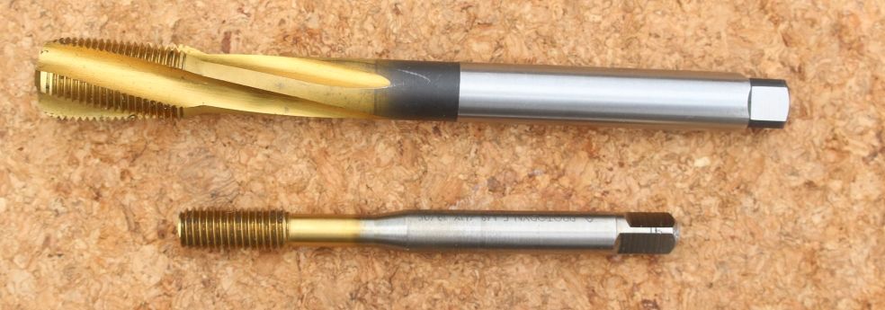

I picked up a job lot of very smashing looking taps a while back from my normal Sunday morning supplier.
Bear in mind I have been out of the engineering industry for many years now so anything new and strange looking is somewhat of a head scratcher for me.

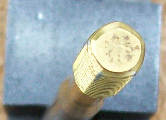

The larger 15mm tap looks to me like a posh but all purpose coated HSS job. The smaller 8mm one however is weird as it has no flutes. I have pictured the tip separately which shows that the cross section is vaguely five sided.
What do I use one of these for then?

The lobed tap is likely a roll-forming tap, particularly common for use on thin material.
They work rather like ploughing a field (though not actually cutting) - tansferring material ploughed up from the furrow to form the crest of the adjacent thread.
Note that tapping drill size will not be the same as for a conventional cutting tap, but rather larger than that.

Roll taps are very useful on copper sheet material (which is very abrasive to cutting taps) and is good on any thinnish malleable metal as it compresses the thread theoretically making it stronger by deforming the grain structure rather than slicing it. They are considerably stronger too. Colin

Definitely a roll form tap. For use on ductile materials, like aluminium and stainless steel, less useful for things like cast iron. Roll form taps are often used for blind holes, as there is no swarf produced. It is important to countersink the hole a bit deeper than normal, as the first thread tends to get extruded upwards.
As David mentions a larger starting hole than normal is required. An accurately sized hole is also needed, as a small variation in size has a disproportionate effect on thread height. A tiny bit too small and the extruded material won't have anywhere to go; equals a broken tap. Some roll form taps have straight 'flutes' to allow penetration of lubricant.
For production you can buy machine screws with a similar lobal form; they form a thread as they are inserted, thus saving on the tapping operation.

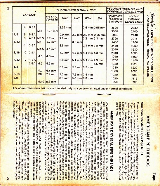

I still can't transfer photos from my album, but I'v put a chart of recomended drill sizes for Sutton Threadflo taps, and recomended threading speeds, "you got to be kidding" 4BA 3500rpm for al cu soft brass, 2730 for die castings, and leaded steel, I did mine by hand. Ian S C

Try another computor, here is the tapping chart for Threadflo taps. Ian S Cdrill sizes for threadflow taps (548x640).jpg

Sorry if I wasn't clear - I did find your table in your photo album. I see you have now been able to transfer the photo to this thread, something I have yet to attempt.
I did, however, produce a thread in softish aluminium without difficulty. As it happens, my Roltap brand tool turned out to be marked with a tap drill size - 7.4mm - and I actually used 7.35 which was my nearest drill and fell neatly between the high and low range figures. Under a lens the thread appeared to be not quite fully formed.
