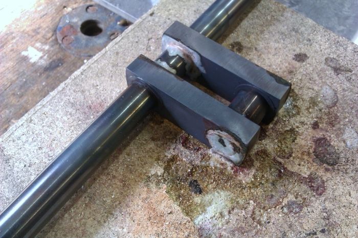

I have been trying to do some silver soldering and can''t get to the solder to melt. The photo shows the part about 30 seconds after I gave up assuming the flux would have stopped working so I assume I got it hot enough, it was a bright orange colour. For seceral minutes, when I touched the silver solder on the metal it just woul not melt, but the heat coming off it was warming my fingers.
The silver solder was 455 with flux supplied by CuP as a starter kit. The torch is a Sievert 2491 and the material is mild steel 5/8" diameter.
Can anyone tell me what I am doing wrong?
I have read advice on here and CuP''s site and thought I had followed it.....

certainly way too hot you want just a dull glow. Flux has totally gone.
Did you mix the flux with water?
Try cleaning it all up, reflux and place a small bit of solder on teh joint which will melt an dflow into the joint as the right temp is reached.
J

The flux was mixed with a drop of washing up liquid and water. I did try the silver solder on the item at lower temperatures but it each time I put the rod on (1mm) it did not melt. I was expecting the rod to melt, and if the flux had gone it just to sit there and not flow. I did try this twice...
If I put a piece of solder on the 2 joints in this case I am not sure how to heat the part up without directly melting the solder with the torch, rather than having the joint melt the solder.

Everything needs to be really clean before you start, then following Jason's line, make sure you are letting the heat flow to the joint, don't apply direct heat to the flux and solder. Mixing the flux with water ensures you get the flux right where you want it and no where else, so you get good control of where the solder is flowing.
If was looking to solder two strips of metal to form a "X" shape, I'd be putting the direct heat on one of the legs away from the centre of the X and letting the heat flow into the joint. Just a bit of patience and practice, that all.

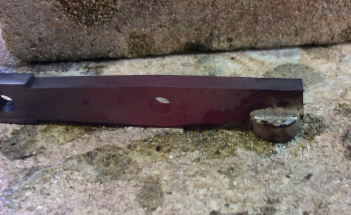

In a case like that its hard to avoid the usual advice not to heat the solder so just aim the heat at the largest piece of metal.
This part is a bit smaller at 1/8"x 3/8" section but the photo was taken 15-20 secs after the solder flowed and you can see its not as hot as yours.
And this one gives a good idea of how the flux should keep the joint area clean, this is 5/8" dia bar

The alloy should have melted looking at the pictures - but may not have flowed.
Two totally different problems!
One part looks very hot , one is not.
You may need to use a different flux or modify your heating technique.

Keith, I will probably not be able to call until Friday. The cooler part is the second joint, towards the top of the picture the two parts (rod at 90 degrees) are both at the same temperature. I guess part of my problem was that in an effort to avoid taking to long to heat the parts thus use the flux I heated up to much and used the flux that way instead.

Yes you need some around the outside, look at the second picture I posted above, the grey areas are where the flux was, the black where it did not cover.
A drop of Washingup liquid does no harm and is quite common practice. Best not to heat the rod and dip in flux, you should have the flux on the job not the rod.
