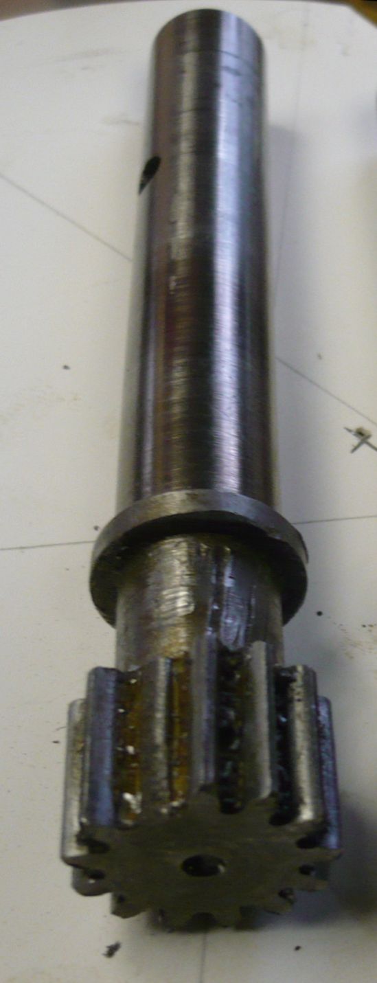

Treatment has really bit me in the arse today! Sometching I've been expecting for some time.
Had to reduce the diameter of a length of M10 studding to 9mm, so saddle in slow auto-feed as I had the whole length in the chuck, so sticking out the end of the spindle.
Having in the past tried to turn a long length of rod at too high a speed, with the end soon flailing about, I soon learned my lesson.
Only a short length out the back of the spindle this time, so no problem.
Except . . .
I forgot about the wood under the chuck that was resting on the bed!
CRUNCH!
WTF thinks I, lathe still doing its job on autofeed of course!
Then I notice the wood, so quickly disengage autofeed, stop the lathe, tumbler into neutral, tried to move the saddle away from the chuck, but cannot get the hand wheel to move, it's stuck.
Motor reverse selected, tumbler engaged, switch on, select auto feed on the saddle and with my help onthe hand wheel I manage to get the saddle moving towards the Tailstock.
With everything disengaged, machine off, the saddle handwheel eventually started to free up and move the saddle, but with free and tight spots, and with areas of no play to lots more on the handwheel dial.
Advise please as to what damage, if any, I have or could have done?

The saddle is moved by a small gear on a shaft (Grizzly part No 336) which engages with the rack on the undrside of the bed lip. It is geared to boththe feed shaft and the handwheel. During the jam-up the gear pushed away from the rack and bent the shaft slightly. So now it goes in and out of good meshing distance. The tight spots will be about every couple of inches along the rack ie per turn of the small gear not at the same point on the handwheel revolution owing to the extra gears in between.
Seen a few reports of this usually due to running into a saddle stop.
Hint for other users. Saddle stops are NOT meant to be used on auto feed though you can get away with it on Boxfords and Colchesters with a built in feed friction clutch.

Yup bent pinion shaft.
If it's any consolation did the same thing a while ago rushing to finish a job on the TOS.
Great stonking casting shot out the chuck doing 12,456 revs [ approx ] pushed the carriage back that hard and fast it sheared two teeth off the pinion, casting bounced off my bonce and smashed me cup.
Fortunately the cup came off worse, [ decent cup as well 5th dynasty Chinese Ming with 2010 CE sticker ]
Result one bent shaft, one tooth missing and one cracked.

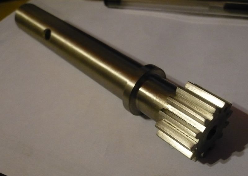

So stuck a piece of Scrapbinium ™ in the lathe and using the topslide as a feed knocked a blank out.

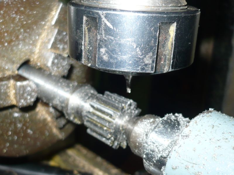

Transfered this to the mill and using just a 1.5mm end mill and Art Fenerty's very clever piece of software called Gearotic milled a new gear on the end.
Resuly was after heat treat, one perfect new pinion shaft.

4) Said inspection soon revealed that the Gear Shaft had bent where the collat on the shaft butts against the Apron casting, so it needed to come out.
5) Roll pin securing the Spur Gear to the shaft, but this time instead of the pin coming out with light biffs of the hammer, I had to resort to GBH/ABH to even getting it to budge.
Eventually it did come out, but tinkle, tinkle, tinkle into the Apron bottom. Three pieces, due to the fact that the holes don't line up!
6) I then had to resort to a large diameter drift to do more GBH to get the shaft and gear to part company. Oh how I HATE doing this to a 'precision' machine, it makes me cringe. Needs must though.
Said Gear Shaft soon popped out, cleaned, then into the 3-jaw to see how much damage I'd done.
All I did was hold a length of 5mm ø aluminium tube, to replace the roll pins, against the front way and just touching the shaft between the shoulder and gear.
Well, it sure as heck didn't need a DTI to measure the runout, as it showed 1/16"-3/32" (1.6-2mm). BH etc was my reaction seing that.
7) Now how to straighten it. I had watched my Old Man do miracles with metal, either making or fixing, so I hoped some of his talent had rubbed off onto me.
After two feeble attempts with a drift and club hammer, yes I know pretty useless, I said to meself, "a vice is just a horizontal press is it not" so off I went and the set-up is in my new Photo Folder.
It needed two attempts of heaving on the vice handle to get any movement in the shaft, but the bend was reduced to approximately 1/32". One last try, this time slipping the handle of my long/big shifting spanner over the end if the vice handle I was able to give it an extra bit of heave-ho.
Left overnight again and now the bend would need a DTI to measure properly, but definately around 1/64" or less.
Decided to put it all back and try. Easy to take apart again if needed.
