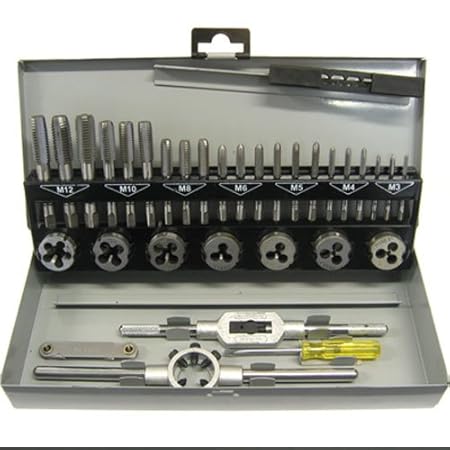

Neil, Is this the set?Regards, Bear..
Xtools 32 Pc Pro Heavy Duty HSS Metric Tap & Die Set - Includes Case
by XTools
Be the first to review this item
Price: £29.99

Stub Mandrel02/06/2013 19:47:36
avatar
4318 forum posts
291 photos
1 articles
Almost identical, although mine had a plastic insert in the base. They may be made by different suppliers, but for 29.99 for a full set it's surely worth a shot!
