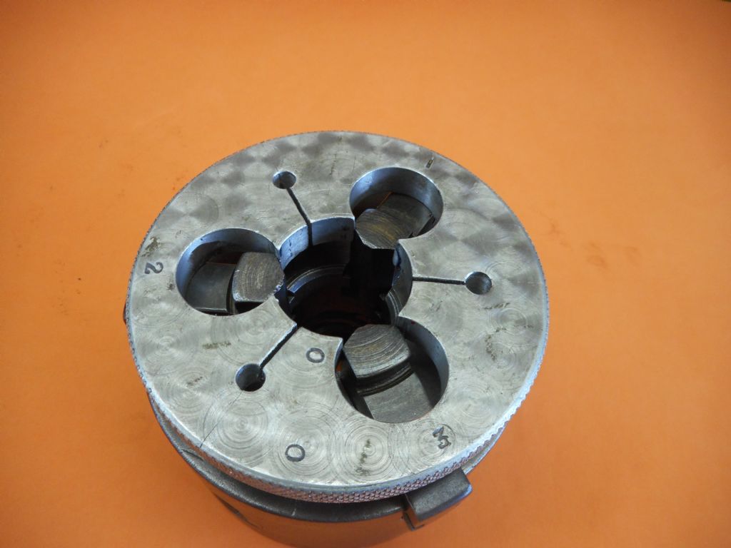

... I did find the chuck jaw's gripping at the back...so I held an accurate ring on the inside so that the jaws were locked and cleaned them up with a tipped v/heavy boring tool...it didn't need much......this did seem to improve the parting of but not by much....
That's possibly because gripping the inside of a ring pushes the jaws in the opposite direction to what is needed when resurfacing the jaw faces. You need to use a clover-leaf plate or spider that pushes the ends of the jaws outwards while the gripping surface is (preferably) ground.
There are numerous videos on YouTube showing people doing this the wrong way because they know no better.
Something like this is what you need. Or you can make a simpler version from three pieces of flat bar with the hole and slot in each and held in position by hand while tightening chuck jaws.
