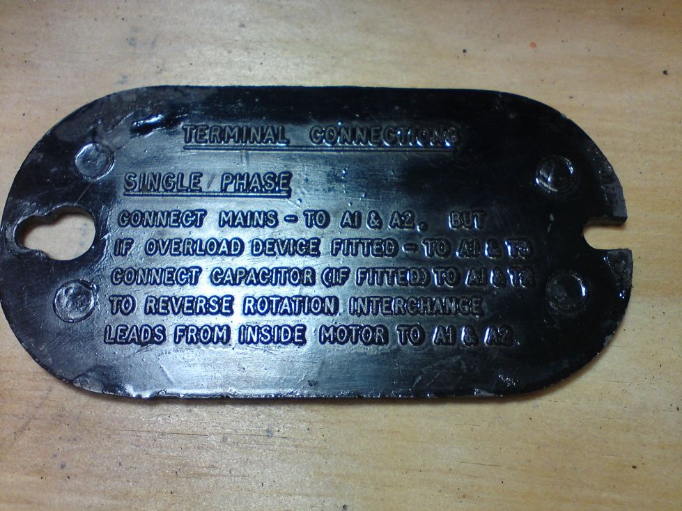

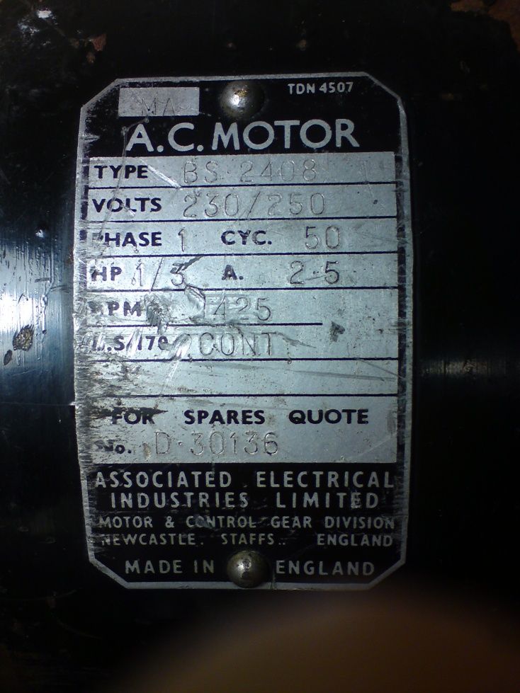

Hi, I've recently rescued a slightly beaten-up ML7 (from a cowshed, in Ohakune). There's a motor attached but there's no cable wired in.
The motor's nameplate says it's a single-phase 1/3HP 1425rpm Associated Electrical Industries Ltd one
nameplate

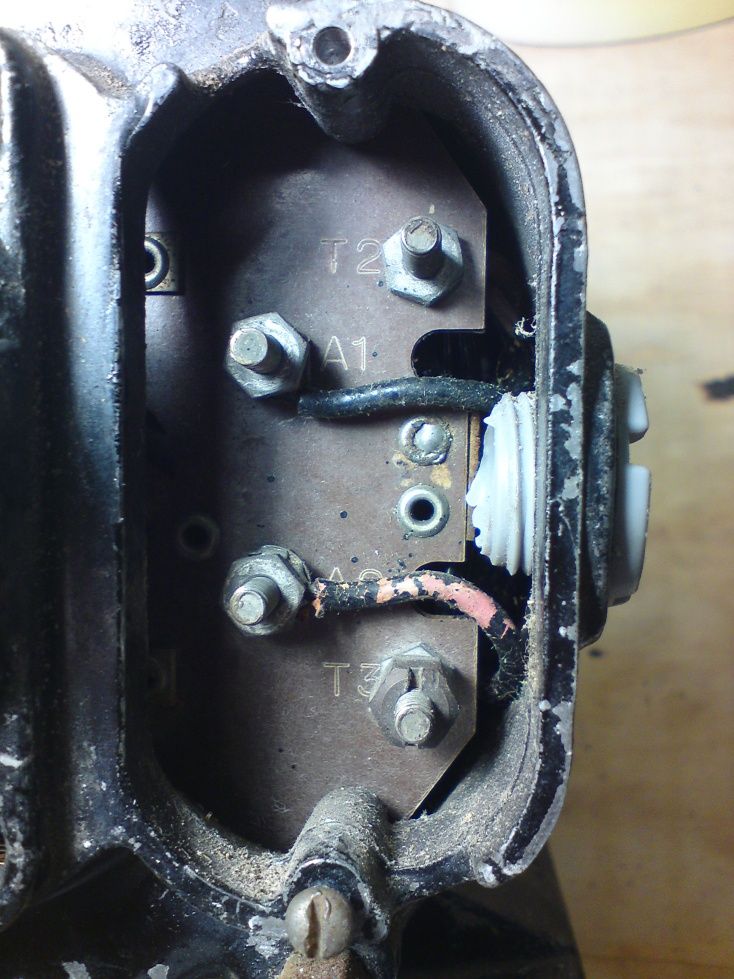

It looks to have 4 terminals in the terminal block, labelled A1, A2, T2 and T3. I don't see a T1!
terminals
There are helpful wiring instructions underneath the wiring cover as well, suggesting the following (not sure the photo's come out all that clearly...)
Connect mains - to A1 & A2, but if overload device fitted - to A1 & T3
Connect capacitor (if fitted) to A1 & T2
To reverse rotation interchange leads from inside motor to A1 & A2
wiring cover
The motor spins if I connect power to A1 & A2 (like it says, although I've only tried it unloaded while it was clamped on the bench). It mentions a capacitor though - would this have been a start capacitor? Possibly missing with the cable or switch etc if it was originally there.
Anyway, I wondered if anyone was familiar with these motors, and...
- if it's ok to use the motor on the lathe as-is, just connecting mains from my switch to A1 & A2 (or is it likely to need a capacitor)?
- if it needs a capacitor, is there a ballpark size for a motor like this? Hunting on google brought me to a rule-of-thumb calculation of
Cap size (uF) = (2650 x Full load amps ) divided by supply Voltage, which comes out to about 28uF for me -- (2650 x 2.5) / 240
thanks for any advice anyway

The terminal arrangement is typical of AEI and is used on reversible and capacitor motors among others. There is also another type known as a "split phase", which only uses 2 terminals, but has 2 wires per terminal, 1 for the run winding and 1 for the start winding. As we can only see 2 wires in yours, would suggest these are the start winding connections, as the motor is reversible by changing them over. Perhaps the connections to the run winding are underneath the terminal plate, as they never change polarity.
If it starts readily and runs up to speed then I would suggest a split-phase.
Run it for increasing lengths of time and see what happens, and check that the torque is OK.
If nothing untoward happens then go ahead and use it, bearing in mind that there may be some insulation problems because of age.

A quick prod with ohm meter might tell if t1 t2 go anywhere.. if not then these are "spare" and you can treat them as a red herring..
If the motor runs /starts nicely then you don't need a start cap... that said insultion/ shorted turns are still a possibilty ...

I am not familiar with this particular motor but do you think it is worth Mike disconnecting the two wires that are connected to terminals A1 and A2 an then measuring the resistance between these two terminals in case the start winding (Via the centrifugal switch.) is connected to the underside of the terminals. If that was the case just swapping over the two wires would reverse the motor. This could be the meaning of the text "To reverse rotation interchange leads from inside motor to A1 & A2" on the plate.

Hi Mike, I have an AEI motor of the same type as yours except that it is a 1/4 HP. It has exactly the same instructions on the cover and exactly the same connection plate inside with the same two wires on A1 and A2 and swapping these round reverses the direction of the motor. There is no start or run capacitor on mine, switching is done by the internal centrifugal switch.
Regards Nick.

As suggested, I've had a quick go at attacking it (fairly gently - it looks pretty old) with an ohmmeter to see if I could add anything in the way of useful information.
I first disconnected the black wire and red wire that you can see coming from underneath the terminal plate to terminals A1 and A2.
Measuring the resistance from the free end of the black wire to the free end of the red one gave me a reading of 6.2 ohms.
The resistance between terminals A1 and A2 was now 15.8 ohms.
Neither terminal T2 nor T3 seemed to be connected to anything else - they were both open circuit to A1, A2 and each other.
cheers
Mike
