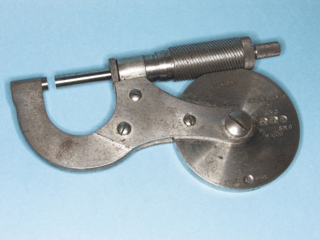

Phil P18/05/2013 22:36:54
851 forum posts
206 photos
A few years ago I decided that I just had to have a digital micrometer, I just could not continue to live without one. I spent what was then quite a lot of money on buying a good quality one.
I used it about three times and hated every minute of it, I sold it at a considerable loss not long after.
It hurts to even think about it now.
Phil
PS.
I later bough a very rare mechanical digital micrometer at an antique fair for £20 and sold it on ebay for £2495.47, so the story did have a happy ending.
I did not realise at the time I bought it there was only one other example known about in the world.
Edited By Phil P on 18/05/2013 22:37:24
Edited By Phil P on 18/05/2013 22:48:17
Edited By Phil P on 18/05/2013 22:49:20
Edited By Phil P on 18/05/2013 22:50:06
Edited By Phil P on 18/05/2013 22:53:29

Posted by Phil P on 18/05/2013 22:36:54
Great story, Phil ... Well done !
I would love to know more about that Mechanical digital mic.
... I see the magic word PATENT on the disc, but not a number.
... Do you have any information ?
Edit:   I just found this link
Edited By Michael Gilligan on 19/05/2013 08:49:39
Phil P19/05/2013 10:21:01
851 forum posts
206 photos
Michael
You can see some more photo's of the micrometer here. The first picture is of the "other" existing one.
The same man now owns both in his collection in the USA.
**LINK**
I keep looking out for another one, but so far no luck.
Phil
Edited By Phil P on 19/05/2013 10:24:32
