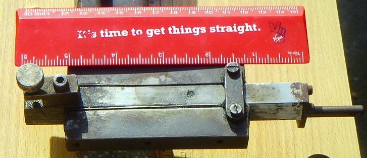

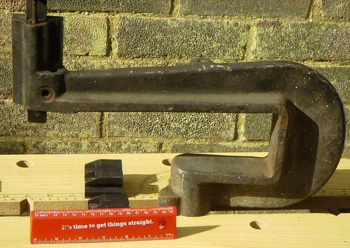

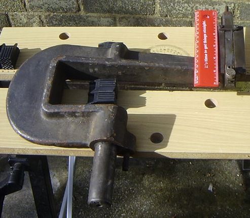

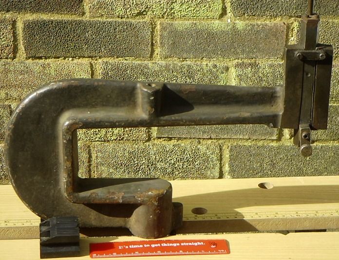

This is the cast overarm alternative to the "roller arm support " you have.
The Harvey Butterfly spares list calls it the "Complete Over Arm"
As you can see it has a round mounting where you have a straight rod called "complete cone".
There is a boss half way along the arm which I have now realised is just to allow it to be mounted between centres for turning the mounting bar. It would need an 18 in swing lathe to do that.
The rear of the end of the arm has holes for mounting the hold down.
The head has a prismatic sliding member with gib strips and clamp for holding the top of a saw blade or file. The round rod in the head is supposed to be enclosed by a spring to provide the upward force for the saw blade.
It was named "Butterfly" because it is as noiseless in its running as a butterfly in its flying.
The mfr recommended oil is "#30" whatever that is.

Spring. At the top of the slide there is just visible a plate held by 2 screws. It has a hole for the rod. Between the plate and main casting there is a long thin coil spring to force the slide up and tension the saw blade. The rod just goes down the middle of the spring to stop it boinging out sideways.
The spring always seems to be missing probably because it is taken out when filing and lost. I think the saw was never used after scroll saws were invented so you are better off with what you have.
