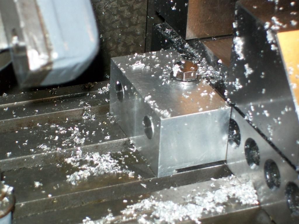

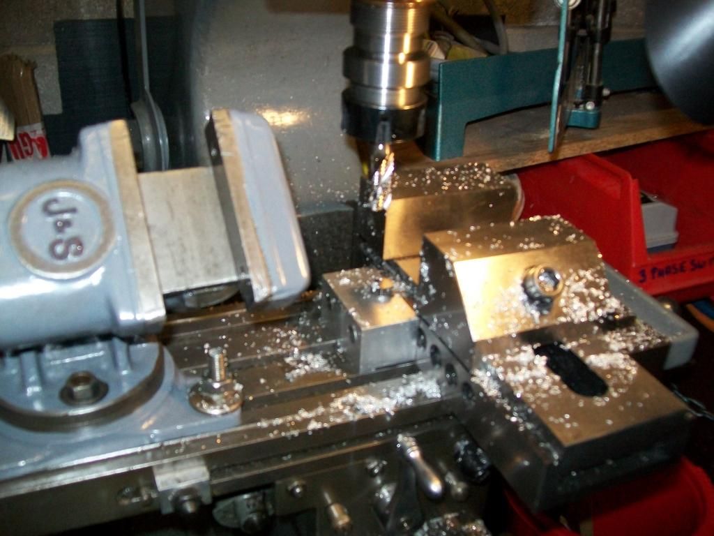

Mounting on mine is catered for by two shop made dogs fitted either side which locate in the holes in the body, the big difference I found and like with these vices is there is effectively no jaw lift so no more deadblow hammer needed to locate the part level.
If you dont fancy one dont forget to add a decent deadblow hammer to your shopping list cheeky

Any chance of a picture of your mounting system Paul ?

Here you go:
Hold down 1 Hold down 2 Hold down 3 Hold down 4

Paul
Thanks for the pics, I was able to see them
