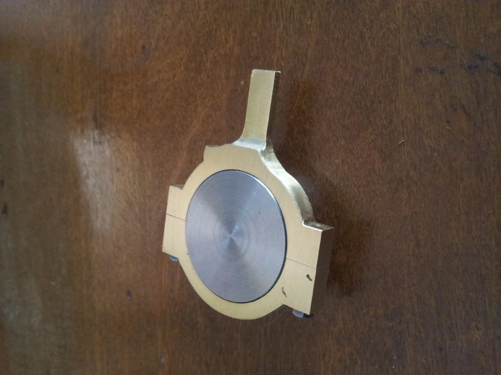

Terryd07/10/2012 09:49:50
avatar
1946 forum posts
179 photos
Hi Ian,
Out of interest here are a couple of pictures of the eccentric strap and new eccentric I am in the process of making to refurbish a Stuart Beam engine damaged in a fire - the eccentric has the locating ridge you describe, I made a special boring tool to make the groove in the strap.
Stuart were in the process of being taken over and I couldn't get a new casting so I fabricated it from solid - besides, I like a challenge and am an old skinflint!. I have progressed since these pictures and have made the operating shaft and clevis brackets and will post a picture when I can get a good one.
Click to enlarge
Eccentric strap 1
Boring the eccentric strap blank before shaping outline. The HSS insert tool for the groove was made to fit this boring bar:
Hope this is of some interest,
Best regards
Terry
Edited By Terryd on 07/10/2012 10:06:31
Terryd07/10/2012 10:03:16
avatar
1946 forum posts
179 photos
Hi Ian,
I found a few pictures taken earlier, con rod was cut from a bit of old rusty sheet and polished:-
Eccentric:
Eccentric control assembly (sketch is my poor hand drawn sketch) BA spanner as a size comparison:
Hope this is not getting too boring, if it is let me know and I'll shut up crook
Best regards
Terry
Edited By Terryd on 07/10/2012 10:09:13
NJH07/10/2012 11:18:02
avatar
2314 forum posts
139 photos
Hi Ian
Terry is quite right - I think it is common on Stuart engines to have this grove cut in the eccentric strap. Here are a couple of pics of the same fitted to the ST "Real"
You asked too about the tapped holes in the cylinder - this shows the drain cocks fitted to the same engine - is that the position of your holes?
This engine has sat on the desk in my study for many years ( I think I made it over 30 years ago!!)
Looking at the 'photos it's Filthy!!! and, worse still, a few signs of rust are appearing. I think I'd better give it a birthday!
I always enjoyed building the Stuarts - the castings were well produced and easy to machine - well at least they were 30 years ago! when I bought this set from Henley.
Let's see a few pics when you finish your restoration.
Regards
Norman

Terryd07/10/2012 11:29:44
avatar
1946 forum posts
179 photos
Hi Yet again Ian,
I note that your eccentric is about 1 1/8" dia, I just checked my books and it appears to be the same as the one on the Beam engine, Here is an extract from the Stuart Drawings in the building advice book by Andrew Smith. Together with the main dimensions of the strap. Let me know if you need more information - send a pm -, the crank should be the same as well I suspect.
Click to enlarge
Best regards,
Terry
Edited By Terryd on 07/10/2012 11:30:21
