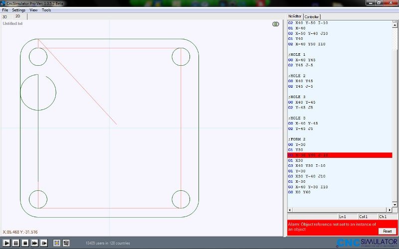

Jasmine01/09/2012 17:45:43
avatar
12 forum posts
6 photos
Right guys
Just got back from Paris and managed to get started on some G Code.
Starting off small and simple but, I keep getting errors, see below
When using NCCAD I get a Y Axis error at the first line......any ideas boys?
[IMG]http://i266.photobucket.com/albums/ii276/crash_photos_01/CNC_Help.jpg[/IMG]
;OUTER
G0 X-40 Y50
G1 X40 F400
G2 X50 Y40 J-10
G1 Y-40
G2 X40 Y-50 I-10
G1 X-40
G2 X-50 Y-40 J10
G1 Y40
G2 X-40 Y50 I10
;HOLE 1
G0 X-40 Y45
G2 Y45 J-5
;HOLE 2
G0 X40 Y45
G2 Y45 J-5
;HOLE 3
G0 X40 Y-45
G2 Y-45 J5
;HOLE 3
G0 X-40 Y-45
G2 Y-45 J5
;INNER
G0 Y-30
G1 Y30
G3 X-30 Y40 J10
G1 X30
G3 X40 Y30 I10
G1 Y-30
G3 X30 Y-40 J-10
G1 X-30
G3 X-40 Y-30 I-10
G0 X0 Y60

John Stevenson01/09/2012 18:08:03
avatar
5068 forum posts
3 photos
What happens if you change the first two I's and J's to negative then the last two to positive ?
Not familiar with a code that doesn't put I's and J's on the same line
;INNER
G0 Y-30
G1 Y30
G3 X-30 Y40 J-10
G1 X30
G3 X40 Y30 I-10
G1 Y-30
G3 X30 Y-40 J10
G1 X-30
G3 X-40 Y-30 I10
G0 X0 Y60
Jasmine01/09/2012 18:29:11
avatar
12 forum posts
6 photos
Opps!!! face 4 This makes things go a little crazy.........
I guess this may have something to do with G2 & G3 being CCW & CW????

David Clark 102/09/2012 00:38:49
avatar
3357 forum posts
112 photos
10 articles
Hi There
A long while since I programmed but:
A couple of things.
I assume the inner is causing the problem? It looks like you are going clockwise around the outside (correct) and clockwise around the inside (incorrect). Also, no obvious G41 either.
You don't have a X start point which should be -40 + at least half the cutter diameter + 1mm or so, probably about -46 assuming a 10mm cutter, but it might have been set up by a previous move.
I think G3 should be G2.
The easy way to remember which way is which is G3 = 3 letters - CCW for counter clock wise and G2 is two letters - CW for clock wise and the program is definitely going clockwise.
I and J on their own are fine john. As the other centre of the radius dimension is correct it is not needed, the program/machine will assume the start point is the radius centre..
I or J 10 or I and J - 10 is just the offset in the direction of the 10 mm radius centre.
The only thing I can't remember is if the + 10 and - 10 and relevant moves should be in incremental. Too long ago since I programmed.
I am assuming that you are cutting the profile outside.
If inside, the cutter must be less than 20mm diameter (10mm radius) or that will stop it working.
Post the complete program as a text file if not too long.
regards David
Edited By David Clark 1 on 02/09/2012 00:44:06

Chris Courtney02/09/2012 16:15:45
31 forum posts
Hi Jasmine,
The screen dump seems to be of a simulator run from some G code that you have hand written. Your code looks ok to me; obviously the outer profile and the four holes are shown correctly. The move that seems to be causing the problem is:
G3 X-30 Y40 J10
The screen dump shows this move correctly, ie a CCW move starting at X-40 Y30 ending at X-30 Y40 with the centre of the arc at X-30 Y40. This means that your system is set to use absolute coordinates, with the I and the J values as incremental.
One slightly unusual aspect of your G code is that you have omitted I and J values when they are equal to zero, and X or Y coordinates when they have not changed since the last move. Some CNC controllers allow this some don’t; your simulator seems happy with this for all the outer moves and the four holes.
I would suggest you try the following on the offending line of code:
1) Explicitly set the I value to 0, just in case, ie.
G3 X-30 Y40 I0 J10
2) Erase the line and then re-type it, in case there are some non printing character embedded, or if you’ve used the letter o in place of the number 0. It sounds silly, but I have seen it happen often enough.
3) Check that there are no typos in the line following the highlighted line, or indeed in the rest of the program, sometimes the location the program stops at is not exactly where the error is located.
The error message is as helpful as most error messages are…. It will mean something to the programmer who wrote the simulator, but no help to anybody else!
You obviously understand G codes, so don’t be afraid to experiment, try different values and shorter program snippets until you find what is causing the error. As far as I can see there is nothing obviously wrong with the program you have listed.
Chris
Jasmine02/09/2012 16:18:45
avatar
12 forum posts
6 photos
Yippee finally cracked it wink 2 enlightened thumbs up
It appears that I needed to have both I & J values when using the G2 or G3 command even if they were zero.
I have actually managed to cut my very first piece today, thank you all so much
Here is the very simple G code, I have added ;descriptive help text so I don't forget what each bit does.
;Distance Mode - Metric
G90 G21
;Rapid Motion
G0 X10 Y20 Z-170 F600
;Linear - Arc Feed 01
G1 X10 Y80 F100
G2 X15 Y85 I5 J0
;Linear - Arc Feed 02
G1 X80
G2 X85 Y80 J-5 I0
;Linear - Arc Feed 03
G1 Y20
G2 Y15 X80 I-5 J0
G1 X15
G2 X10 Y20 J5 I0
;Return to Zero
G0 Z-170 F600
G0 X0 Y0
;Inner
G0 X20 Y30 F600
G1 Z-186 F100
G1 X70
G3 X75 Y70 I5 J0
G1 X70
G3 Y75 Y70 I5 J0
G1 Y30
G3 Y25 X70 J-5 I0
G1 X25
G3 X20 Y30 I-5 J0
G0 Z-170 F600
G0 X0 Y0
M2
