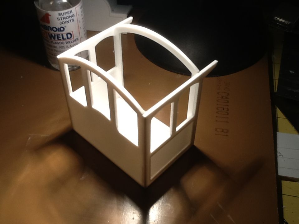

I use Ambroid Proweld it's a plastic solvent which uses capillary action. Not the cheapest but is the best.
Simply hold / clamp / tape your pieces together run the supplied brush along the joint and hold for 10 seconds. No mess no fuss just a beautiful strong joint.

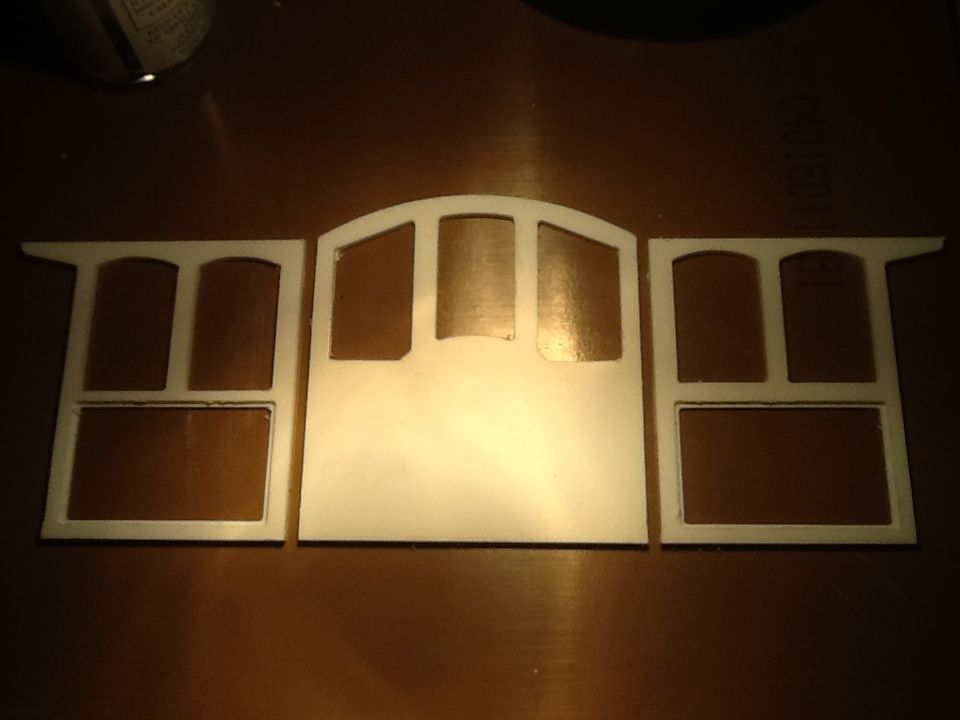

Have had a request to create a model / diorama of the rollercoaster "Thunder Mountain" at Euro Disney.>>
This is the first time I have used my CNC machine for a work project and thanks to a few of the guys on here I am finally getting to grips with G-Code. This meant an amazing trip to Paris to get some good reference images after a few attempts I am happy with the cab. Here are a few pics of the first stages of the build.>>
This is a static model and will be constructed mainly from Plasticard, any tips & crits welcome.xxx>>

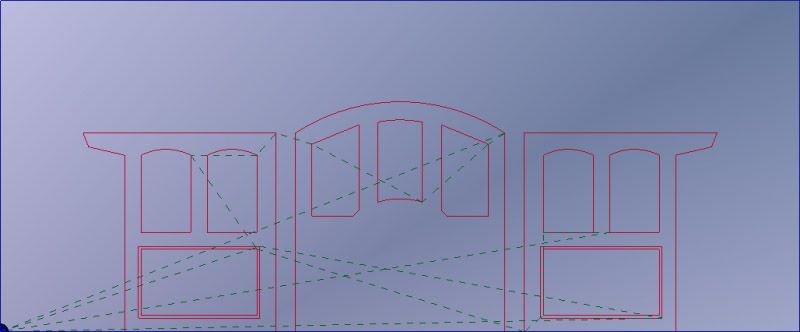

Yippee finally cracked it wink 2 enlightened thumbs up
It appears that I needed to have both I & J values when using the G2 or G3 command even if they were zero.
I have actually managed to cut my very first piece today, thank you all so much
Here is the very simple G code, I have added ;descriptive help text so I don't forget what each bit does.

Opps!!! face 4 This makes things go a little crazy.........
I guess this may have something to do with G2 & G3 being CCW & CW????

Right guys
Just got back from Paris and managed to get started on some G Code.
Starting off small and simple but, I keep getting errors, see below
When using NCCAD I get a Y Axis error at the first line......any ideas boys?
[IMG]http://i266.photobucket.com/albums/ii276/crash_photos_01/CNC_Help.jpg[/IMG]
