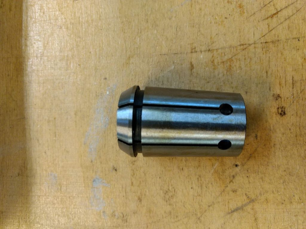

Posted by DC31k on 29/10/2019 07:02:28:
Posted by John Reese on 29/10/2019 00:41:46:
There a lot of similar collet chucks on the market. They are definitely not ER type collet. They resemble Acura grip or TG collets but my not be compatible with either system.
I think the ones shown are known as Oz collets.
OZ collets it is, thank you.
Terje

The collets are all part of the box in photo 5. Metric set of 3,4,6,8,10,12,16 mm collets with milling chuck MT3? and spanner. Unused still oiled and in plastic bags.
28/10/2019 20:22:37
Some more photos. Any help to identify them are apreciated.
Terje

As part of a lot obtained some months ago I found three set of toolings whch I have not seen before.
The chuck backplate was mounted to the 125mm chinese chuck but to put on which lathe.
The QCTP has a geometry unknown to me. Any sugestions.
The collet set is not an ER set but what type of collets. Longer than my ER32.
All are unused and in good conditions. Bought from Little Machine Shop, USA some years ago the seller said. Searched the site but could not find them.
I hope for some help as I intend put them up for sale and like to have some information in the ad.
