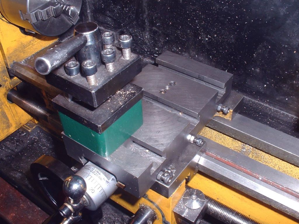

I have an Asian-manufactured lathe of the 9 x 20 variety, bought locally here in France. Although I'm very pleased with it, it lacks a tee-slotted cross-slide. Having looked at many pictures on various web sites, it appears to be very similar to any number of other lathes of the type. I was wondering if I could perhaps substitute a cross-slide from one of these for the original on my lathe. It shares many similarities to, for example, the Harbor (sic) Freight, Grizzly and Enco lathes sold in the USA as well as the Chester '920' and DB10 models, which are, in turn, similar to the WM series from Warco and the Axminster BV20M. I wonder, if anybody has any of these lathes, would you kindly take the time to give me the dimensions of your cross-slides in order that I can compare them to mine? A picture of my lathe is in my photo album.

I am just about to bolt one of these onto my cross slide, so I can put it on and take it off as required.

I purchased both John, to see which one would suit my needs better.
The one not used will be turned into a t-slotted sine table.
It is looking like the RDG one will fit the Crusader the best..

I'm a little concerned that bolting one of these on will reduce the capacity of the machine too much, but is certainly a quick fix and one I'll definitely consider if I can't get a 'proper' replacement.

I think you will find that if the topslide already fitted to your lathe isn't thick enough to cut your own slots, then fitting one that does, you will be losing machining clearance anyway.
BTW, the way I will be fitting the bolt on one is only onto the plain portion of the cross slide, not underneath the toolpost as well, and will only be fitted when required.

Like yourself, I measured up my original to see if I could get standard t-slots into my cross slide (In my shop, I have settled on two standards, 16mm & 8mm), but unfortunately, I found that I would not be happy with the strength of them because the top area would be a little on the thin side, hence going for my solution.
The way I looked at things, the t-slots will be for mounting either specialist tooling, which I can make to my own dimensions to fit, or for mounting something that needs to be bored between centres.
I am lucky in that I do have a largish machine, and thus more clearances to play with.
It all boils down to what is acceptable to yourself, and it looks like your solution will be the best, whereas I couldn't do what you are going to be doing as mine would be a more complex topslide to make. It could be done, but it would far outweigh the benefits gained.

Another way to keep the costs down if your cross slide doesn't quite have enough depth to cut the whole T-slot, would be to cut just the wide bottom half into the cross slide and fix steel strips just a little thicker than the T-nut top bit height onto the top face to give you the narrow slots for the tops of the T-nuts.
It wouldn't be the best looking T-slotted cross slide, but it would be very cheap to obtain the same effect as a fully machined one.
