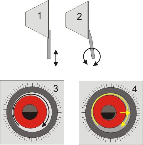

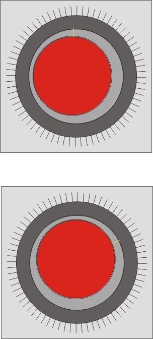

I have a problem that I hope one of hte more mathematically competent can help me with. I was hiding when they gave out the bit of the brain that does Maths.
I am designing a grinder workhead for Dbits and think I have the general mechanism down OK. What I don't know is the relationship between an offset and degrees.
What I want to do is have a sleeve that is bored about 1mm off centre in which a tool holder sits. The toolholder will be an ER 16 or similar collet.
Once the tool blank is split, the sleeve is rotated by a number of graduations that hopefully corespond to real degrees of back off.
Please see the pictures to get a better idea of what I mean.
Thanks, Lawrie

If you offset in one axis relative to the flat of the D-bit, as is implied by the end on view of the D-bit, then at the cutting edge the angle will be zero since the tangents to both circles will be parallel.
To get a clearance angle I think that the line representing the flat of the D-bit needs to be offset in two axes from the centre of the circle intended to form the clearance.
Regrettably I don't have time at the moment to sit down and do the analysis. If I get bored over the weekend I might have a play with the maths.

Hi Andrew
Thanks for your reply. I often need someone's comment to firm up my own idea.
What I have described above is basically the way that grinders like the Deckel and Pear et al work.
The problem I am having is about the graduations. If as I stated, I have the bore offset by 1mm, how do I translate that into degrees in the graduations?
With the Deckel, the machine with which I am familiar, you split the cutter by maintaining a plane between the cutter and the wheel. You then set the taper angle you want and grind that by rotating the collet through 180 deg. Once that is done, you loosen the colar for the offset and rotate it by the number of degrees you want the relief to be and then with the cutter at 90 deg to the wheel, rotate again through 180 deg and that gives you the relief and backoff from the cutting edge.
I am trying to understand the relationship between the amount of offset of the bore, at this point an arbitrary 1 mm, how many marks there are around the collar of the collet holder and the number of degrees of relief I obtain behind the cutter.
If I want 7 deg relief behind the cutting egde, it would be handy to to rotate the locking ring to a mark representing 7 deg and off I go. What I am thinking at present is that if I make the bore offset 1mm, I might get 7 degrees on the ring but if I make the offset 1.5mm does that mean that I by setting the ring to Gas Mark 7 I will actually get 12 deg or something else?
I hope this clarifies the question.

To Steve, thanks for the reply. I ran the problem past my sone who at seventeen is strong on maths and geometry. Explaining the problem to him helped further clarify it for me. He did come up with an answer that makes sense to me and I will draw up a diagram of what he has proposed to see if others agree.
Firstly I have drawn up second set of pictures that may better explain the mechanism and information I am trying to elicit.
Number one is a D bit being split. In number two, the head is rotated about the Z axis to N degrees and the taper ground by rotating the collet and plunging it into the wheel - sorry, left out an arrow.
In number three the bit is rotated ninety degrees to present the cutting edge to the wheel.
In number four, the excentric that holds the collet is rotated by N degrees which in turn moves it across the X axis thereby altering the axis of the D bit in relation to it's original grinding position. Rotating the collet and plunging it into the wheel now grinds at an offset giving a relief behind the cutting edge to about 178 degrees.
what I am trying to ascertain is the relationship between the degree of movement of the collet as established by the mount of offset in machining the bore - a nominal 1mm - and the degree of rotation obtained. So: If the collet is offset from centre at the time of grinding and I then rotate said collet, how do I know how many degrees that rotation represents to the D bit.
Or to put it another way, if I was to scribe the collar with a mark at every degree and then rotated the collar to the seven mark, how would I determine that I was going to get seven degrees of rake on the bit, short of doing it and then measuring?

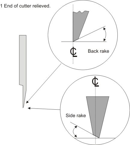

I'm probably being thick, but I don't understand what you mean by rake angle on the bit. Can you post a diagram of the D-bit showing which angle is being referred to?

Sorry Andrew, thanks for your suggestion. Rather obvious once it has been pointed out.
This is the angle I am talking about

Isn't that the angle that remains obdurately at zero degrees at the point of contact, unless you offset the horizontal split line so that it's slightly below centre?

A D bit cuts on the edge as Steve points out. It has to be split to exactly half the thickness of the bit and then relieved behind the cutting edge to give it some bite. As Dusty rightly says, it is a single lipped cutter although it does cut on its edge - there is nowhere else for it to cut. It is not a reamer.
The cutting edge is on the side of the taper so that the tool cuts a taper. The value of the D bit is that if you can grind the profile, you can cut the shape.
The proper name for the relief behind the cutting edge is actually the clearance angle and it is this angle that I am talking about. I should have been more careful in my terminology.
There are three sets of relief on a D bit see http://www.pantograph.co.uk/pdfs/cutter_geometry.pdf for a better description. The cutting edge gets a clearance angle and reduces the opposite edge of the cutter which allows it to chew. The tip gets relief from Paris Hilton... sorry, don't know how that got in there. The tip gets a back rake and a side rake which is the same as a drill or end mill.
I know how to make mechanism by which the clearance angle is ground, it is the relationship between moving the cutter .N mm to one side and the number of degrees that equates to on a dial which is the problem.
