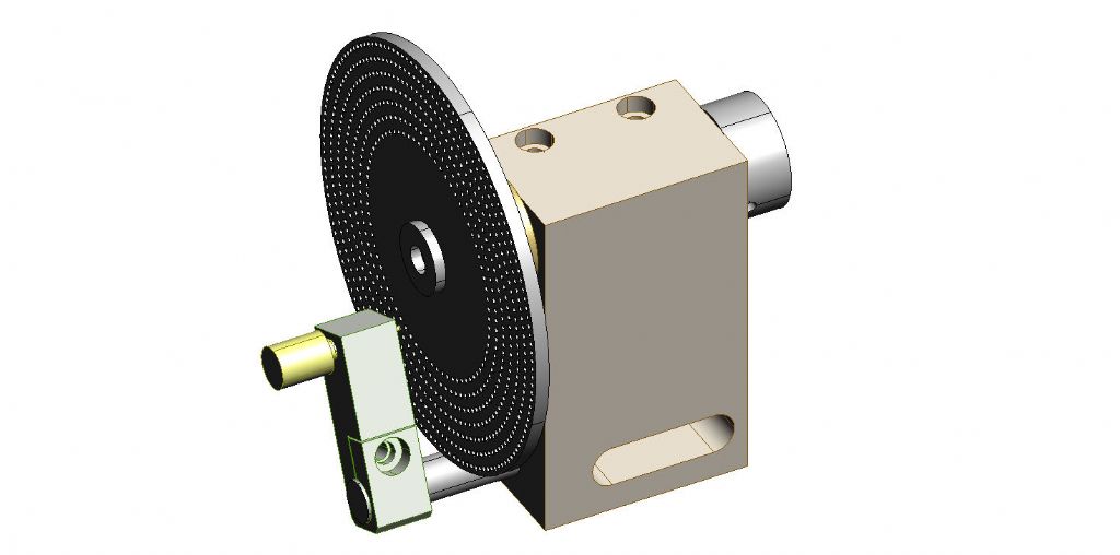

Right now I'm working on a dividing device that should make me able to cut wheels and pinions.
The device I intend to build as a direct drive unit, i.e. the dividing plate i fix to the shaft chuck - øøeh hope this gives meaning.
Now I have made the plate with the following set of locating holes :
140-130-120-100-96-80-76
This should give a lot of dividing setup, but before I go on, I would like to know if I should ensure other numbers of locating holes, in my effort to make useful wheels and pinoins for clocks.

Use a black marker pen to mark the holes you need to use before actually cutting metal. After you have finished wipe it off witha bit of meths. I do this with my Vertex worm dividing head, I am sure it has saved me from miscounting when it really matters.

On a lathe will a backgear, the bullwheel is the large gear on the spindle that directly drives the work. It can be very convenient for direct dividing, provided it has a useful number of teeth. The one on the ML7 has 65, which is only useful for doing 5, 13 or 65 divisions. With 60 you can do 2,3,4,5,6,10,12,15,20,and 30 divisions. As well as 60 of course.

I think it's time to show my CAD of the intended tool
Mogens

Morgens, do you have some way, other than the indexing pin to lock the shaft? It looks a very usful tool, and nicely made. Ian S C

The main shaft is locked in the tool post after indexing

This looks a very neat device ... will you be selling the plans through your website?

Ahem, cough, Michael, do you really need a plan to clone such a gadget?
No big secrets here I think... But the clamping method for the detent arm is a nice solution; I hope to remember it when the need arises next time.
