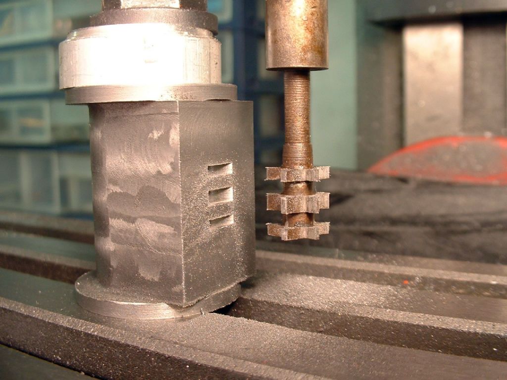

I had hoped by now to have been well into another pair of scaled up diesel engines but thanks to a timely visit from  fellow forum member Bill Starling  I have recently been well and truly 'side tracked' into tackling something I have been putting off for far too long.
In 1992! so my notes say I began a Bentley BR2 rotary engine. I knew nothing about petrol engines - still don't - but did fancy it as a 'machining project' Intermittent work on it until 1996 saw all the major components made with the cylinder heads rough turned with the lower faces, combustion chambers and valve boxes finished. I packed it away for some reason with the quip in my notes "back soon"  Here we are fourteen years later and Bill's visit provided the impetus to do something.
I made several cutters to finish these heads off and thought that this might be of interest to those who as yet have to travel that path. It's not difficult and gives another dimension to your machining capabilities.
Left to right these are a 15mm x 40tpi LH tap. Not tempered it cut much better than anticipated, Next the counterbore for the valve boxes. Slow work due to having to clear the swarf from the flutes. It cut eighteen boxes and nine cages without resharpening though. The three spotfacers worked well too the right hand two are not tempered. All these and those in the next pic were made from silver steel and quenched in oil.
This image shows the failures too! From the left the first did two fins in the set up piece before shattering. As I changed it out I noticed I had not locked the head on the mill. The second due to insufficient backing off became crowded and broke on the second fin on the first head. (Raise of eyebrows!) The third however cut all the side fins (one side on each head at a time) losing first one tooth at some stage, working well for some time with two before losing another finally flycutting with just one tooth until three fins left to do - sterling service I'm sure you'd agree. The fourth had little work to do then and the last cutter was made longer in order to clear the fixture when cutting the top fins.
It was noticed that the crowding was exacerbated when using coolant - I can only brush it on - this seemd to make the swarf stick in the slots. The top fins were done without using any at the same speed - no sticky moments and the cutter did the lot without re-sharpening.

Regarding patience John, I guess it boils down to what you (one) wants to do. It's taken me a long while to get round to this but once started I was surprised how easily each op transpired into the next. I definitely set out with the mindset of taking it one op at a time and to put it away again if it got tedious. It is a big hurdle in this project though so I'm well pleased its over.
I have as said put it away again to get going on another pair of CI engines - the first block is in the vise ready to cut but I do intend to give a lot more time to the BR2 next year.
Howard, I began by using the articles in ME and then bought the book. There are quite a few mistakes in both and also one or two in the 'correction article' subsquently published. Fortunately I noticed something early on (can't remember what) that led me to double check everything. The biggest mistake that could cause real  problems is a 3mm error on the crankshaft both in the articles and the book and not mentioned in the corrections either.  I drew this out several times to convince myself this was wrong  but it was only this time after Bill had left that I finally plucked up courage to assemble the shaft in its housing and yes the maths proved right - Phew!! I have never seen a copy of the drawings so have no idea if they are direct copies of whats in the articles or vice versa. Anyone else know?
The heads are indeed made from steel Ian, the only aluminium parts in the engine are the cylinder barrels and the cover over the thrust box. I believe the materials in the model are like for like in the full size.
As there have been several PMs regarding the cutter manufacter here are a few more images with relevant captions
The back faces of the fin cutter were difficult to get to so it was held in the drill chuck and the drill put in lowest gear to provide resistance against the filing action. Each tooth was backed off before hardening using a # 2 cut needle file. Each tooth was inked with felt pen and filed to leave a small land across it about .2-.3mm wide.
Transferred to the bench vice the outer faces were much easier to do.
When heat treated and in this particular case tempered it will be ready for sharpening
The left one has been heat treated but not tempered and the right one is ready for H&T
The process is repeated using a small grinding point in a 'dremel'  type tool putting less of an angle on and taking care not to grind below the front cutting edge.
Likewise the top faces
The cutter ready for work. The uniform 'tempering colour' was achieved by heating it in hot sand keeping the smaller end toward the top and letting the heat build slowly through.

.........................Must admit I was getting a bit 'nervy' at this stage but the cutter sailed through without a hitch. Note there's no coolant in use
Well I hope this of use to those who have asked and to those thinking about having a go at cutter making themselves. The only thing I would add is that despite silver steel being recommended to be quenched  in water I always prefer to do it in oil. There is far less likelyhood of the cutter cracking and the slightly lower hardness achieved is more than sufficient to carry out the task, certainly in EN1a as in this case. That's a personal thing though - 'yer pays yer money etc' but remember - however you do it cutting speeds are much lower than for HSS tooling.
