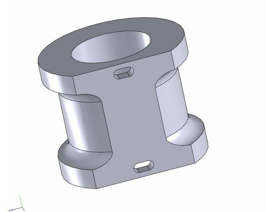

I have acquired and built a few Stuart sets from incomplete castings over the years. There are a couple of approaches with the cylinders. One is to make a round part, machine a flat on it for the steam chest, and then braxe on the block for the steam chest. This gives the opportunity to make suitable ports before brazing the parts on. The downside is that cast iron is not terribly easy stuff to braze (Or easiflo) The Tenacity number 6 flux helps, but it is still not easy to be sure that you have got good penetration all the way into the joint. Steel would be easier, and I would think that a steel cylinder and a cast iron piston should be very satisfactory.
Another approach is to simply carve the whole thing out of solid. This tends to be easiest when you have a vertical mill and some gear like a dividing head and a rotary table. I have made the cylinder blocks for a Stuart Triple  that way, successfully enough that a number of people have thought it was the castings. (The triple has two castings that bolt together.)
With a machined from solid cylinder, you will generally have  to drill the ports, which is a tricky job requiring careful seting up and a drill that does not wander too much.
Your lump of cast iron does sound very useful, other than the Armstrong approach (Hand hacksaw), you should consider being nice to people with bandsaws, perhaps take them a few beers or similar.
The usual thing with bearings is to run a hard shaft in a soft material, and funnily enough it is not always the soft one that wears the most. For steam engines the shaft does not need to be all that hard, mild steel running in brass or better, bronze, is perfectly good.
The ends of the cylinder are called covers on a steam engine. That gland would be the piston rod gland, later there will be a valve rod gland.  A good trick with glands is to modify the design to allow the use of an O ring. This does not need to be compressed like soft packing would, so the design is arranged to provide the right sized groove for the ring, and the gland itself just screws up to a shoulder. You can also use O rings for piston rings, although you want a good finish on the bore for this. Other than O rings, the usual packing is graphited cotton, which at a pinch could be made from ordinary cotton cloth teased apart and graphite grease. Piston rods are ideally made from stas steel rod of the right size, which does not need turning on the outside, althoug polishing it wouldn't hurt.
It is actually usually a good plan to bore the cylinder before making the piston, because it is easier to turn the piston the match the bore than the other way round.

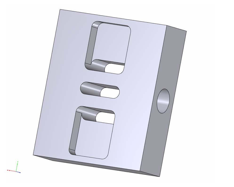

The carving out of solid approach does require milling equipment with say a rotary table, so isn't very likely to be your first choice. I did a pair for a Stuart double 10 with the brazed on approach. The machining wa all done on  Unimat 3 with the vertical milling attachment to do the flat for the block to braze on.
Ports...the Stuart casting come with cast in ports, which saves some tricky work. The flat face is where the slide valve works. This face has three slots in it. The middle one connects to the exhaust hole on the outside face of the cylinder.  The other two each connect to their end of the cylinder. In the original Stuart design, this is a bent hole, so you can't drill one the same. For a carved from solid cylinder what you have to do is set the cylinder up on a slight angle, carefully , and make a small angled flat at the edge of the cylinder bore. Then you drill a hole down from that flat to meet the bottom of the portmilled into the valve face. This really needs a picture or diagram...I will see what I can find. Don't let it put you off, it needs careful work but it can be done.
If you are doing one with the block brazed on, you can proceed like this: The block has the three ports milled in the middle of it.  the two outside ones go right through, and a channel is milled from each of them to the end of the block. This communicates with a hole through the main piece into the cylinder bore. When you braze/easifo the block in place, you end up with a port that connects from the valve face to the cylinder bore.  You must not overdo the amount of silver solder as you don't want it to fill up the port.
For a hole for a rod to work in, you really should drill undersize, then use a reamer to bring to the right size. Having said that, if you don't have a reamer you can sometimes get away with a drilled hole, but the drill must be in brand new condition, and you will still  tend to get a looser fit.
I have just put a couple of pictures that might help you to visualise this in my photo album.
Note that on some engines, the flat on the cylinder need not go right to the end. The ports as shown here do not match for size on both parts, but I think you should be able to see how it goes together.

Does the middle hole, the one for the exhaust have to go all the way through if the exhaust hole is above it?
The small metal piece that slides over these ports controls the exhaust then, not the steam in. What controls the steam in then?

No, the exhaust does not need to go all the way through, and it would be better if it did not. It would make it more likely that you would not have any awkward leaks. ..It is just a quick sketch, the other two ports had to go through so I did them all the same.
OK the slide valve is like a small block of metal with a recess on the face side. Think of it as a small box shape. The size of the recess is such that it will bridge over two of the ports, eg exhaust and one cylinder port. OK, now, the whole of the valve area is covered by another larger box shape The steam supply is connected to this. The pressure pushes the valve against the valve face, which gives us a seal.
The valve rod comes through a gland in the enclosing box. (which we call the steam chest.)
When it moves the valve one way, the recess bridges one cylinder port and the exhaust port, so that end of the cylinder is exhausting. At the same time, the cylinder port at the other end is uncovered, so steam from the valve chest can enter the cylinder, pushing the pston towards the other end. At the right moment the valve gear moves the valve the other way, so that roles are reversed and the piston moves back. There is of course a lot of refinement that we are not going to talk about just yet....
If you can find the (free) Dockstadter valve gear program and load it on your machine, you can see live animations of how this all works
