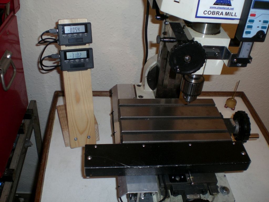

Hi Benedict, I too used Arc Euro scales Digital Readout Bars on my mini mill almost eight years ago, and they are still working fine, and like John used a standard vertical readout bar for the quill, which is similar to these from Arc Euro Standard Vertical Readout Bar
You can see how I fitted mine DRO's for a Mini Mill
Regards Nick.
