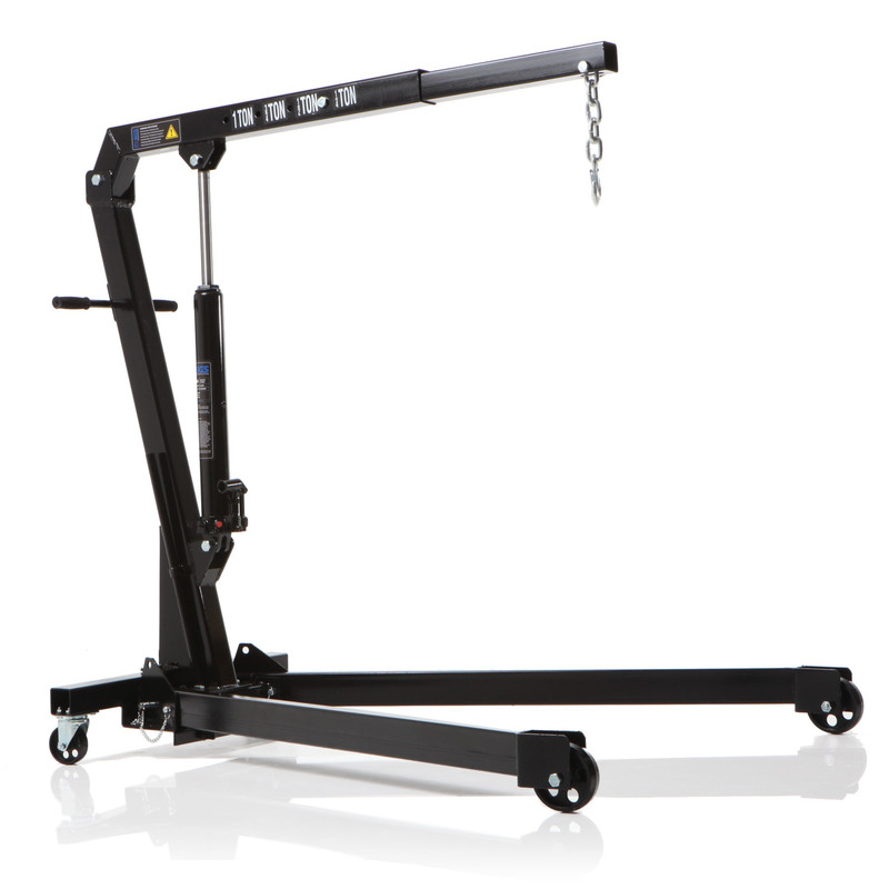

Vic27/06/2023 15:52:47
3453 forum posts
23 photos
I don’t know where Jason got that engine hoist but mine is a lot wider than that and I only just managed to use it in my shed. If I had suitable welding gear I would have modified it to make it easier to move in tight spaces.
Mine is like this and the legs are as long and wide as they look!
