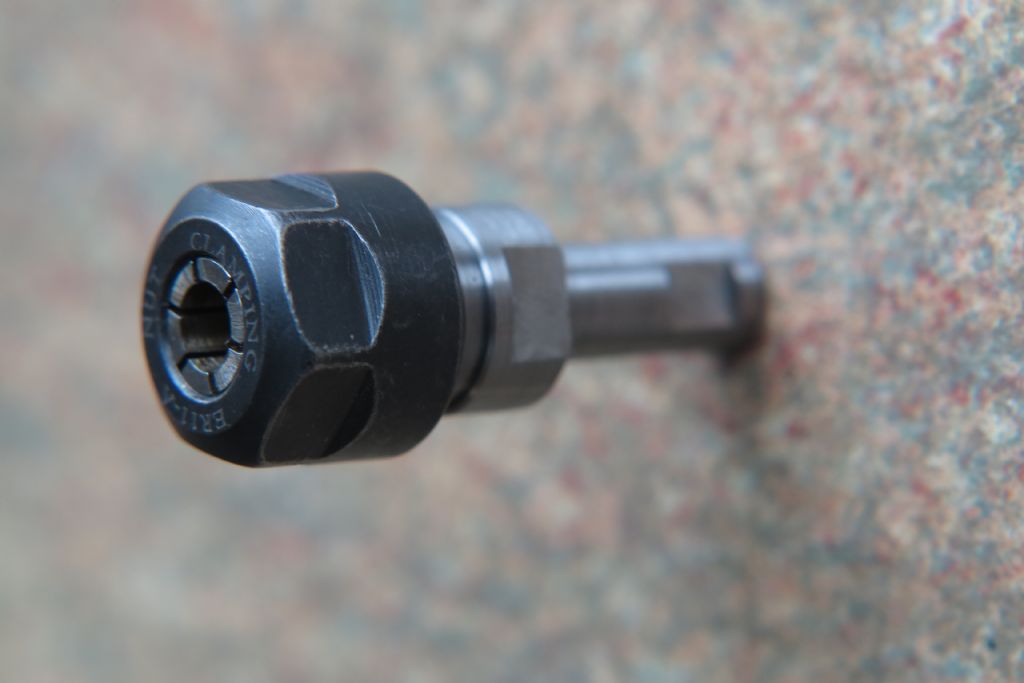

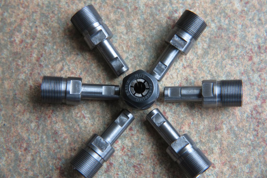

bernard towers30/05/2023 16:21:46
1221 forum posts
161 photos
img_5944.jpegwhen I made mine I used USACUT55 which is a type of 16T and seems to be ok.Theynwere for a taistock turret.img_5948.jpeg

bernard towers30/05/2023 17:36:05
1221 forum posts
161 photos
Dalboy, I made 7 and the nuts were £22 and the material was in stock plus how much is satisfaction per hour?
