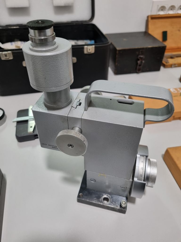

John McNamara02/04/2023 02:35:09
avatar
1377 forum posts
133 photos
Hi Michael
Thanks for the info.
You are amazing you always know where to look.
They must have updated it. Apparently there is a later one as well. Maybe one will turn up!
I don't speak German. It would help if I knew the actual German naming convention for it.

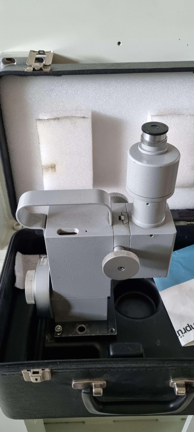

This is the one I have on the way.
It will be very interesting to test it out.
Michael Gilligan02/04/2023 05:09:22
avatar
23121 forum posts
1360 photos
Very interesting, John, thanks for sharing the photos.
I don’t speak German, but fortunately most technical German is very literal and therefore translation is quite simple.
Fluchtlinienprüfer translates to Flight Line Tester
and it doesn’t take too much imagination to realise the conceptual similarity between a flight-line and a taut wire.
We did a lot of this rudimentary translation when I worked at KODAK in the early 1970s, but it’s much easier now … I just turn to DeepL when I see a tantalising word, instead of hauling-out the dictionary.
