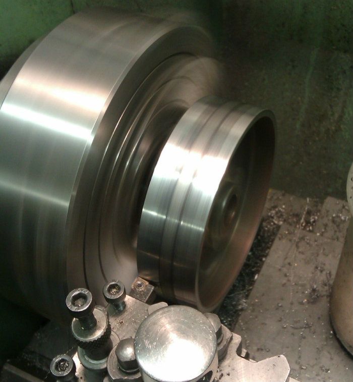

I've done it on several small pullies and flywheels, depending on width us e3 or 5 facets blended with a file, single angle lathe file is the best but a standard flat will do
3 facet just visible
5 facet one below

Thinking outside the box, I recently needed to put a crown on the flywheel for my current traction engine build.
I used my little CNC mill on a hydraulic table next to the lathe to perform a simple curve cut with a lathe tool clamped to the mill table. Worked perfectly!

An excellent ‘hi-tech realisation’ of what I mentioned earlier, Les
Very impressive yes
