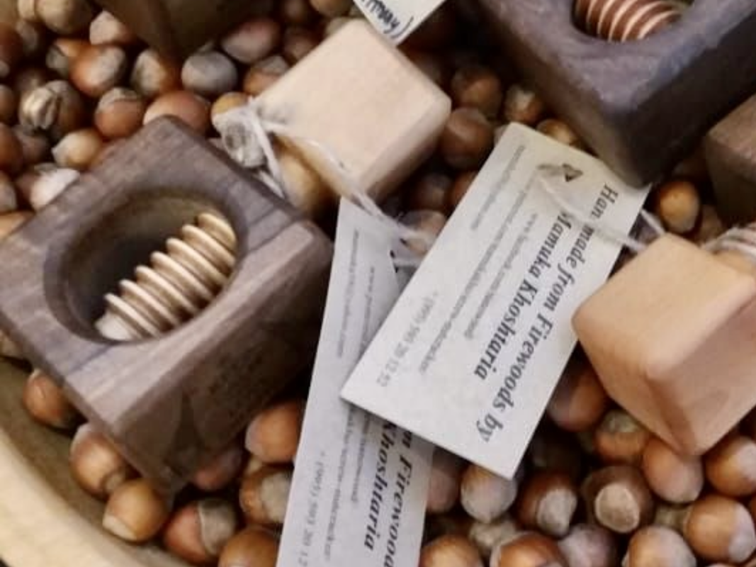

I saw this online and wondered if anyone on here recognises the thread form? Apologies that it’s woodwork related! I just wondered if it’s an existing thread that been used (Tap & Dies) or whether specific wood cutting tooling has been made to produce it. It’s a nice looking thread.

Looks like it could be a modified form of Acme thread with rounded off corners to stop chipping.
But this article makes it seem that guys working with the brown stuff just make up their own threads as they go along to suit themselves. LINK

It may have rounded off bottoms as well in which case it looks suspiciously like a 'knuckle' thread.

I’m well aware of the thread making tools available for wood but I’ve never seen anything that produces a rounded thread like that in the picture. I’ve passed the picture on to another wood turner and he’s also interested as he’s never seen anything like this either. The items in the picture were made in Eastern Europe so perhaps the tooling is unique to the area?

It's difficult to see from the photo, but it could possibly be a knuckle thread. This thread form has rounded crests and roots.

Yes, I’ve just found this. wink
**LINK**

Posted by Vic on 23/02/2023 17:20:16:
**LINK**
Interesting. Well spotted.
And it turns out there are standards for Knuckle threads. LINK Apparently they are also used on railway couplings and brake rods and fire department fittings owing to their high tolerance for dirt etc on the threads.

I suppose it depends hoe "Handmade" the products are, it would not be difficult to make a suitable form cutter and threadmill both parts on a CNC. Seems there are other nut crackers with teh same rounded profile thread rather than the more common 90deg Vee form that most of the tap and die box sets available produce
Also doable on a Routerlathe or a toolpost mounted spindle on a screwcutting lathe if you also use those to make your tap.
