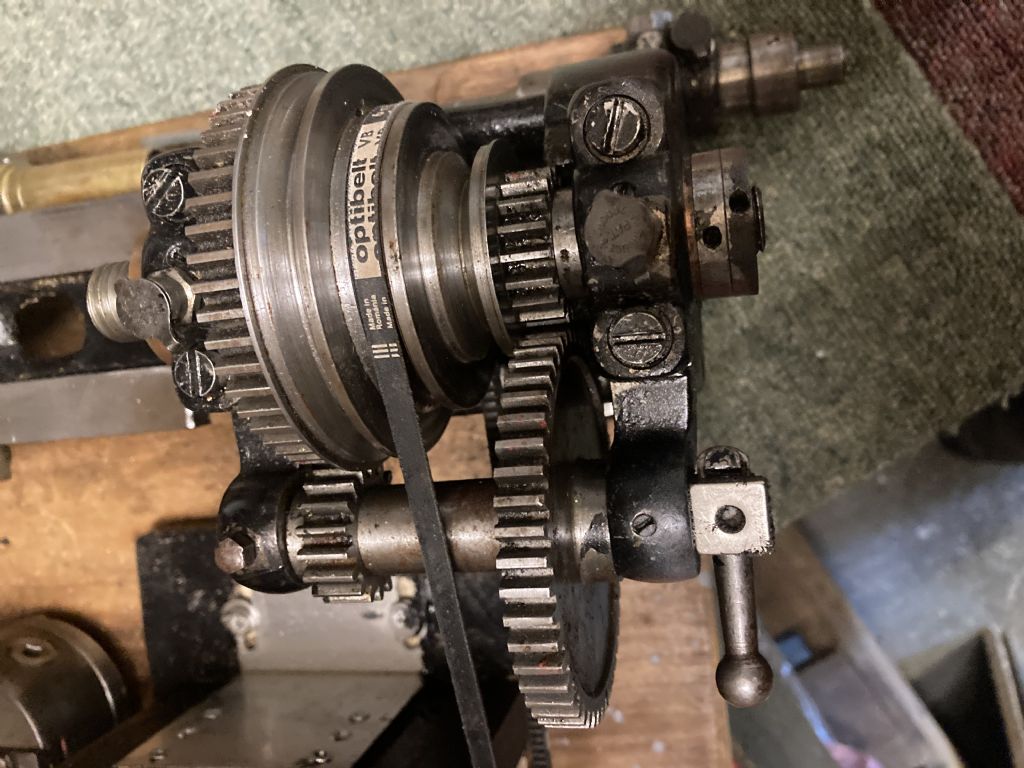

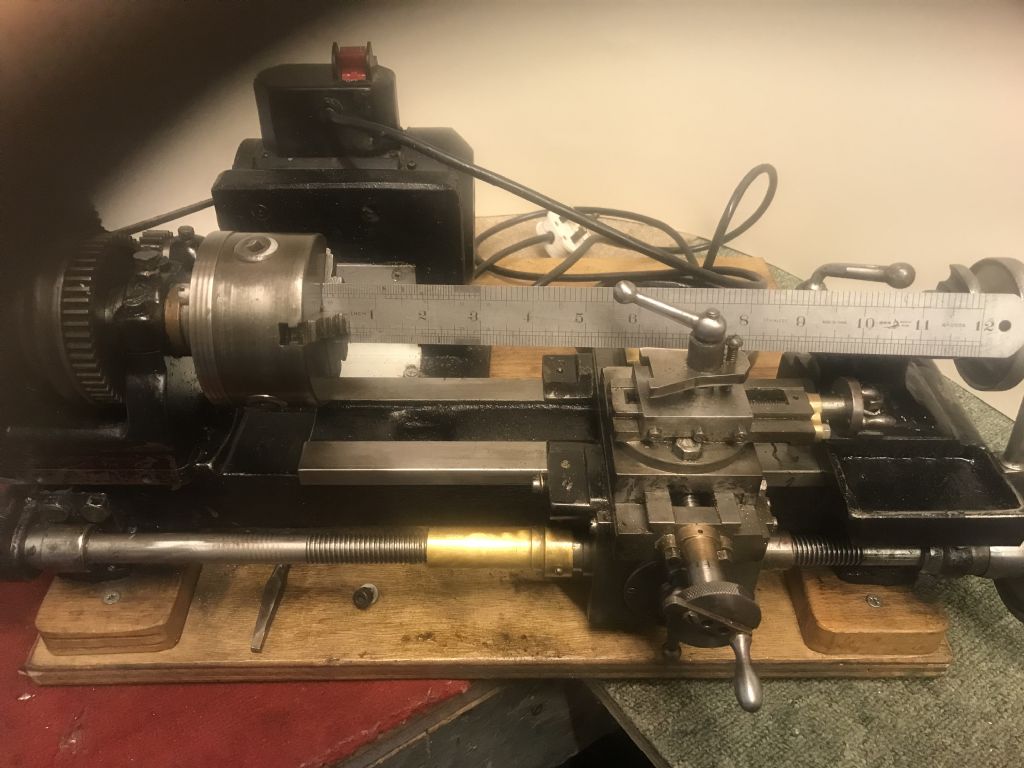

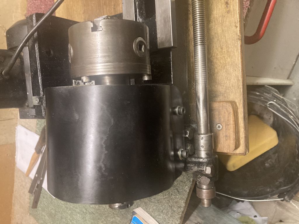

Can anyone help me to identify this lathe please.
Probably British made, 60/70 years old. I’m told it
had a power feed which has been removed. I’m having issues with the tail stock. The widest apertureon the tail stock measures a tad under 10mm. It’s a taper and the only way I could think of measuring it was to either buy a few tools of various sizes to see which fits, I haven’t done this yet, or to place various size drill bits in the aperture. It will not take a 10mm bit, the 9.5mm goes 10mm into it, the
9.00mm bit 20mm in, the 8.5mm bit 30mm in,
the 8.0mm bit 35mm in, 7.5mm 120mm in, the
7.00m bit passes right through the whole 140mm
length.
They’re no makers marks at all on the lathe.
If there other questions that need answering, or
different photo angles required then please shout and
I will do my best.
Ian from ACE Euro Trade who was very helpful
suggested I solicit your assistance.
Many thanks for taking the time to read this post.
Regards
Mick

Nigel Graham 221/02/2023 21:48:56
3293 forum posts
112 photos
Your measurements are half-way to identifying the taper!
Use them to work out the y-in-x change or the angle (the former is the value usually used) then compare that to the standards published in engineering texts.
If the lathe is British-made the taper is most likely Morse; and if so, centres, drills and other tooling is readily obtainable. The spindle should have a similar, possibly size larger, taper as well, allowing turning between centres.
I'm a bit surprised it has no name or trademark on it though that may have been on a plate long since lost. If you can find it, or someone identifies it, then look on Tony Griffiths' lathes.co web-site, our "bible" for identifying and finding the history of machine-tools ancient and modern.
It looks an admirable find, in good condition still capable of quality work.
That little tool-tray (I guess it is) on the tailstock is a neat touch!
Note what seem two tapped holes on the lower edge of the headstock. Do they hide grub-screws locking the headstock to the bed, or are they for an accessory such as gear-box, Myford fashion, I wonder.

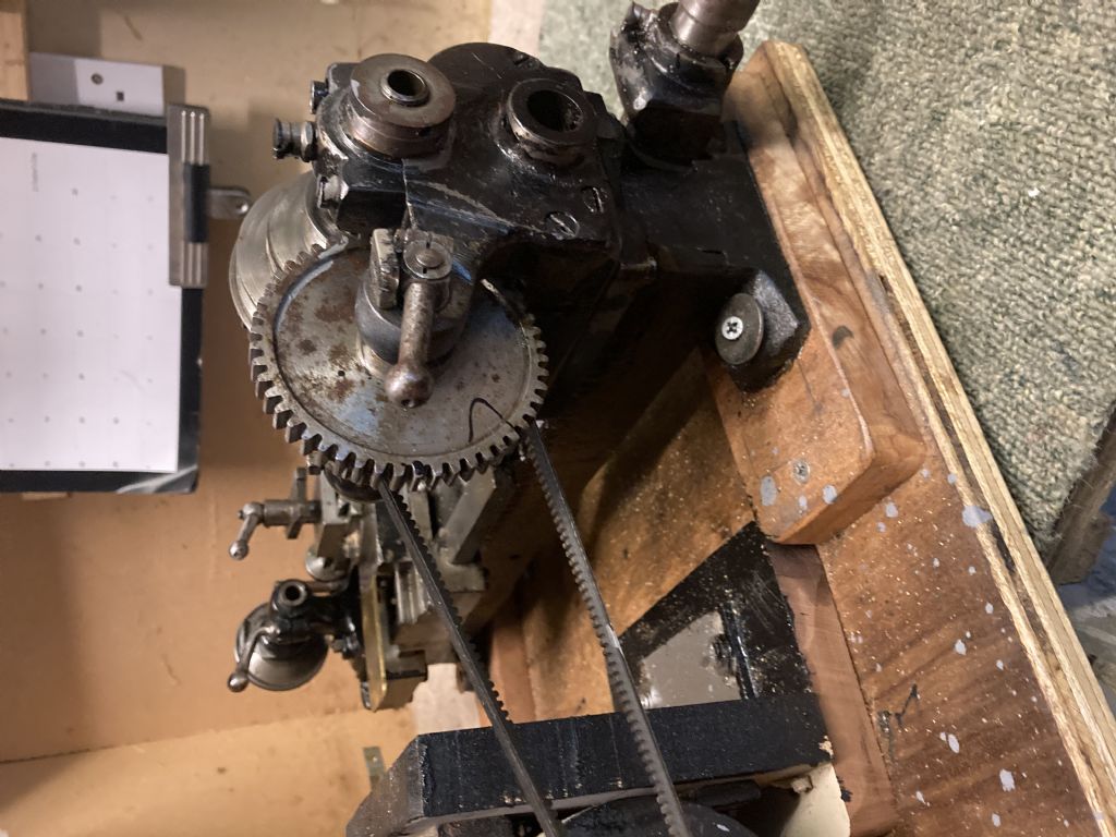

vic newey21/02/2023 22:33:53
avatar
347 forum posts
173 photos
The power feed simply uses the thread on the lead screw, all that's missing will be the gears and banjo which connect to the headstock mandrel and it should be possible to fabricate something to get it going.

Cute, well made, awesome looking pulley system which could fit a small fanbelt
Is it metric or imperial?
edit: count the TPI on the leadscrew, measure across the bed
Inquiring minds are interested, would love it to be British but it may be German etc

DiogenesII22/02/2023 06:55:22
859 forum posts
268 photos
Your description of the taper might suggest MT0 ?
0 Morse Taper
Brian Baker 122/02/2023 07:40:26
avatar
229 forum posts
40 photos
Greetings, might it be parts Houghton Cadet, which was normally supplied on a cast iron baseplate.

Posted by Michael Belcher on 22/02/2023 08:26:01:
Diogenes II - again no expert but there is a suggestion that it is a fraction small for MT0
It may be worth investigating Jarno tapers
John Hinkley22/02/2023 10:14:02
avatar
1545 forum posts
484 photos
I think MichaelG has hit the nail on the head (again) with his suggestion. Jarno taper is expressed as a ratio of 1:20, which equals 0.05. Plotting your reported measurements into CAD, gives an included angle of 2,864°. Tan of that angle is 0.050027, which is close enough in my view. Since the Jarno taper was introduced by Brown and Sharpe - according to Wikipedia - I would start my search on lathes.co.uk with that manufacturer.

vic newey22/02/2023 10:23:33
avatar
347 forum posts
173 photos

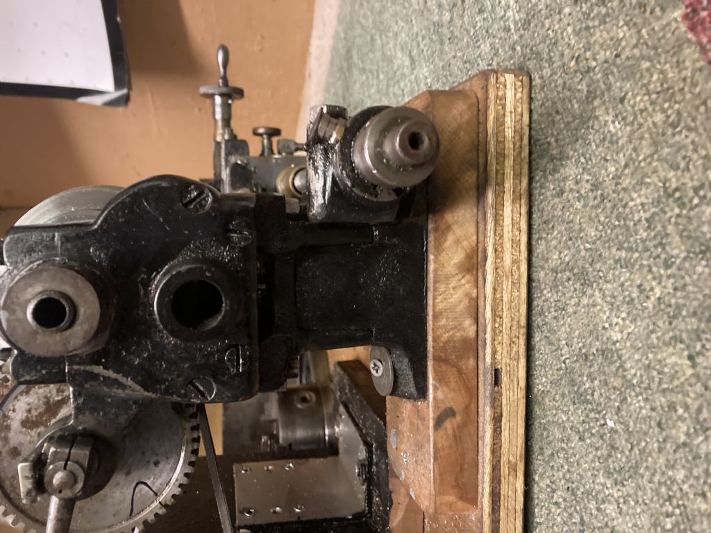

We need to see a full on view of the end of the headstock to see about the possibility of getting power feed restored one way or another. The main part missing is the banjo which fits on the bracket at the end of the leadscrew and has slots to hold the gear change wheels, these are common to many lathes and there are websites showing the making of parts such as this.
The missing gears can be adapted from other makes of lathe and are commonly seen on Ebay.

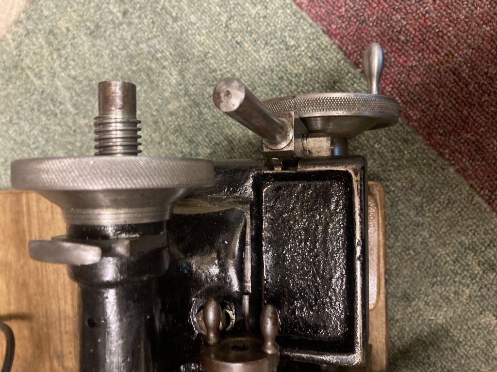

Me, again. After a brief, unsuccessful, search for B & S on lathes.co.uk, I tried again with South Bend. Your lathe bears more than a passing resemblance to the South Bend 8-inch Junior lathe. Main difference that I can see are the maker's name on the bed and mounting feet (can't see your lathe's). This might suggest it could be a clone made in Europe?
Edited By John Hinkley on 22/02/2023 10:31:44
Hopper22/02/2023 11:19:35
avatar
7881 forum posts
397 photos
It might be worth emailing some pics to Tony at lathes.co.uk and asking him. It does look similar to a Haighton Cadet but with many differences. But would be too small to be a South Bend clone I think, at 10-12" between centres and 3" across the bed ways.
If you have a dial indicator, you can measure how much the carriage advances in one turn of the leadscrew and thus get an accurate reading of its pitch. Looks in your pic to be about 10 and a half TPI so maybe not British but rather a metric machine from the Continent?
No sign of a gear on the end of the headstock mandrel to drive feed gears or screwcutting gears. Perhaps the power feed was some other arrangement, either belts or something like a windscreen wiper electric motor and gearbox hooked up to the leadscrew?

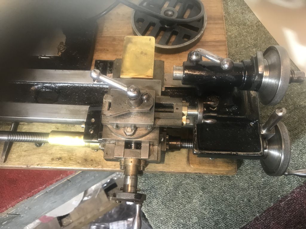

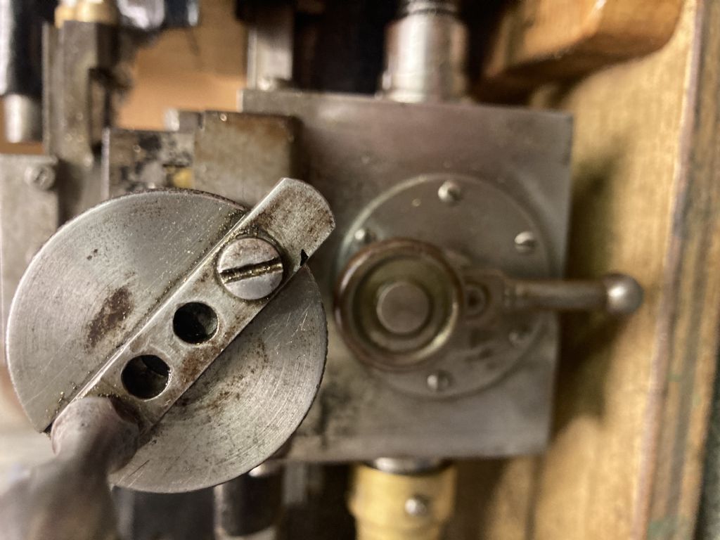

The cast iron tray on the base of the tailstock is very distinctive. Never seen that before. And what is that silver lever sticking upwards next to it, coming from down at the leadscrew end? Never seen that before either. Some more pics of that arrangement and of the other end of the headstock and of the apron on the carriage would be helpful too.

The silver lever sticking upwards on the rhs of the cast iron tray locks the tail stock chassis I believe.
can you just explain what the apron refers to and I will be happy to send pics if it.

vic newey22/02/2023 12:34:55
avatar
347 forum posts
173 photos
Posted by Hopper on 22/02/2023 11:19:35:
I

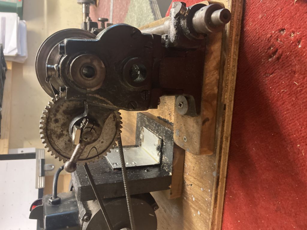

There does appear to be a large collar/ fixing place for the banjo and the leadscrew is seen protruding from it, very similar to a lathe of mine. what is strange is that the mandrel adjusting nuts are visible but the mandrel itself does not continue on for the fixed gear as is usual. The protruding part of the leadscrew would line up with the missing mandrel gear were it there
I can see how at some time in the past someone might have removed the banjo, possibly because they had gears missing and then it would get mislaid but how come the end of the mandrel appears missing, surely someone would not saw it off, an end view of the headstock might reveal some clues

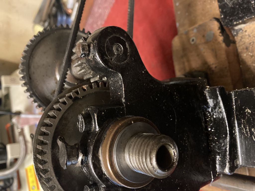

MickB22/02/2023 13:48:15
avatar
18 forum posts
30 photos
e77fb92f-62d7-4117-84a9-7185bf44f931.jpegdd30dbd9-dccd-41c2-b76b-7da4b9511378.jpegd1cf3642-d27c-4ad6-acd3-766676abd861.jpeg898afca0-9466-4083-8efc-47113b003ca7.jpeg7c2bfc2a-cce4-40ca-9f5c-42c2058b2664.jpeg3cdaa18f-f50b-489b-99fd-8bcad6945553.jpeg2848524c-bb3c-4f5f-afa6-9b710a74082f.jpeg10b9b62d-73c8-4a81-be42-42e1cb4bb09a.jpeg10b9b62d-73c8-4a81-be42-42e1cb4bb09a.jpegMichael & John - I will investigate the Jarno taper and get back to you.

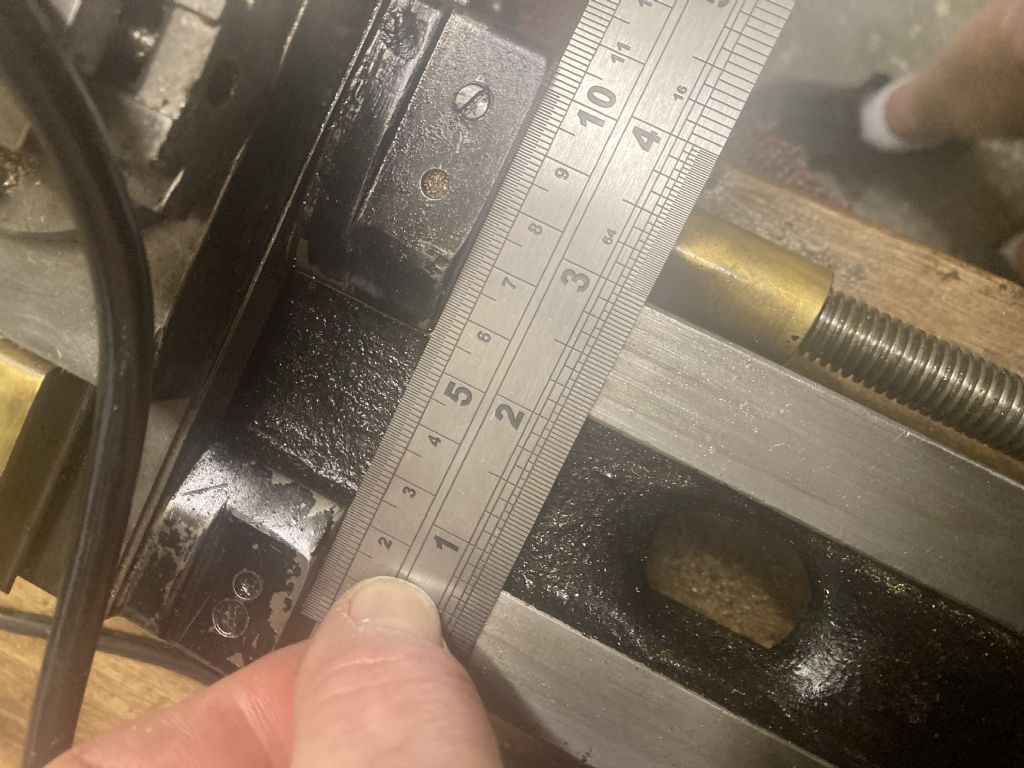

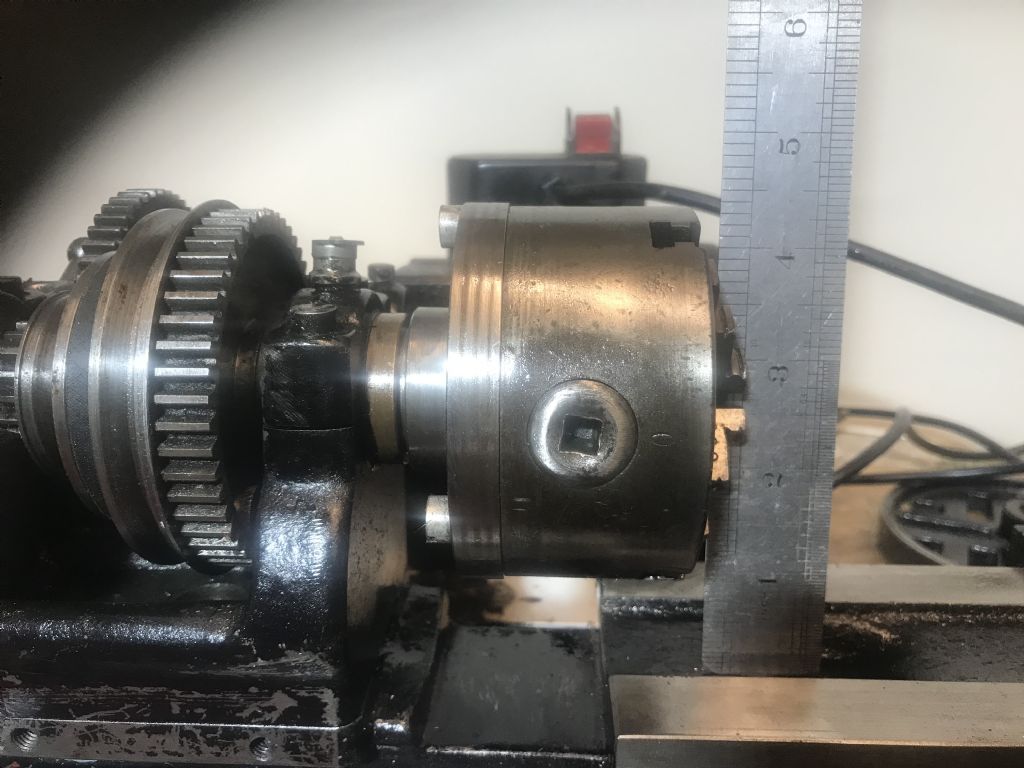

Vic - hope the pics are the correct ones for you to take a look

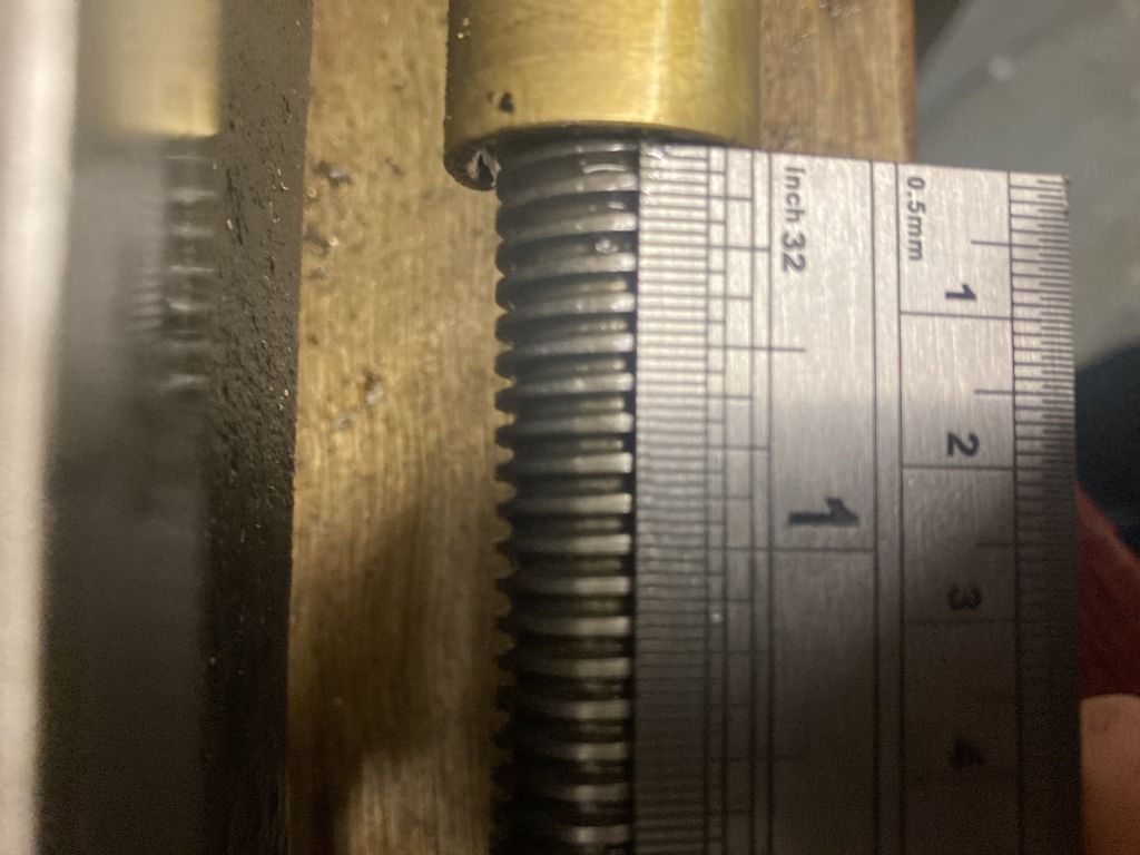

Hopper - I don’t have a dial indicator but I can tell
You that 3 complete turns of the lead screw = 5/16”
Of movement. I’ve attached a new pic that shows 10TPI which I’m fairly confident is accurate, together
With further pics of the silver lever as requested
I really appreciate all the opinions and time .
Many thanks
MickB

4 inches across the bed and 10TPI, nice spindle hole size

vic newey22/02/2023 14:23:53
avatar
347 forum posts
173 photos
Thanks for the additional photo's and don't worry about us using our time to help, we are enjoying it!
I'm even more convinced there was a banjo on this lathe, apart from the end of the leadscrew casting having a location for it, the hole below the mandrel possibly being for the leadscrew reversing mechanism although a bit large for that but who knows, it's there for something and has a machined flange.
The way to get around the missing mandrel gear would be to utilise some kind of fitment inside the bore to extend it and hold the gear, maybe you would sacrifice being able to push lengths of rod through the mandrel but maybe you still could but reduced size depending on what you fitted to hold the gear
Ady122/02/2023 14:59:04
avatar
6137 forum posts
893 photos
An early perfecto?
The headstock casting is very perfecto, (not at all "German" -)
Edited By Ady1 on 22/02/2023 15:13:46

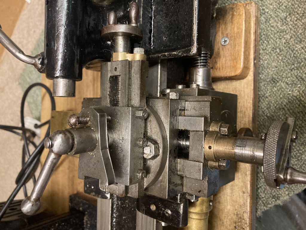

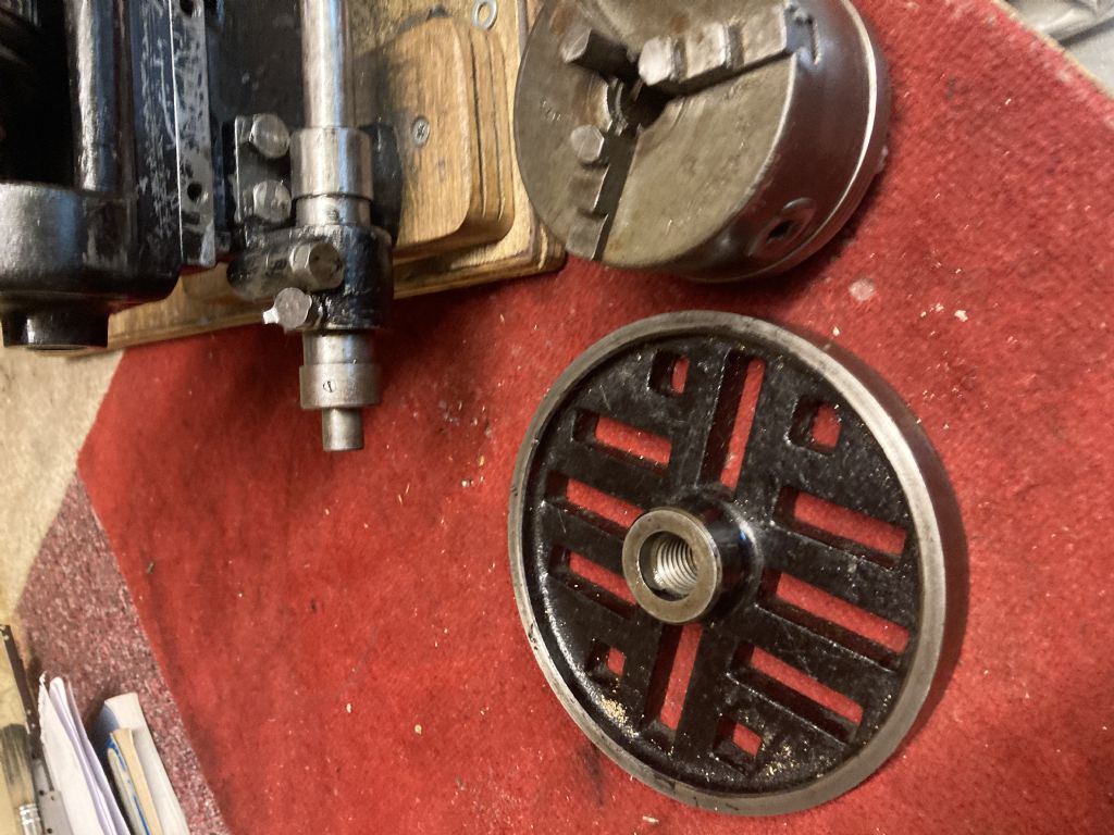

MickB22/02/2023 16:01:00
avatar
18 forum posts
30 photos
All round shots of the head stock if that helps.
Putting all my cards on the table I do struggle to
understand some of your posts as you are all very.
knowledgeable about the subject and I am anything
but. No idea what a banjo or Mandrel is in this
context but I will continue to try and follow as best I can.
