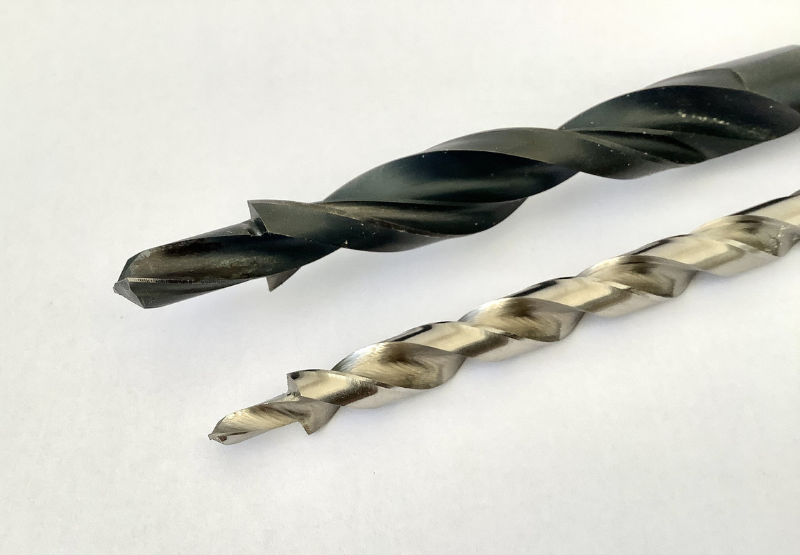

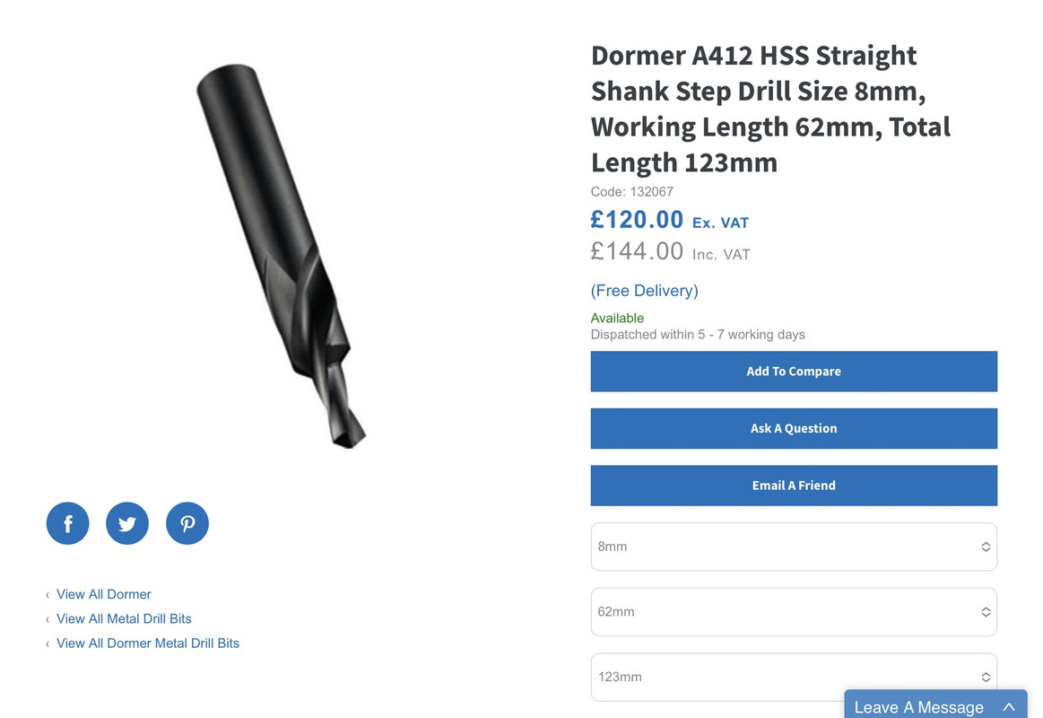

At the price shown for a Dormer step drill I can see why you want to grind your own. As they are so expensive I guess they become economical for production jobs as you avoid the counterbore operation. The drill modified as in the picture was widely used in our tool room for producing a counterbore but of course the hole needs drilling first.

That is not the case with the few that I have. The flutes are the same size all the way down. wink 2
For my use, reducing the tip of a 27/64 drill bit down to 15/64 will leave more than enough flute left to clear the work.

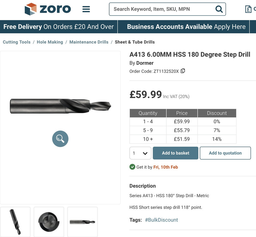

Yes they are expensive, look at the cost of this one! Free delivery though. face 23

Well there you go. They just look smaller because the outer part has been ground away. When you think about it, the flutes still have to go down to the size of the chisel point.
Still seems like an awful lot of HSS to grind away with a mounted point in a router, with an interrupted cut over the flutes. That kind of grinder set up is usually for taking a few thou off for finishing purposes. You might be better off to make up something to hold a pistol drill up square to your six inch bench grinder so the drill rotates the bit and the six inch grinding wheel does the work. I imagine it would go a lot quicker that way.
