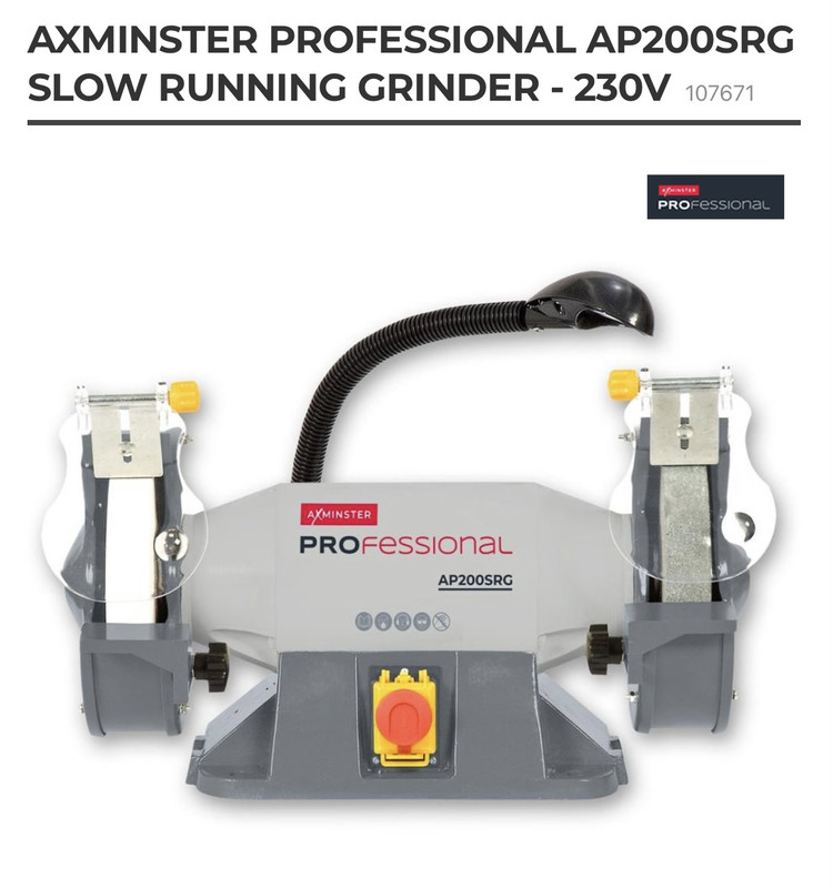

I asked someone what the point was and he said “it just takes twice as long to grind anything”. I should add that he kept a straight face! smiley I understand these may be aimed at wood turners. I’m not sure why as the majority of wood turning tools are HSS. I’m happy using a standard grinder and a belt grinder, I just wondered. Any opinion?

The angles on a wood chisel or gouge may be 25degrees where as a lathe tool could be 80-85 degrees and are therefore not overheated so easily. Plus if my Tormek ran that fast it would through all the water over the workshop.

A wet stone grinder such as the Tormek is another beast entirely. I was asking about a slow speed grinder. thinking
An example:

So-called low speed grinders seem to be rated at 1400rpm which is not all that slow. But they tout it as creating less heat build up when sharpening tools, which as Jason said would be more critical on fine woodworking edges than 85 degree lathe tools etc. I will have to check my ancient bench grinder next time in the shed to see what speed they used to run at before the marketing department got involved. I would have thought 1400 pretty standard for a single phase motor but maybe not in the case of the type used on grinders with no start windings etc.

The Axi one shown is really a half way house between a standard grinder and the very slow* watercooled ones. Fast enough for initial shaping on the grey wheel but slow enough not to remove too much metal when using the white wheel to just touch up a tool that has simply lost it's edge
Motor speed is a bit irrelevant as the diameter of the cutting stone will play a part in the cutting speed. This is another reason for the Tormek having a slow rotational speed as at 10" dia the surface is moving faster than say a 6" grinder with the same spindle speed. The woodworking tools like a flatter grind hence the larger dia wheels or flat belts like the Sorbey.
The Axi description says almost the same as my reply yesterday- smiley
  • Especially suited to the edge tool grinding needs of the woodworker or turner
  • Slow running speed of 1,425rpm, less chance of overheating the tool

Bill Phinn05/12/2022 14:22:50
1076 forum posts
129 photos
I've had the Axminster 8-inch slow speed grinder for a week. I bought it to accommodate the CBN wheel I bought from them only a few days prior to that. My reasons for buying a CBN wheel are set out here.
I can't presently recommend either this Axminster slow-speed grinder or their CBN wheel. I'm awaiting some replacement parts before I decide whether I'll keep either.
Problems are as follows: whilst I can get the supplied white stone wheel [the one out of the two stone wheels supplied that I want to use] to run so true that no lateral wobble is detectable by eye, the CBN wheel with its special CNC-made bushes has at least 0.5mm of lateral wobble that can't be rectified no matter how the bushes or the wheel are rotated before tightening the lock nut.
The shaft of the grinder is acceptably straight, with only 0.02mm of runout, so the problem is probably either the bushes or the wheel or the lock nut, or a combination of all three. Axminster are sending out replacement bushes to see if it cures the problem, but it's turning into a rather long wait for these to turn up.
I've tried placing cardboard washers between the small shoulder on the shaft and the inner bushing, as well as underneath the locknut, and this reduces runout by about two fifths, but it's still unacceptable runout in my view for a wheel that I bought specifically to be able to use the side for grinding drills on.
You would think it would be the other way round with the wheels - that the stone wheel with its crudely cast bushings/washers would be the one that was difficult to cure of wobble, and the precision turned CBN wheel with its CNC-made bushings would be dead straight, but sadly that's not the way things presently are.
ETA: I forgot to say that with both wheels installed the grinder vibrates horribly when powered up. If only one wheel is installed [doesn't make any difference whether this is the stone wheel or the CBN wheel] the vibration reduces considerably.
