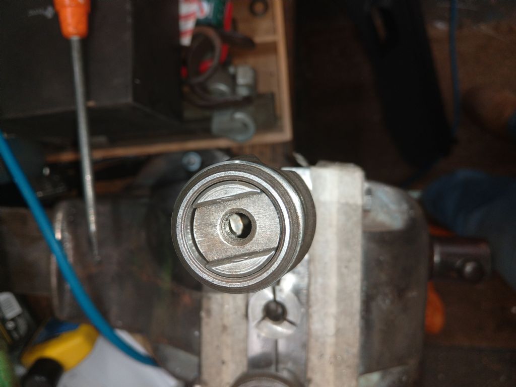

I've obtained what appeared to be a complete outfit of an Autolock type Chuck, full set of collets and full set of threaded inserts all in the original box. It was something of an impulse buy whilst looking for something else entirely...
However I'm totally unable to figure out how it operates, it looks nothing like the more common "Titanic II" or Clarkson systems, and I have a sneaking suspicion that what I have is a very complete set of the correct collets but absent some other component(s)
My understanding of how these style of chucks work is that
  1. the threaded inserts (or collets with an internal thread) go into the chuck first and are prevented from rotating by some internal feature of the chuck body.
  2. The collets go in next and butt up to the threaded insert.
  3. The external nut on the chuck is closed to hold the collet and insert in.
  4. When a threaded endmill of the appropriate size is screwed in, once it bottoms out on a stop in the chuck body any further rotation is driving the threaded insert down against the external nut, causing the collet to close.
However:
  • The collets are unthreaded with a smaller diameter than the threaded inserts, and sit so deep into the chuck that the can't touch the external nut and engage their taper, whilst nothing in the chuck body provides an anti-rotation feature. Also the taper is the wrong way up to be effectively closed by the action of a threaded endmill.
  • The threaded inserts are a perfect fit on top of the collets, and in the chuck, but that setup would prevent the threaded endmill from actually engaging in the collet at all.
[For further descriptive photographs click here]
I'm totally stumped, if anyone had used one of these before and can give me a steer on if the parts are correct (and if they are, how I use them effectively) it would be most appreciated.

Opening paragraph is a clear and concise description of how the beast works. Looks like you are missing the second sleeve, part 18 on the diagram that actually closes the collet.
Clearly this style of cutter holder was designed around the use of conventional draw in style collets with the closing taper on the back. Hence needing the closing sleeve to opearte it.
Possibly designed that way to get round the original 1943 Clarkson patent which covers most of the possible variations of the screwed into a collet end mill holder.
**LINK**
https://worldwide.espacenet.com/patent/search/family/035523252/publication/CA414067A?q=Clarkson%20Chuck
The separate closing sleeve and, possibly, the fixed point in the back would take the Osborn design clear of that patent.
Its not clear when, or even if, the Clarkson system as we know it was patented. If Clarkson relied on the original presumably Osborn switched to the simpler Clarkson concept with external closure on the collet.

The second sleeve mentioned in that patent and shown in section, appears as if it is just part of the bore in the chuck I picked up; that explains why the design didn't make any sense perfectly.
It's obviously an extremely close fit, and has been locked in place by oxidised oil or similar, how to get it out on the other hand may be a challenge.

Firstly, apologies for not reading the thread, will be back later to read all. Scan reading, I don't think you have a solution, but I can see a few assembly errors, and youve missed a part that inside (it does need to come out, it will help you piece it together!)
I have the same set, instructions are printed on the lid (or perhaps on a card in the lid) - I will have a look when I'm home and or photograph them if needed.
Observations...... your photo showing a view inside the chuck - there is a hardened steel outer ring in there, fish it out and it'll all start making sense, as will the following paragraph. Also note, that bit at the bottom with the point, has machined flats on it's OD, these engage with the notch in the threaded part..... which you've put in upside down in your photo, notch faces in, rotate till it engages.
The shot of everything standing on the vice jaws, you collet is upside down, face the flared edge away from the notched/threaded part - the taper on the end engages with the taper in the hardened steel outer ring that you've left inside the body as per previous para..
The collet sits against the nut, as the endmill rotates, it does so against the hardened pin in the base, the notched/threaded part keying with the flats cannot rotate and the thread pushes it downward, which in turn pushes the hardened steel ring downward, this forces the outer tapered part to engage with the taper on the end of the collect, nipping the endmill.

Success!
Just popped out to the workshop to put my welding PPE away (was out yesterday evening/night doing some welding elsewhere) and thought I'd have another crack since I was out there.
Filled it up with EZ-Start whilst I sorted out my putting away, then as that had drained/evaporated did the same with penetrating oil for a few minutes whilst listening to R4.
Then used a length of brass rod as a drift to push the central pin out (it's a perfect light transition fit by feel), which revealed a lip formed by the bottom of the sleeve overhanging the relief for aligning the pin.
Using an allen key as a stiffer alternative to a pick tool i was able to get enough purchase to get the collet sliding slightly, making space to put one jaw of an extra-long nose needle-nose pliers in and hook the serrations on the edge of the collet, giving me a good handle to pull firmly, and out it came just like that.
From what I can tell the sleeve is extremely close fitting to the bore and just a tiny buildup of crud in the bore results in it binding tightly.
It wouldn't go back in initially, but little more than wiping my fingertip round the bore was enough to remove the detritus and restore it to a perfect sliding fit (I can't get over how well made and well preserved this thing is, a number of the ground collet and insert surfaces will wring together from their smoothness).
