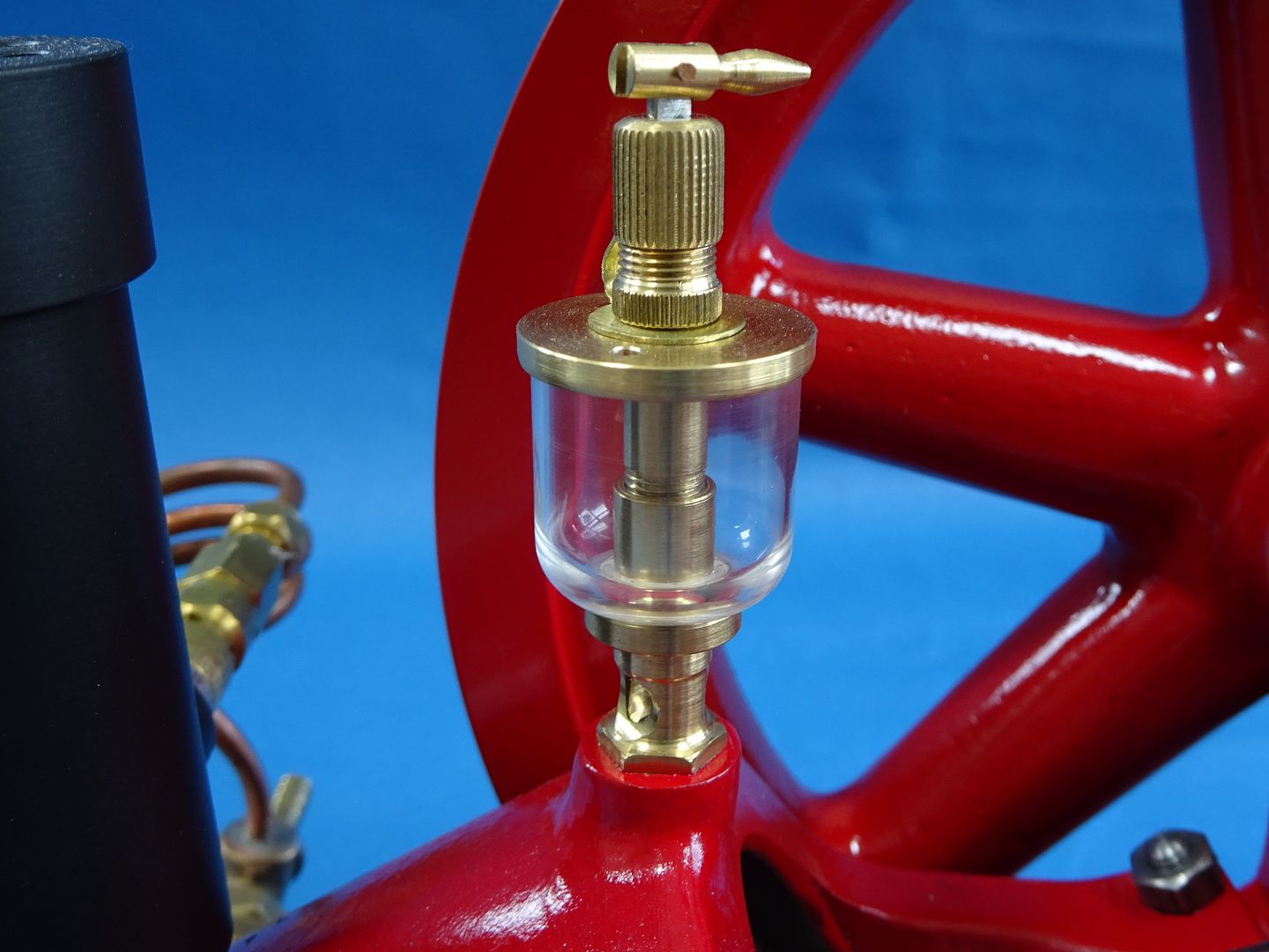

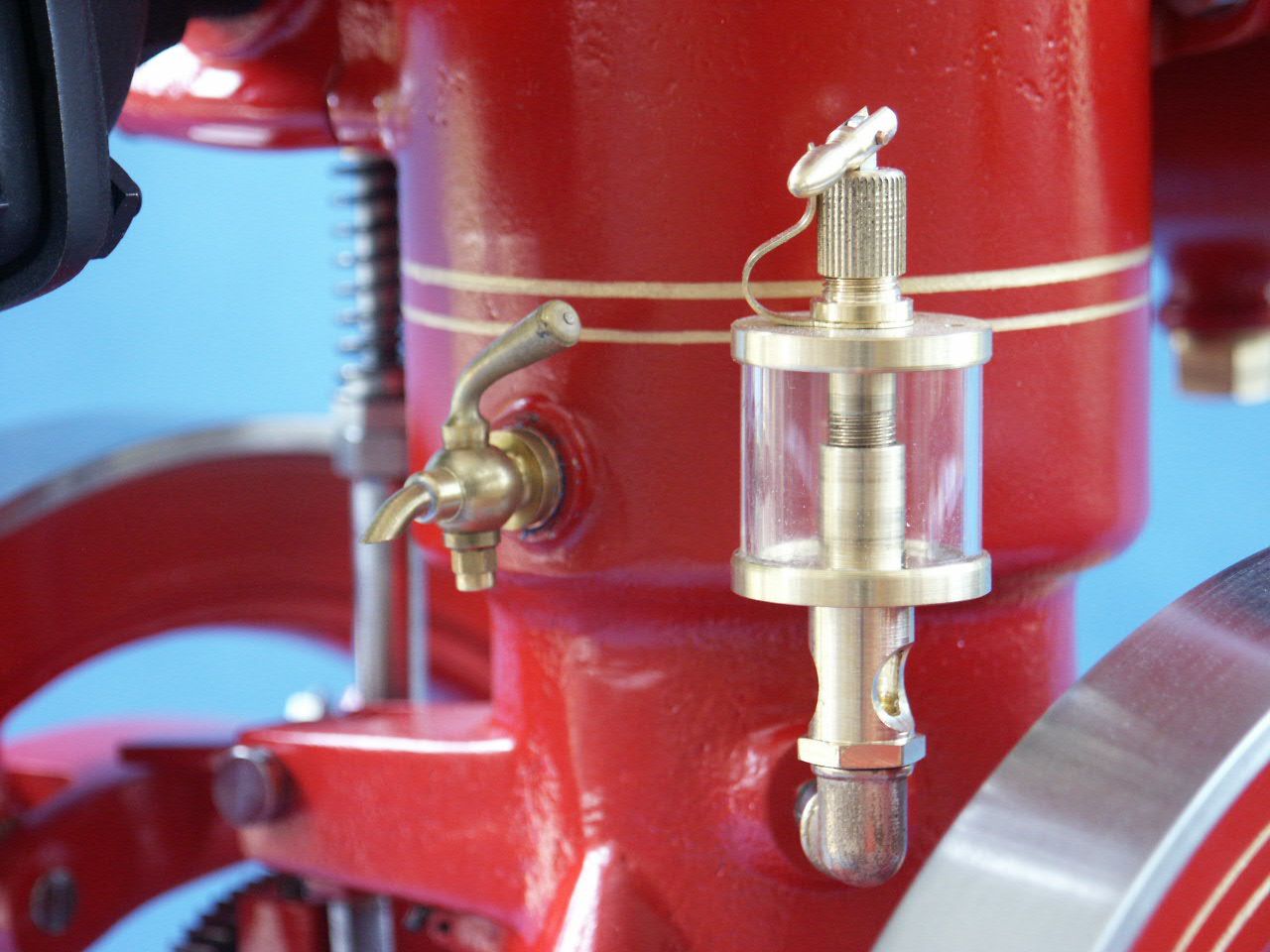

Hi Doc, No I wouldn't say you are overthinking this but would agree with Nigel that as you have them they appear rather tall. However, when you look at images of engines or those in museums there is an absolute myriad of design of oilers to choose from so you can pretty much pick and choose.
Here are some pics from mine made for the Waller engine.
I don't 'turn' the 'glass' merely slide it on a piece of ali turned to suit as a mandrel and just part it off using a sharp pointed tool. This gives a tapered edge where the glue can form a seal. I use the thick super glue, the thin can create fogging in the glass (same as on a canopy)
The bottoms can be threaded but I turned a fine taper on these so no pressure is put on the glass in a turning movement when removing
Some of the other oilers made for secondary shafting etc
This is the main on the Waller pedestal bearing
And these are the very first made on my Twin Vic
That should give you some more ideas but as said you are on the right track, just cut the length down a bit.
Best - R

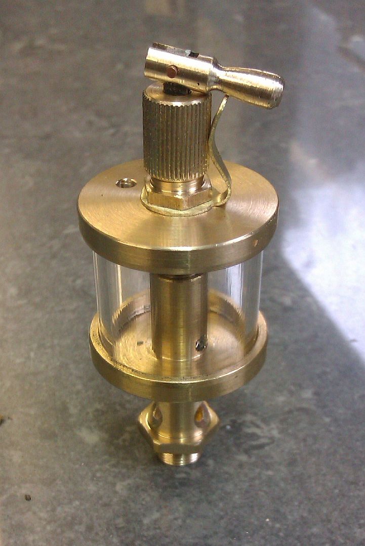

Full size use glass tube with no spigots which Ramon's tube replicates, the top and bottom have a lip that just overhangs the glass. If you do make from acrylic rather than thin wall tube then you can also shape the glass, there were some nice designs about.
They were sealed with cork washers but that is because they had a vertical centre section and the top could be screwed on to apply pressure to the cork. At your scale that can't be done but I do them that way on the hit & miss engines.
Also if just sticking them together don't get carried away screwing down a needle as it's likely to pop them apart. Full size and large models use a cam type action much like a bicycle axle quick release that lifts the adjustable needle to open and close the flow with just a light spring pressure to hold the needle into the hole when closed.
Full size also have a vent and or filler hole so you don't upset the needle setting trying to fill through that.
As Paul says many had an open or glass enclosed neck with cutouts so you could actually see the drips, probably too small to get the glass in but a shaped neck and cross hole could just about be squeezed in if wanted.

Nice work as usual Jason but hard if not nigh on impossible to replicate in Docs much smaller scale especially the lower sight area if you want it to actually work. The flip over lifter would be too - good looking oiler thoughyes
I've tried to do this Paul but its not worth it at this scale as the dimensions are so small the oil does not move so it's a simple replication at best from a metering point of view.
Bernard, though real glass can be used it's fraught with difficulties in cutting accurately and cleanly piece to piece. Besides the constant breakage the pieces of broken glass become an issue too and the wall thickness makes for small volume. The clear plastic tube is so much better from all aspects on these oilers.
Jason, I doubt very much if the joint is properly glued the needle screw would have that much jacking force - it's only screwed down with the slightest of force between finger and thumb - never had it happen so far though a clumsy movement of my hand once knocked the glass and the top off one. If that happens clean the traces of super glue off as CA does not like sticking to itself that well.

Yes hard to do in the smaller sizes ( though expect someone has) but I was trying to show Doc what the full size looked like and then upto him how to scale it down both for looks and practicality.
I've done similar to you where needed as well as open cups, cups with lids (screwed or pushfit) cups with cocks for cylinders, fat pots and also several where the cap has a cast box or trough to put the oil in agan with and without covers. remote boxes plumbed in with copper pipe, etc So many ways to skin the cat but you just need to find the right one for the job.
