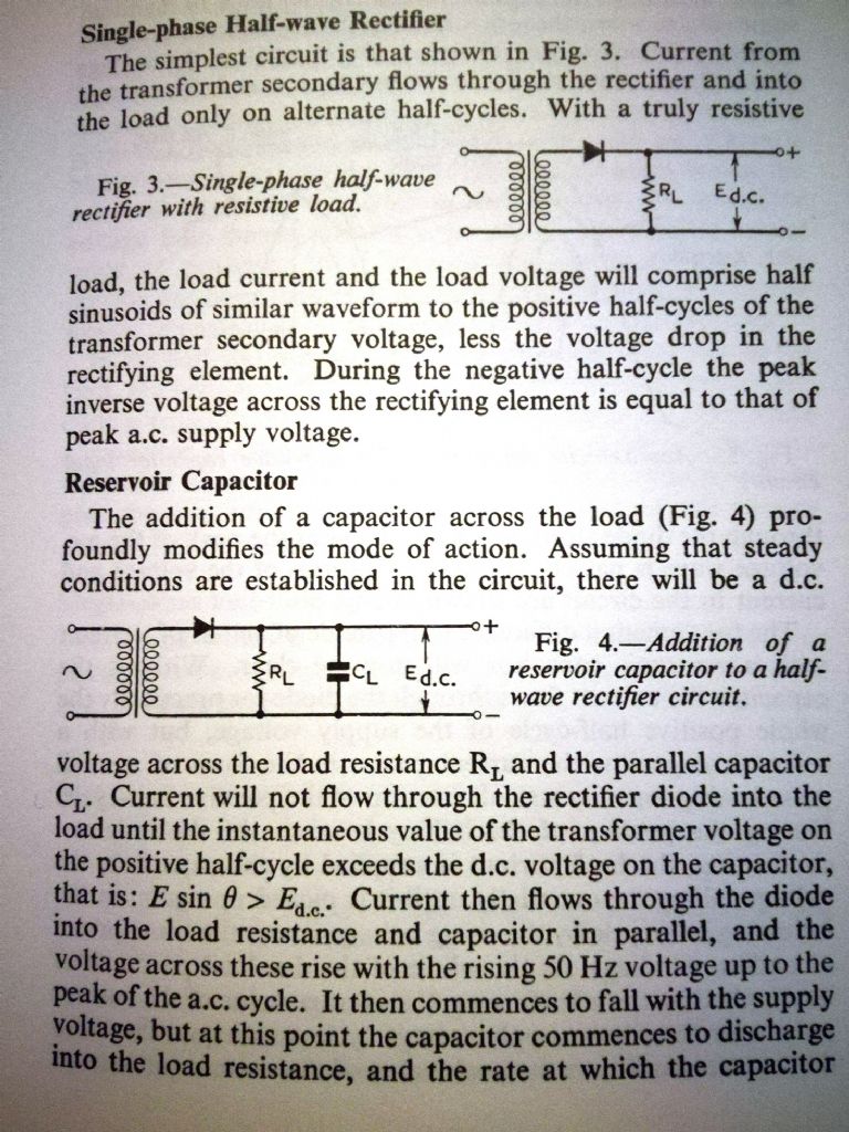

Hi, well according to this, you only need one diode for a half wave rectifier and Gerry's diagram looks a lot like the bottom one.
Regards Nick.
