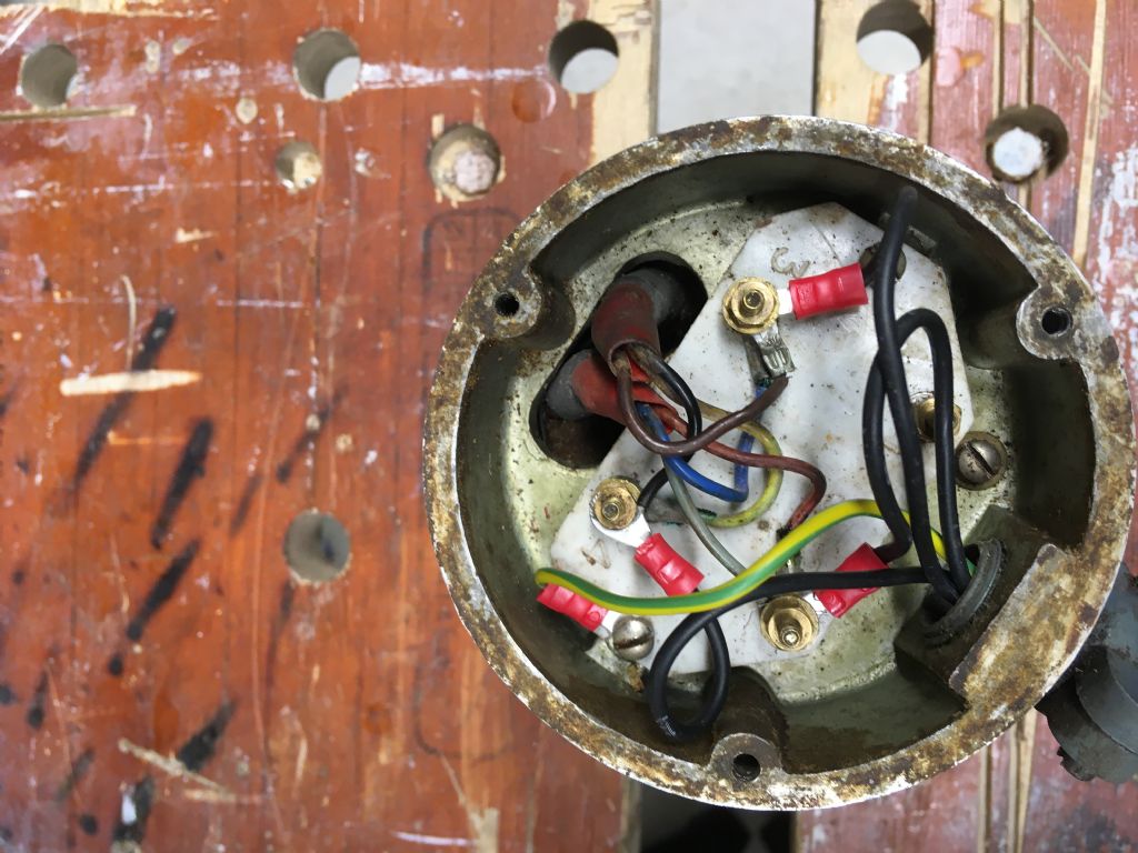

hello everyone. I would very much appreciate some help in wiring up this coolant motor so i can find out whether its still functional. It came as an original part of a Harrison 11 inch lathe, in what was a complete coolant unit. The unit had obviously not been used for years, had long since dried up, and the tank is pretty rusted. The motor was covered in orange dust, ( a dried algae or some such?) but once cleaned, it rotates freely. i opened the motor cover intending to wire up a VFD to it, but can't be sure how its wired.The motor label indicated 220/380V, i.e. i assumed its dual voltage, and my VFD is 220V 3ph. As you can see from the photo, there appear to be 3 wires into the motor which i assume to be the three poles. they appear to have a common terminal (1). the three poles are wired to 2,3,4 i guess. The incoming power leads ( red white and blue) are wired to 2,3,4. Would i be correct in assuming that i wire the VFD into terminals 2,3,4?.
I will of courser earth the body of the pump into the VFD. Having removed the pump from the lathe it has no grounding currently.
Many Thanks for your help!

It's a bit of a jumble in there but it looks like you have red white and blue incomng power each on one post with one motor lead connected on each. The bottom post has three wires connected to it, that makes it the star point so your pump is configured for 415v.
Now, being just a coolant pump there is every chance that wiring your VFD to 2,3,4 just how it is will work just fine. Motor power will bevastly reduced but if it pumps enough coolant that's all you need. To configure the motor for 240v 3 phase (for your VFD) you would release the three wires on the No1 post and bring them each to 2,3,4 to form a delta. You can do this easily using a multimeter just split them all off and figure which is the other end of the coil on 2, connect it to 3. The other end of 3, connect it to 4, the other endof 4, connect it to 2.
If you haven't already bought a dedicated VFD for it though save your money and try it with a capacitor, they usually work no trouble at all.

If you understand a DELTA configuration then each terminal should have the start of one coil and the end of the preceeding one, therefore 3 terminals. In this pic it appears that No1 is star point, the ends of the 3 coils and 2, 3, 4 are the other ends. Checking continuity identity the ends of the 3 coils and bearing in mind the first statement a tail to each start, in one out to the next to form the triangle or DELTA. IF it rotates in the wrong direction the swap any 2 incoming wires. It is currently wired STAR for 415V. If your using a VFD then follow the instructions. DO NOT forget the earth to the machine !!! Good Luck Noel.

Thanks for the prompt response. it makes sense now. so if i rewire the terminals delta, as you suggest, then the input power leads red white and blue should be wired respectively to the terminals 2,3,4 leaving 1 with no connections. Is that right? Forgive my obtuseness, but i do find 3 phase a little scary.

I think this circuit covers what's needed.
At the moment, six wires emerge from the motor and are wired in star for 380V as shown on the left.
The 6 wires connect to 3 coils, so it would help to identify which pair is a coil with a multimeter, perhaps labelling them because the existing wire colours are similar.
Once the pairs are identified, wire as shown on the right for delta 220V. Terminal 1 isn't used in delta configuration.  Doesn't matter which coil is between each pair of terminals.
If the motor happens to run in reverse, swap one coil end for end, say that connected between terminals 2 and 4, though any will do.

If you have a winding backwards relative to the other two the motor will not run properly. Call the ends of the windings on the star point n1 for the nth winding and the other n2. Then wire 12 to 21, 22 to 31, 32 to 11. If the motor runs backwards reverse two of the mains connections.

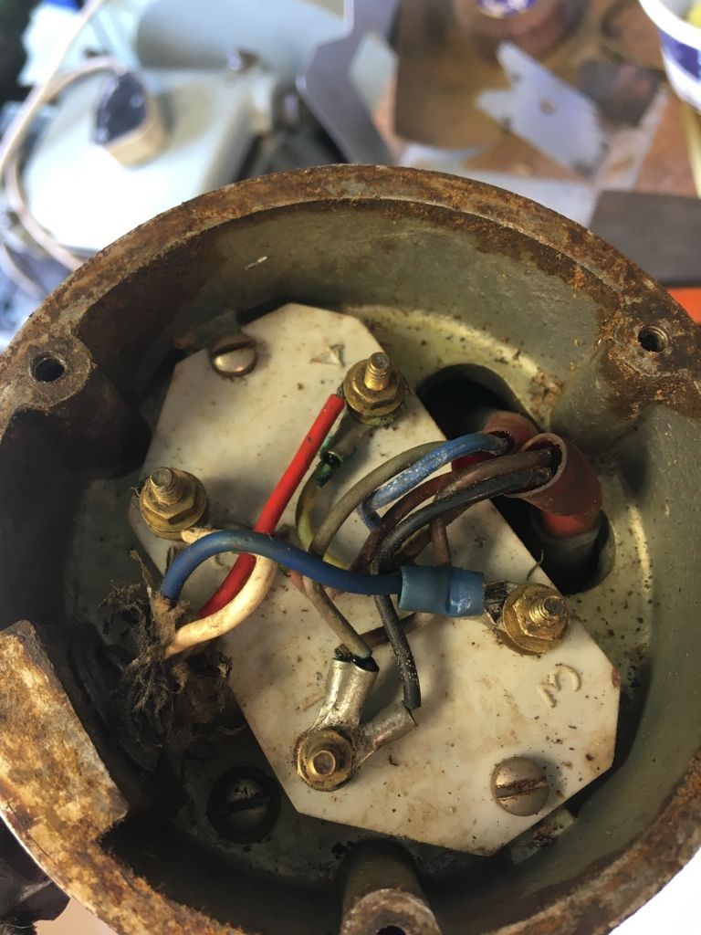

img_5005.jpgHi Everyone. Thanks to you all for your help. I wired it up as suggested, using my spare VFD. I tried to do a "proper" job of wiring up the VFD, because i have been keeping it for another project. I then connected it to the coolant pump, having identified the windings as you showed me. I had to reprogram the VFD from its previous installation, and when i pressed run and increased the run frequency, it ran! success!. The motor sounded a bit rough, but it hasn't run in probably 30 years or so, and it needs some TLC. I have decided, I am not going to be the one giving this TLC, as i have more deserving projects. This will go on an auction site i have heard of for sale to someone who can give it a good home.

The rough sound you describe could be 1 winding with the ends reversed.

It appears there are two groups of three wires from the motor winding which might be classed as start and finish. Identify with an ohmmeter which pairs are windings and connect start to finish in a ring to configure for delta (240)

Steve I think it's unlikely that you would have a problem with a reversed field it would require the wires removed from the star point and swapped around with a wire from a terminal and I'm not even sure that even that would cause a problem on this particular motor. I f you have rough running issues then it's more likely to be mechanical, maybe debris in the impeller or even corrosion. I had a pump where the impeller was completely eroded away and full of white powder.
