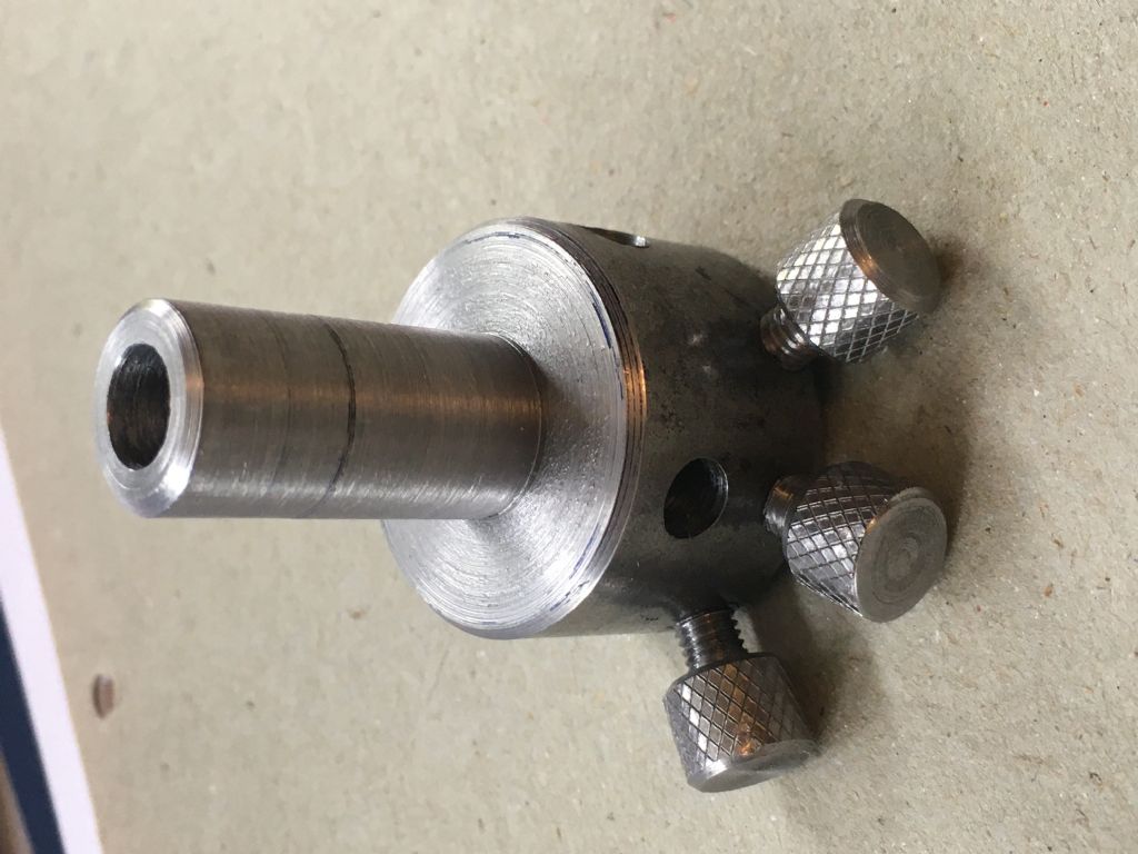

Steve Rowbotham27/04/2022 13:04:15
avatar
52 forum posts
30 photos
I have actually made the 13/16 holder (see pic) albeit with slightly bent screws. Based on the considerable advice above I will make the die holder support next and then use the die holder to thread new adjuster screws for this holder and then the larger (1 inch) holder. I will also reduce the turned diameter from 5mm to 90% as suggested. In terms of prominence, I purchased a tap and die set from a prominent dealer and have been very happy with the way the taps cut, the dies appear to be good quality so I think operator error rather than die quality is the issue. Many thanks to all who have taken the time to respond and help me on my way with such great advice, this forum really is a fantastic resource for a novice. Stevee149eaa5-c4d2-4213-bb15-bb99cd424921.jpeg
not done it yet27/04/2022 13:21:31
7517 forum posts
20 photos
I think you either did not mean that - or you need to read that post again.
