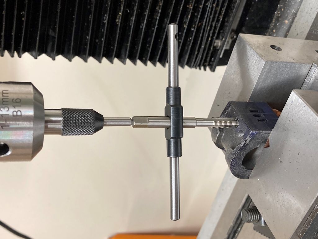

15/08/2022 15:34:12
Having tapped the few threads in the Oscillator 'freehand', with slightly questionable results in terms of perpendicularity (though it does run very well!), I was a bit daunted by the number of threads on the 10V. Using the advice given in this thread, and a direct message from Thor, I have now tapped the exhaust port mentioned at the start of this thread and am delighted with the result, and now feel ready to tap the remaining 20 threads in the cylinder. Thanks once again, till my next question, Steve

14/08/2022 22:55:26
Thank you for sharing the above wisdom which is all complementary and absolutely addresses my concerns of achieving perpendicular threads, some into blind holes, whilst also minimising the risks of stripping and tap breakage. I will definitely be making a circular tap holder for small taps, and am giving very serious consideration to making a UPT as a starter project, it does look like a very useful piece of kit. I have established availability of UPT castings from Hemmingway, but if anyone has unwanted castings I would be happy to purchase them. I have now asked several questions on this forum as a novice and been overwhelmed by the knowledge of forum members. There is a wealth of knowledge in the above thread alone, and there will likely be further contributions. Just a thought, but has anyone thought of collating the responses to beginners questions, which are in the main based on practical problems, into a publication of some form and so capturing the massive knowledge of forum members?

14/08/2022 17:24:48
I am seeking advice on tapping a 1/4" 32TPI thread into cast iron. I have just completed my first engine, a Stuart Oscillator, for which I tapped the same thread into the Brass standard using a set of HSS taps purchased from Tracey Tools for the task, and achieved a good result. I have now embarked on a Stuart 10V and have just drilled the cylinder for the exhaust and now need to tap the 1/4 32 TPI thread. I have not moved the cylinder since drilling and plan to fit the taps into the drill chuck and turn by hand whilst applying pressure via the quill. I have not drilled CI before, and now have a lot of holes to drill and tap down to 8BA and am nervous about stripping the threads. The 1/4 32 TPI taps are nice and sharp having been used once only into Brass. My questions are a) is using the drill chuck to hold the taps a sensible approach or would I be better off by hand, and b) should I use cutting fluid - there seems to be mixed views on this matter on the web. Any advice gratefully received before I press on.

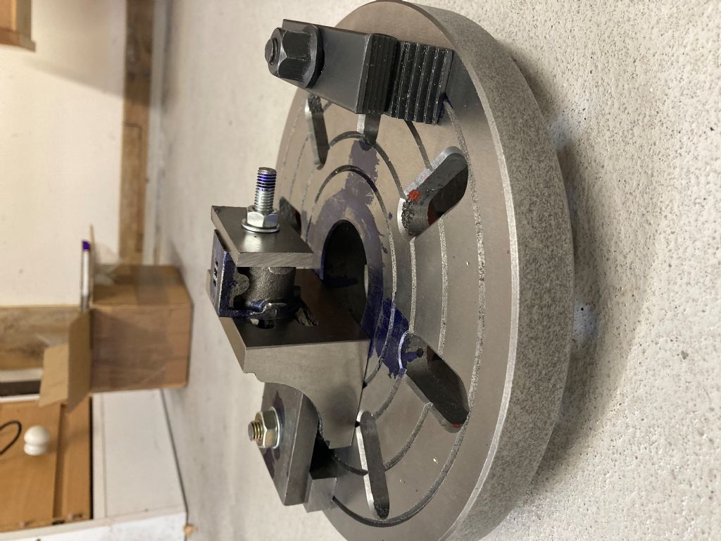

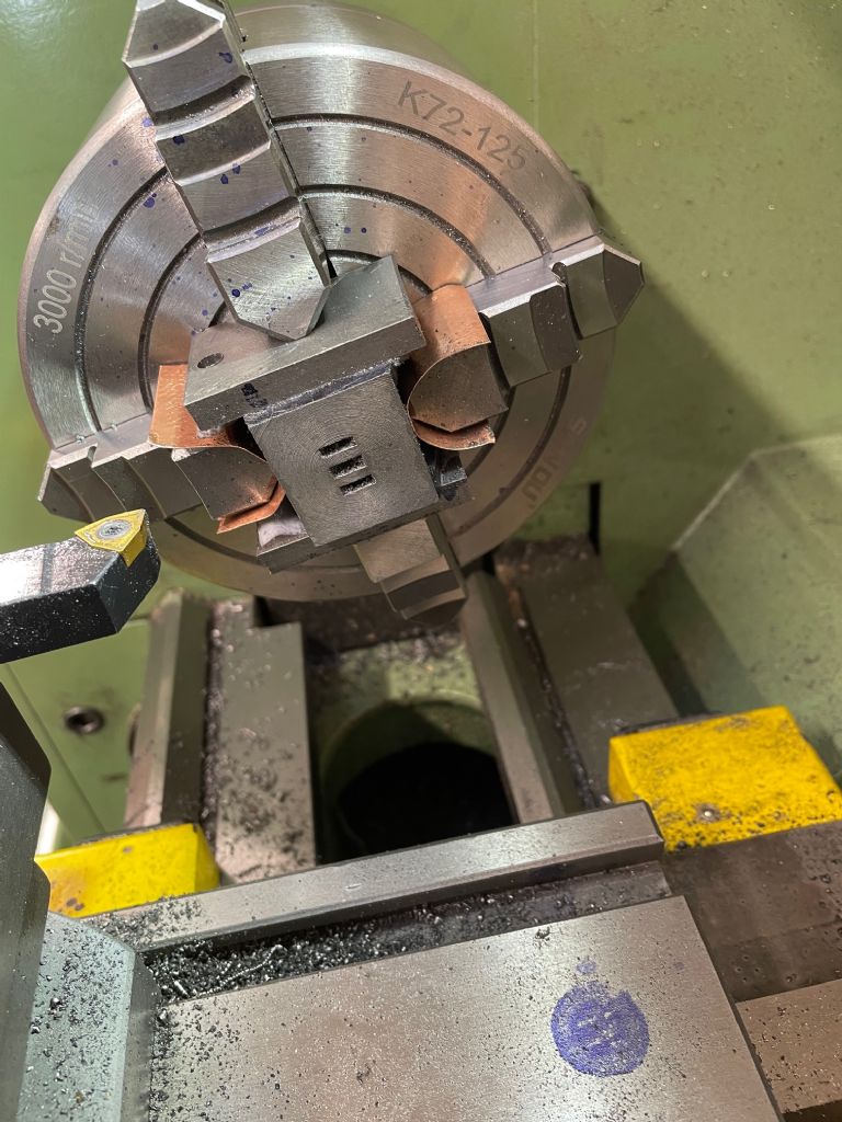

10/08/2022 19:35:34
Thanks all for your very helpful responses, which have enabled me to complete the cylinder machining satisfactorily with all of the tooling marks caused by the angle plate shifting thankfully being removed in the process. I started with the angle plate mounting approach as that is the method recommended for beginners in 'Building A Vertical Steam Engine From Castings' which details the manufacture of the 10V. I did think about using the 4 jaw but thought it may be difficult to achieve correct alignment due to the jaws getting in the way of the square, so went with the recommended approach. My problem was a small angle plate and large faceplate; locating the angle plate such that the cylinder was central to the faceplate meant that I couldn't bolt it directly so ended up clamping, and the bolt securing the clamp ended up closer to the spacer than to the angle pate as pointed out by Clive. I knew this wasn't ideal but thought it would hold - a key learning point here! Further to the above suggestions I had a go at setting up in the 4 jaw, inserting paper on the flange faces as suggested by Clive and having first ground off the hard skin as suggested by Hopper. I haven't yet drilled and tapped any of the castings as I decided to complete all of the facing and boring of the castings first so couldn't use the method suggested by Martin, though I do appreciate the effort of producing the drawing. I am very pleased with the end result, all square and dimensionally correct. I am now moving onto machining the flywheel casting, so stand by for more beginners questions!

10/08/2022 10:28:33
Having machined the 2 flanges and bore of the cylinder I now need to machine the port face. I set the cylinder up on an angle plate as per attached photo, and attempted the first cut, with the result that the angle plate moved and caused the tool to mark the face (I have circa 1/16 to remove so not a problem). I had thought to bolt bars either side of the angle pate to ensure it couldn't move but decided that would be overkill. So now my plan is to bolt the bars either side, but I am now worried that the cylinder could rotate on it's axis when the tool makes contact, and potentially cause damage I wont be able to rectify. Any advice before I proceed would be appreciated!

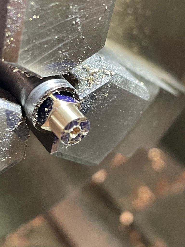

10/07/2022 21:18:17
Being new to ME it never fails to amaze me how many different solutions there are for a given problem, or how knowledgeable and helpful the folk on this forum are - this is the 4th time this year the forum have helped me solve a problem, and with multiple solutions to each. I decided to start with the slit bush method using the square stock provided with the Stuart kit, and got pretty good results as per pic. The accuracy achieved was such that there seemed no point switching to the 4 jaw. I now intend to try the other methods suggested as part of my learning process, and also to purchase a smaller diameter 4 jaw as I intend to focus on small modes initially and the need will clearly arise again. John, I subscribe to MEW print and online so will lookout for your article, though as you say the screenshot is self explanatory. Thanks again, will no doubt be back soon with another question!
