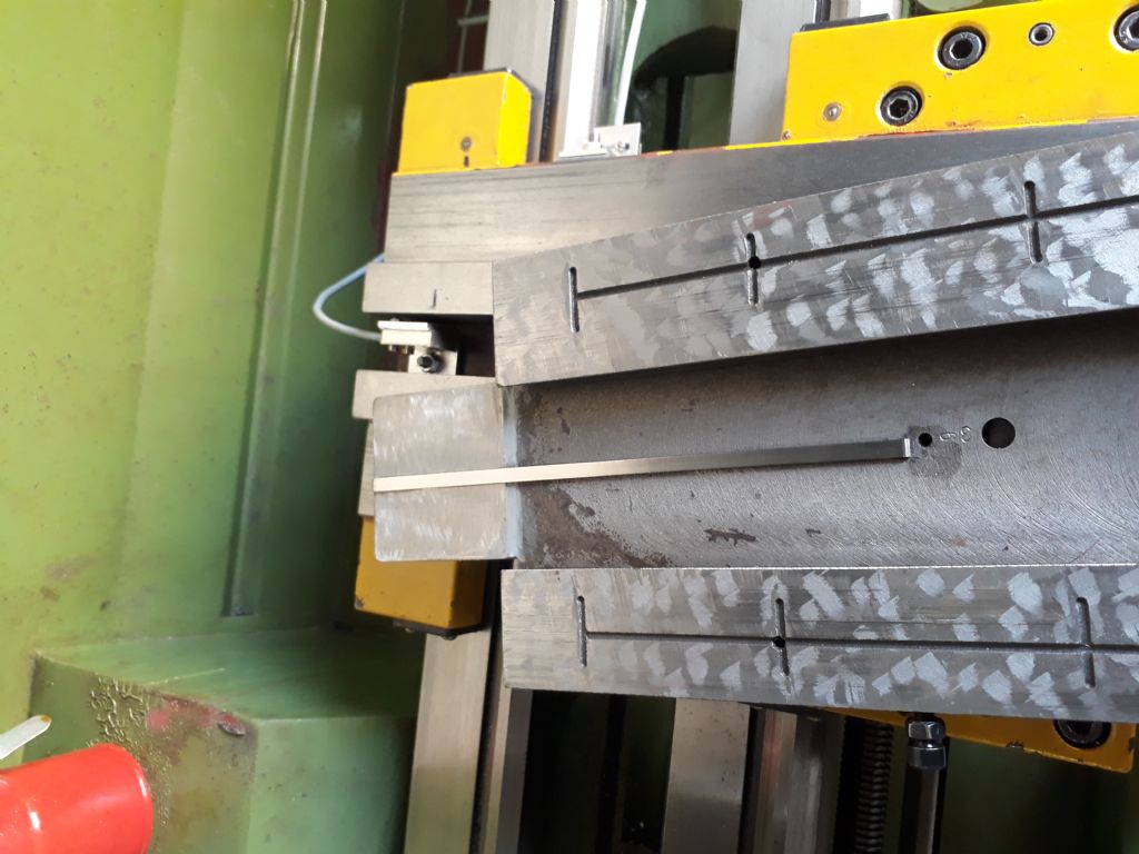

So the magnetic tape and reader assembly has arrived. I installed the magnetic tape to a piece of Ali extrusion that was double sided taped to the front of the S7 below the carriage, fitting inside the approximate 20mm gap. After getting it all connected and the carrier bracket secured off the thread dial indicator that I don't use, then the disappointment set in. The system I purchased is useless. A steel rule would be actually more accurate. In different places it gives different values. But does repeat very well, within around 0.02mm of the home position. I can wind the carriage along and zero in one direction. Move away and comeback and be within 0.02mm of the zeroed value. but moving say 2 turns and having the table move 6.35mm, the readout can show anywhere from 5.mm to 7mm.
So now I am looking for a skinny dro system that will fit in the area where I had the magnetic one and write this one off to Don't always trust the reviews provided by the sellers of these things.
In my Album is the pics of the error in reading at different places on the scale. Here is the installation pics.

I made a long holder that over lays each extrusion piece. The vertical plane is within 0.03mm the accuracy of the extrusion . The gap is very close, so that may be the source of error. I am not sure. The puzzle is the accurate 9.52 mm pitching in two different regions of the setup. I can modify the holder to increase the gap. But current gap is 0.2mm . I will try the other sensor with a different gap amount and see what the results are.
As you can see the reading of 9.51mm is quite accurate as the dial is about a 1/2 division short of the full 3 turns of the pitch.
I found a Newall option that is looking very good, but is beyond my current budget for this project. But it maybe that I just have to dig deep and make it happen.

Is there a way you can calibrate the reader? I built my own magnetic dro read heads from scratch using components from RLS and an interface from Yury. The interface lets you calibrate the reading against a known dimension such as a 123 block or gauge blocks. Is there any such function in yours?

Something is very wrong here.
I would say right off the bat, that the outrigger support cantilevered from the thread dial indicator stud is so flimsy that you cannot hope to get meaningful readings. It's susceptible to drag from the cable and friction from the shield all amplified by the twisting of the long cantilevered anluminium angle with a single point of location at the top.
Try remounting the head directly to the apron casting. Also, Get some of M-DRO's aluminium sopport extrusion and screw it to the bed at 150mm/6" intervals, like it's designed to be. When doing that, use shims, to ensute that the clearance is constant.
You don't say who supplied the head and the tape, but I've found the M-DRO tape and 1µm magnetic heads to be excellent, when properly mounted. Below is the Y axix on my mill:-

Could the heads be bumping or binding with the scale due to a misalignment? Odd results when scales are moved by a head touching them, or maybe something else moves the scale when the head is moved.

It came from Aliexpress. The bracket was I thought an issue, so I added a dti to watch the movement of the read head. It was less than 0.01mm as it was just the cable drag. No mater how it was retained, it was junk. I could try an MDRO system, but it needs to be front mounted so that I can still use the taper turning attachment. The tape has a 3m logo all over it. The exercise I thought was interesting and if viable was going to make a more rigid and better secured mount for the read head. I also thought that the double sided tape holding the extrusion holding the tape was the issue. But I could not measure any movement of that extrusion. I remeasured the extrusion and it was actually imperial extrusion , 5/8x7/8 with a metric 1.5mm wall. So an odd extrusion for sure. So when the holder was fitted into the extrusion with the read head, that width was 18mm so had 0.5mm gap from the fully closed position, and was 0.1mm in the vertical position clearance, leaving 0.2mm clearance between the read head and the stainless steel protective strip. So the max gap on My S7 is actually only 19mm wide by the halfnut mechanism in the carriage.
The magnetic system that people have shown has been very encouraging and it would be foolish to write it off already. I will look at the options again with new eyes and see where I end up with it.
