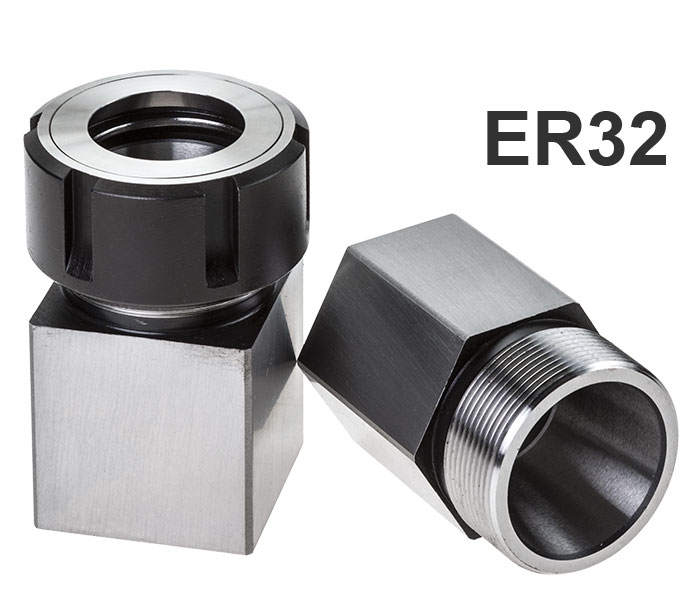

DC31K also mentioned Stevenson's ER Collet Blocks available square or hexagonal.
You could make your own round version and hold it in a 4-jaw. No need for the MT taper or a drawbar, a large diameter shank will be gripped well enough to mill on a lathe, even without flats. Less metal and much easier to make.
