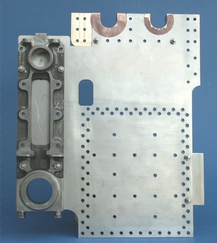

Just read the garbage about NOT chaining dimensions. RUBBISH. Even our lowly toys refute that. Try using a common datum when trying to locate a cylinder with eight mounting holes and forget all your fancy measuring systems. One hole is datum and the rest are chained from it. Straight line dimensions would work but what about an angled cylinder?
Try the one datum rule on tooling to produce more than a thousand holes in a printed circuit board with metric AND imperial pitched components.
Regards Ian.

Unchained dimensions are far more useful these days with the vast majority having a DRO on their mill which makes it easy to work from a datum be that a corner or ctr of a part.
Centred pairs or hole son a PCD are easily handles with the absolute and incremental settings by using absolute to get the ctr of the pair or group and then incremental from there.
Those still marking out by hand and using handwheels are better off dimensioning from a corner datum so all positions are positive so less faffing about allowing for backlash if a ctr datum is used.
I'd happily do the 1000 holes from one datum with the DRO on the manual mill or better still the CNC which only needs the one datum. This is probably about the most I have done from one point, a lot easier than all the chained fractional inches that were on the drawing.
