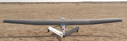

Joseph Noci 117/01/2022 14:15:27
1323 forum posts
1431 photos
+1 for ZAP epoxies - I use it extensively building these...Works very well
